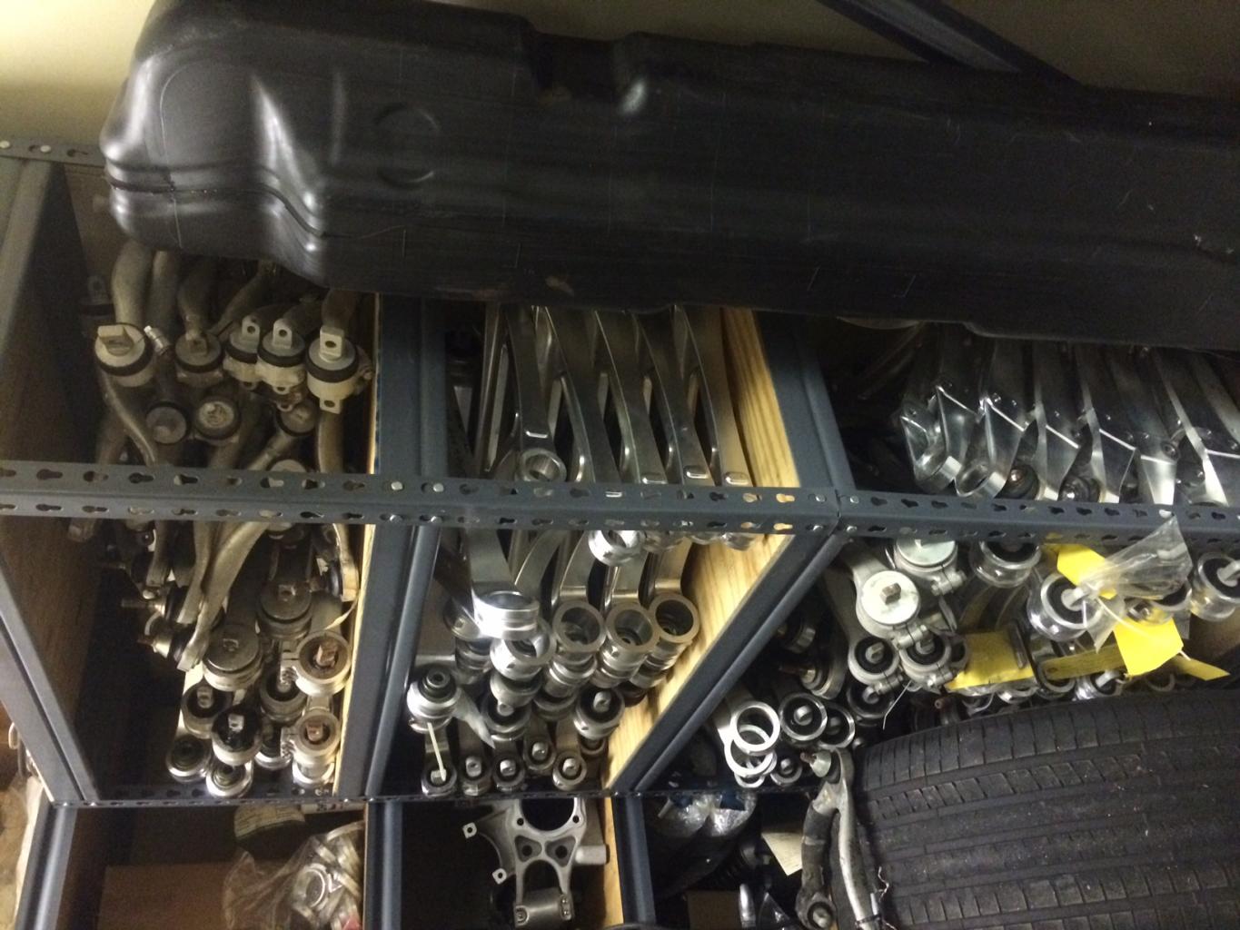

There is some carry over parts but very few...brakes, bearings, some upright/suspension components

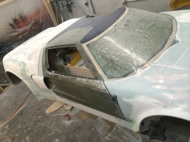

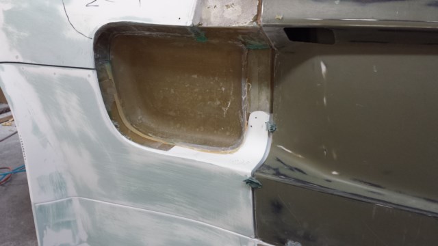

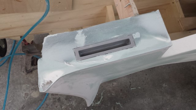

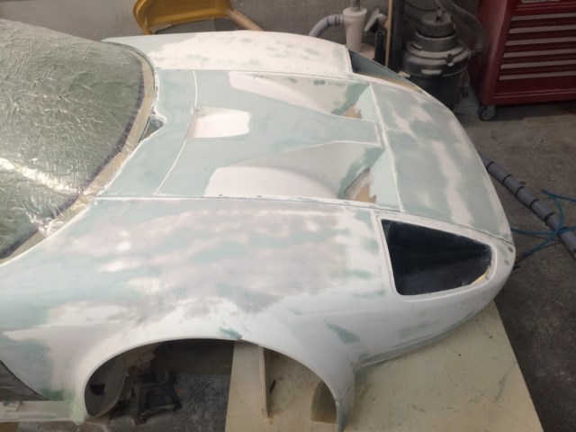

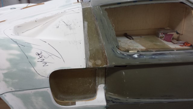

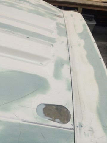

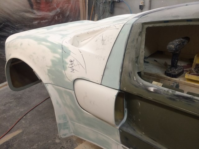

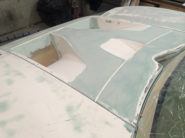

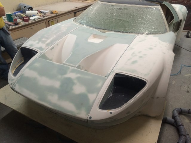

Here are pictures of the heavily refined body prior to moulding from a few weeks ago.
The body gaps are far superior to an OEM GT , all of the body panels align with moulded alignment tabs and receivers.
The surface finish on the panels is even better than the SLC.
All the attachment points for the body to body and body to chassis are premoulded into the parts.
All the aerocatch latch locations and receivers are also premoulded.
This level of detail and refinement has taken a long time to put into place as the race car body, whilst good for a race car that's get painted , it wouldn't cut it in a gelcoat finish in the retail world....but it will now.
