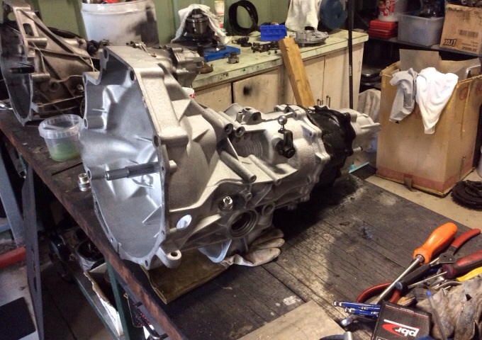

I got the 944 input shaft back from the Machine shop today. New spline and pilot bearing machining done.
Assembled the box for test fitting, need to do a few more mods to bell housing. All looking good.

nice work Dave, I am using an Audi V8. From the photos the 944 should bolt right up to the Audi V8. Even the starter recess is clocked for the Audi V8. Currently I have a Boxster S 6 speed transaxle. It also bolts directly to the Audi V8 except the starter recess is at 12 o'clock. I thought of notching the Boxster belhousing to clear the starter but the 944 is already in the right place for the Audi starter. Besides the 944T trans has better gears.
let us know how it goes.

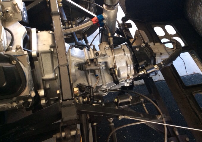

Keith it's a very easy mod to convert a 944 box for conventional use. Machine the inputshaft to 016 specs, machine a sleeve for the clutchfork to slide on...a few other things and you are done. My modified box is in the car and waiting for me to get the motor going...i will update the thread soon.
Here's the 944 box sitting in the frame....Tested clutch operation and all is good, this box has LSD 60deg, 3.375 final.

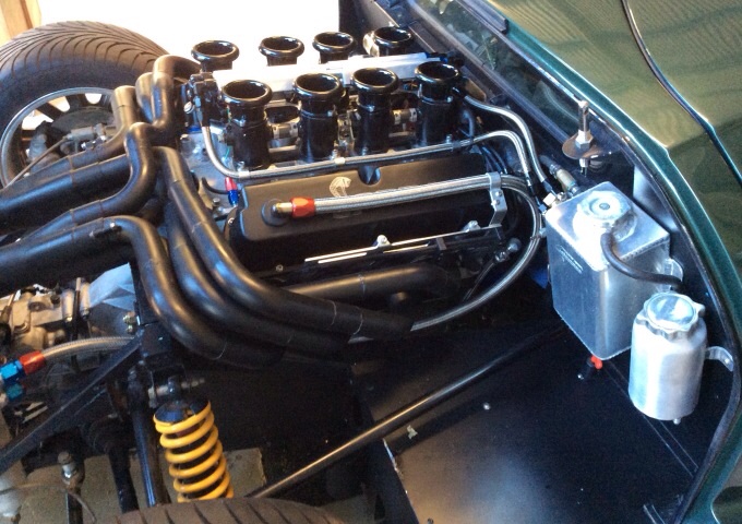

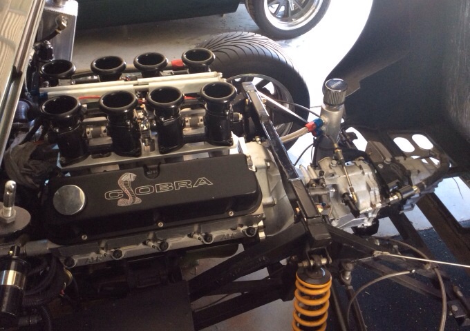

New exhaust is on. Just a bit of wiring now and the engine should start.....hopefully...
Looking very good Dave! I wished I had thought of machining the input shaft for the 944 box to take a pilot bearing.. I let a couple of these boxes go very cheap as spares for a 944 racecar project that never fully matured.. They'd be worth 10 fold if I had made those mods.. On well... They are a really good gearbox and should serve you well if you behave! :) and keep the fluid changed / cool...
Sounded pretty healthy from what we heard... Make sure you make some sort of heat deflector for the tailpipes so as to not cook the clip!
