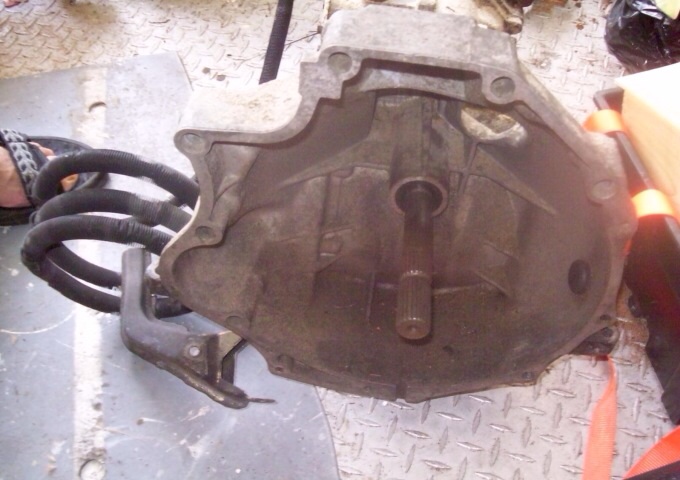

944 Transaxle fitment.
Today i got a hold of a 944 Bell housing to experiment with. As most of you will know these gearboxes are not set up for conventional clutch arrangements.
Firstly I made sure the bell housing bolted up to my KEP adapter which it does apart from one hole which can be drilled and tapped. I then mounted the adapter plate , flywheel and clutch to my motor and all cleared fine, even the dowels are correct.
I started with machining an alloy dummy input shaft to the 016 spline and Spigot bearing, I will needto get the 944 input shaft machined to these specs.

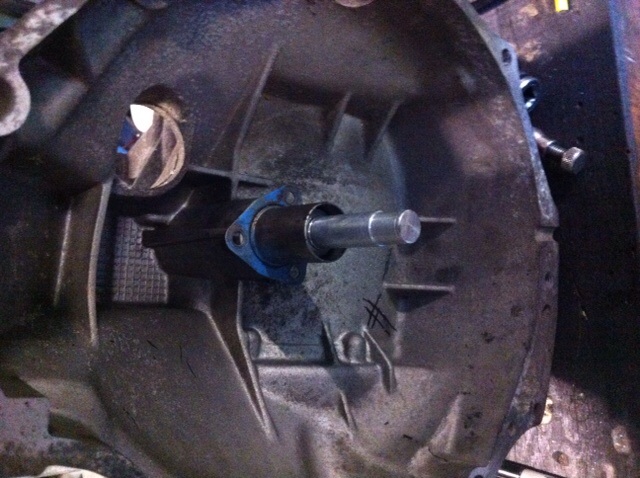

Next was to get a clutch fork working. I found that the 01E steel thrust bearing slider cylinder fits to the 944 bell but I need to weld some lugs to secure it properly. Then i drilled the housing to fit a pivot ball for the clutch fork. All seems to fit ok and matches the 016 set up. Next I have fab a bracket to mount a slave cylinder and job done.
01E thrust bearing slider / guide fits 944 housing. Needs lugs welded on and tapped to secure properly.

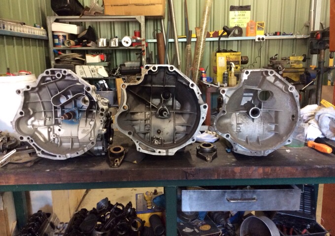

also here isa pic with from left to right an 01E , 016 and 944
all very similar and all bolt up to the KEP adapterplate.

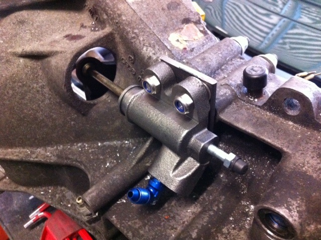

Here is the 944 box looking very 016. 944 test box is bolted in car, just need to mount slave cylinder and tested for operation then concept is proven and i can get parts cnc machined for real box

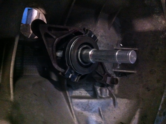

Ok. Clutch slave sorted. Just need to bleed up and test. All looks like it will work.
So there you have it a 944 box converted for normal operation.
*****UPDATE- Hydraulic testing done, clutch works perfecly***
All i need to do now is get my real box carry out same mods. I will do a picture by picture strip of the 944 box and how to measure input shaft for resplining and shortening....

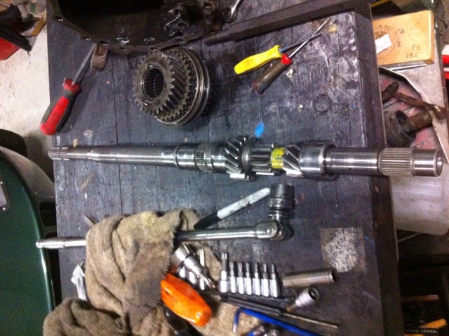

Gearbox finally turned up, Stripped it down, the box is a bit tired and looks to needing a few bearings. I am planning a 2 stage build, 1st to get shaft machined and reassemble box as is then test all is ok in car and if concept works. If that works fine then strip box later and carry out full rebuild. Off to the machine shop for re-splining tomorrow, that is hard part.
It takes a lot of machining to use the 016 housing, plus you need to redo all preloads as the cast steel housing is shorter on the 944 and needs a 3.7mm spacer plate, Its not an easy swap. also i have a perfectly good 016 that i want to keep for later. My mod means you don't need to have 2 gearboxes. You can buy a 944 box and work with it. I dropped the input shaft off at the machine shop so in a weeks time hopefully I will have a shaft.
Sorry just reread your post - reason is the ring and pinion does not fit in the 016 housing. the crown gear is to big, 016 housing requires boring out. The pinion does not fit in the 016 steel housing as the bearings are bigger on the 944 so the 016 housing would need boring to suit. also the 944 shafts are little longer than the 016......it' a mine field really. so I chose to keep the 944 box together , no hassels with preloads and spacers, boring. Just strip your 944 ,get your input shaft out and machine nose and you are done....
