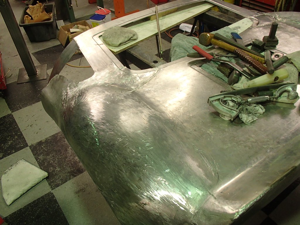

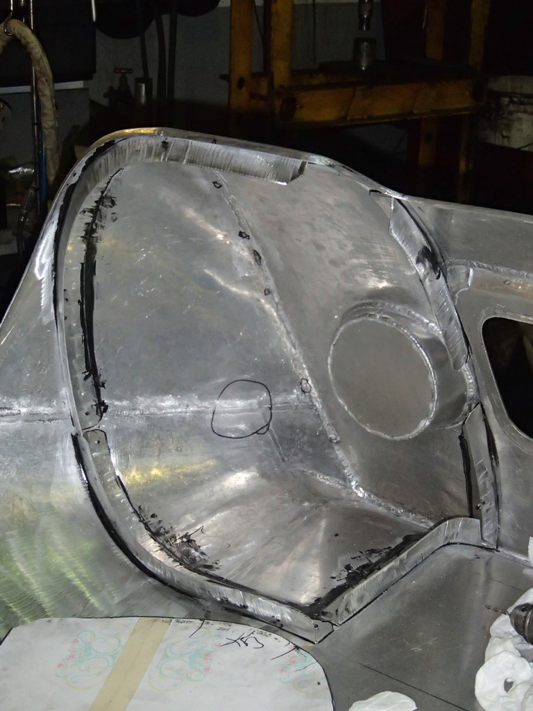

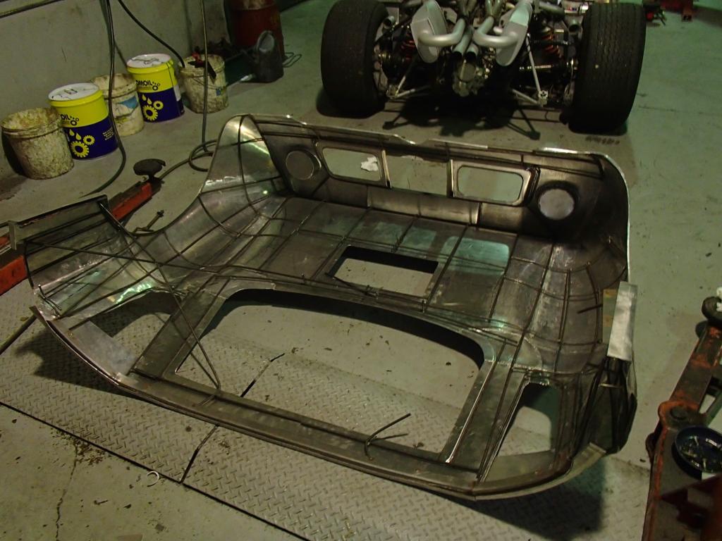

1st pic is the rear shell with the wire form still inside.
This was just before I cut it out with bolt cutters.
2nd 3rd is the shell with all the welds still exposed.

The welds are filed back, bumping up all the lows and srinking down the highs to get a file finish.
Yes I will use some fillers in areas because I cant warrant the time and to go to the enth degree in some areas.

for someone who does not know what there doing you are doing
a fantastic job i have enough trouble bending alloy in a bender
but to take a flat sheet of alloy and put compound curves and
returns and recesses shows how clever you are keep the photos
coming what would the weight of the rear clip be jim?
chris

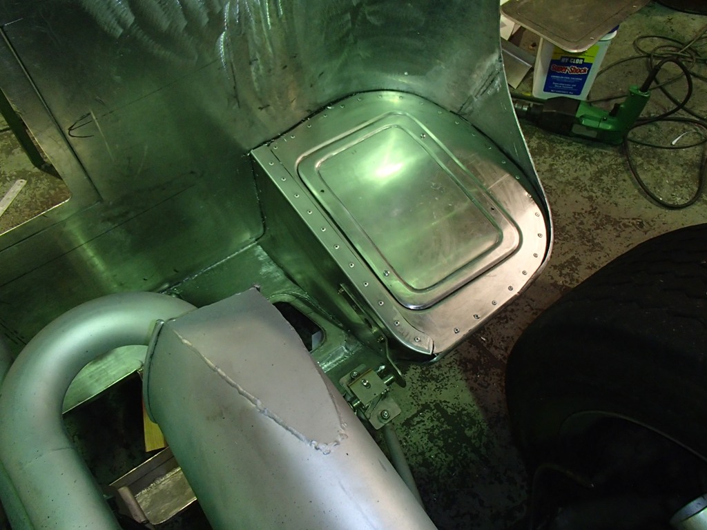

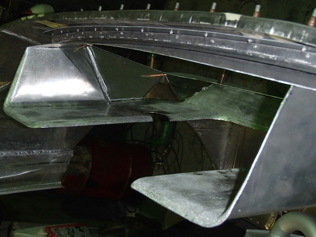

I had to mount the rear clip to sort out the body gaps so I had to make the rear light boxes.
This was the sollution after trying a few experiments.
The flanges I use a shrinker stretcher to get the shape very close to the body shape.
These are bonded in, I use a counter sunk rivet at the begining and end of each bracket for shear.
These rivets are on the outer skin and will be filled.
The box skins are bonded to the brackets as well as riveted.
pic 1 brackets.
2 dummy up face sheets.
3 is fiberglass tools boxes that I used in the other body, I use them on a long trip.
Chris 13.5 kg at the moment and I am expecting 20-22 fitted with poly back window.
The glass clip was 55kg fitted up with a glass rear window.
I have tortured myself with this Chris but I will win.

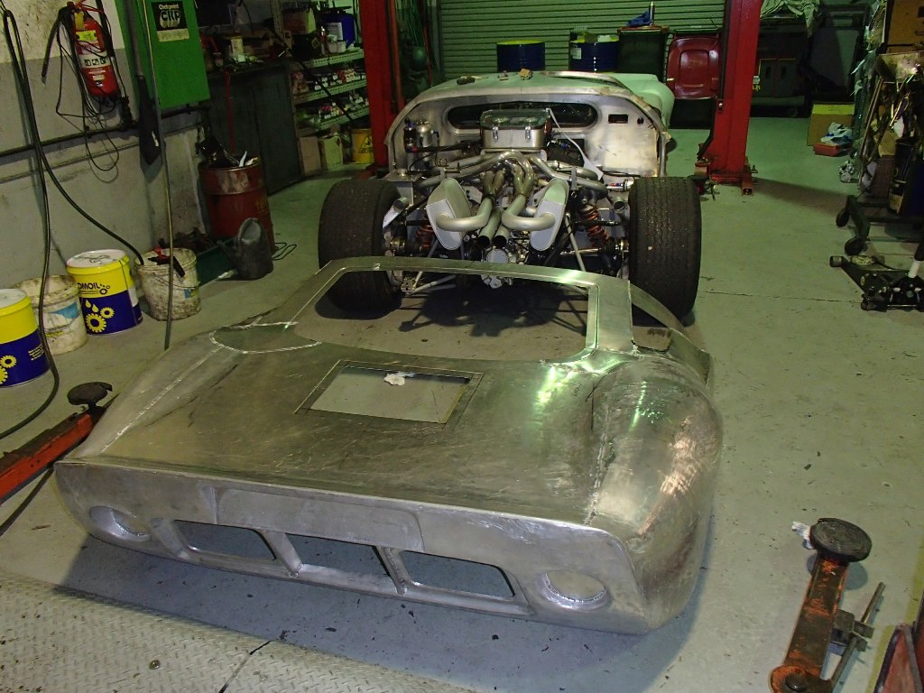

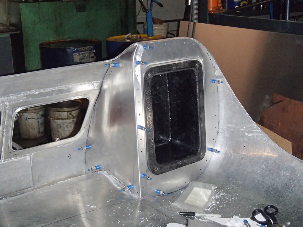

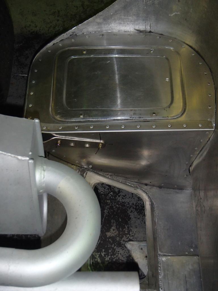

This is the light boxes fitted up and hinges mounted for the rear clip.
I mad the lids with a raised perimeter for a rubber seal to sit in and the box is nutserted for the 4 screws.
The clip is on the car and I have to sort out some body gap issues, its all fixable but it is the price for moving to fast.
The gap across the roof is bang on and that is all I need, the others are an easy fix but the gap that meets the roof would have been a mission if I had f**ked that up.
Rule # 1 finish as you go.
Rule # 2 finish as you go.

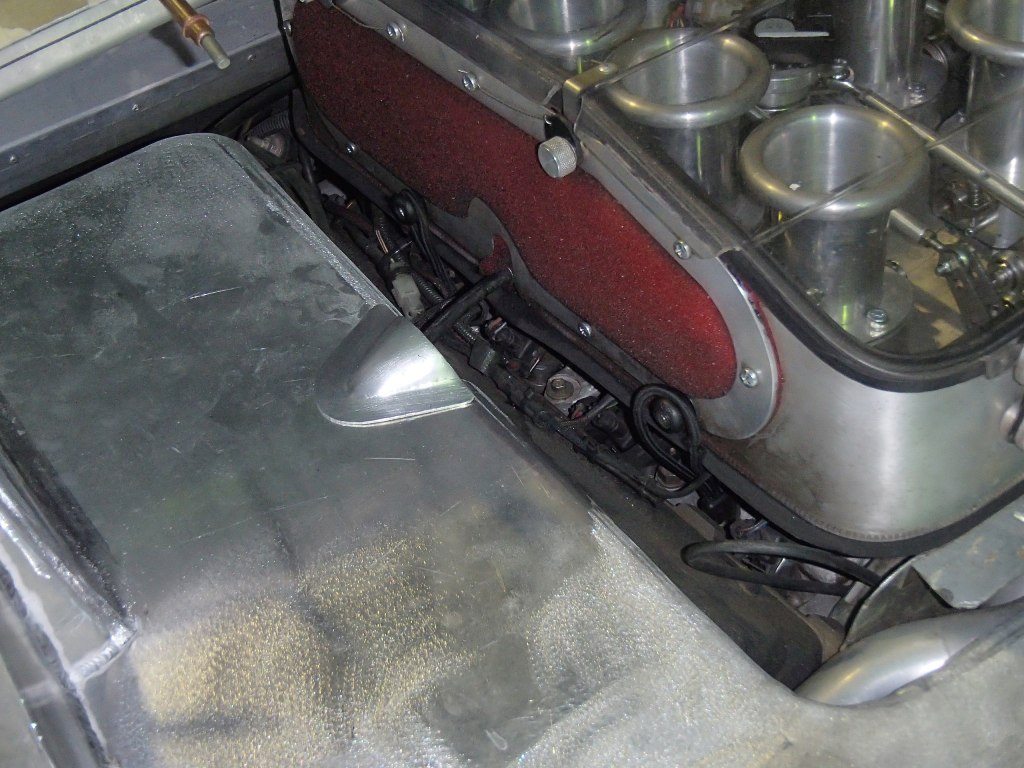

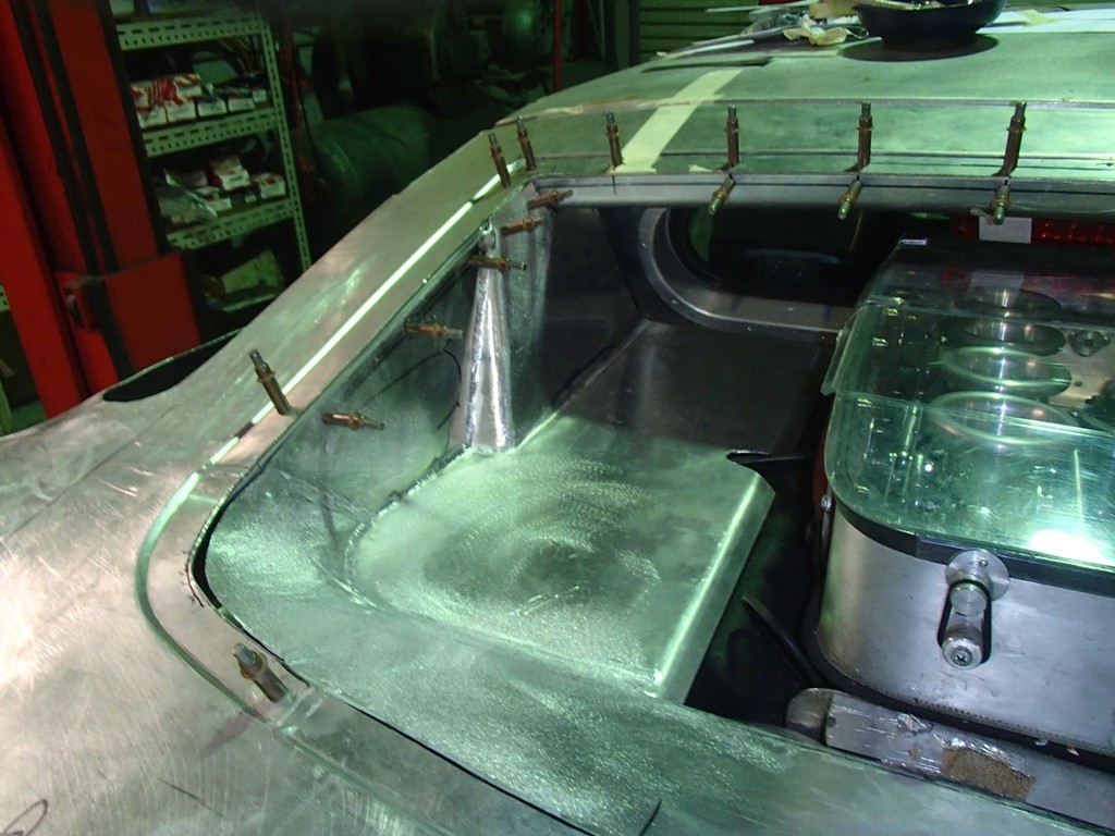

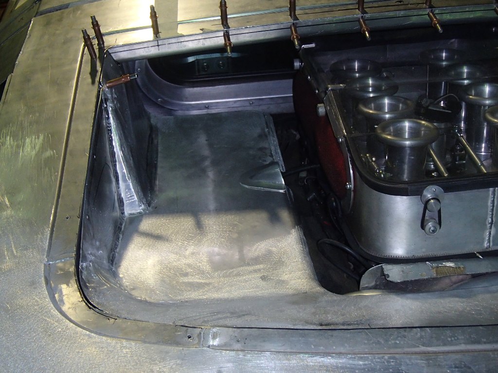

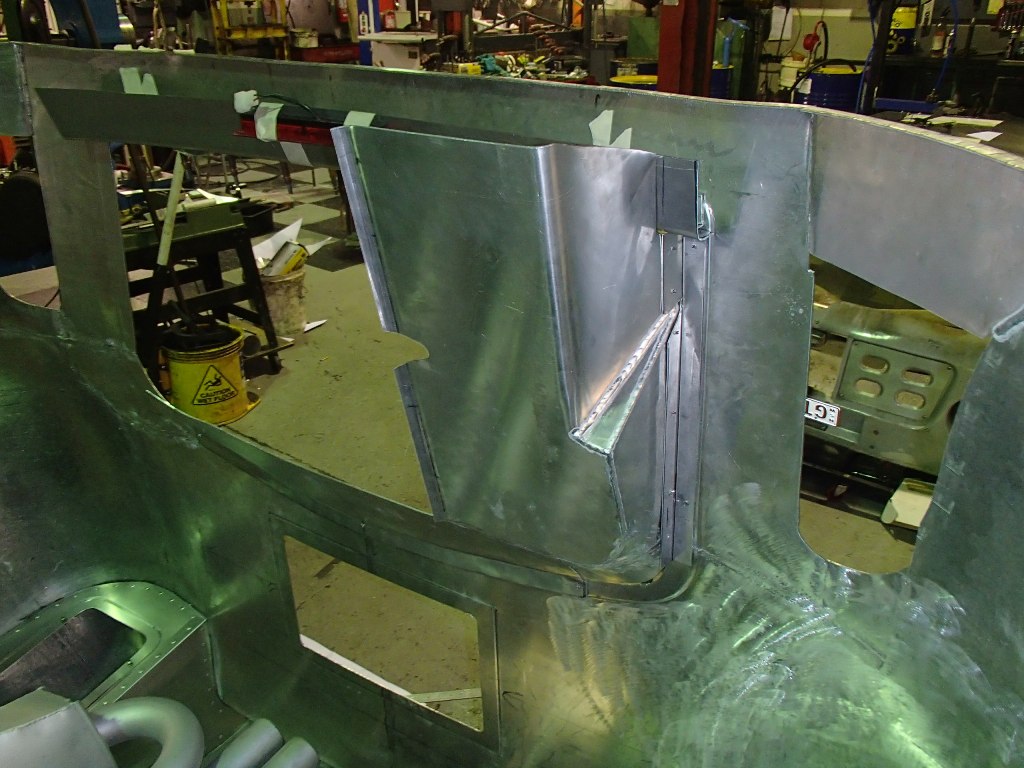

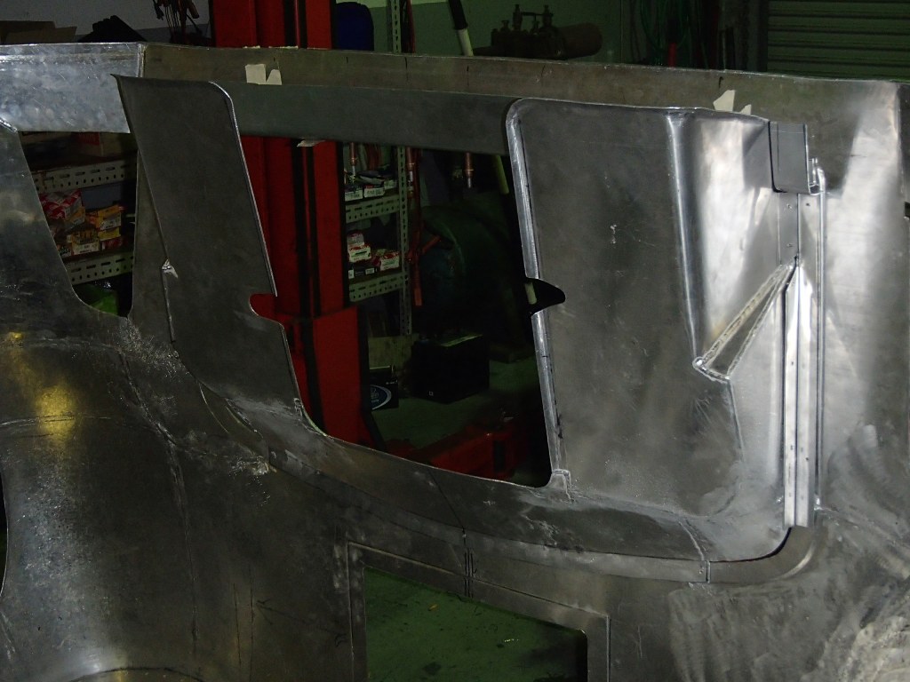

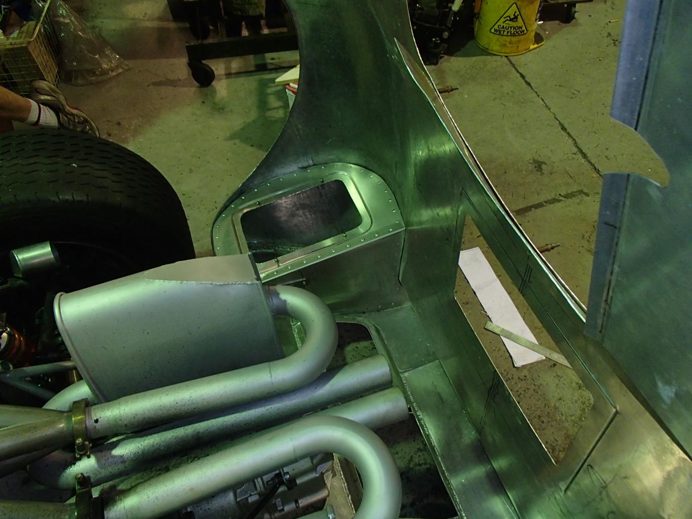

I have been working in the rear window area under the screen.
I have to do this because when all the panels are fitted they will hold the shape where the roof and the clip meet.
After this I plan on moving down the sides.
pic 1 is the general idea, I have tried to copy what I had except for the panel at the rear under the window above the collectors.
I run a modular eng and they are tall and I had to cut away some of the f/glass because it was that close on the original clip.
On this one I changed the shape to get the floor closer to the air box.
I had to clear some mechanical components so cut outs had to be put into the sheet.
A nice little cover will be made for both sides, plus the floor line looks less disrupted with the bubble.

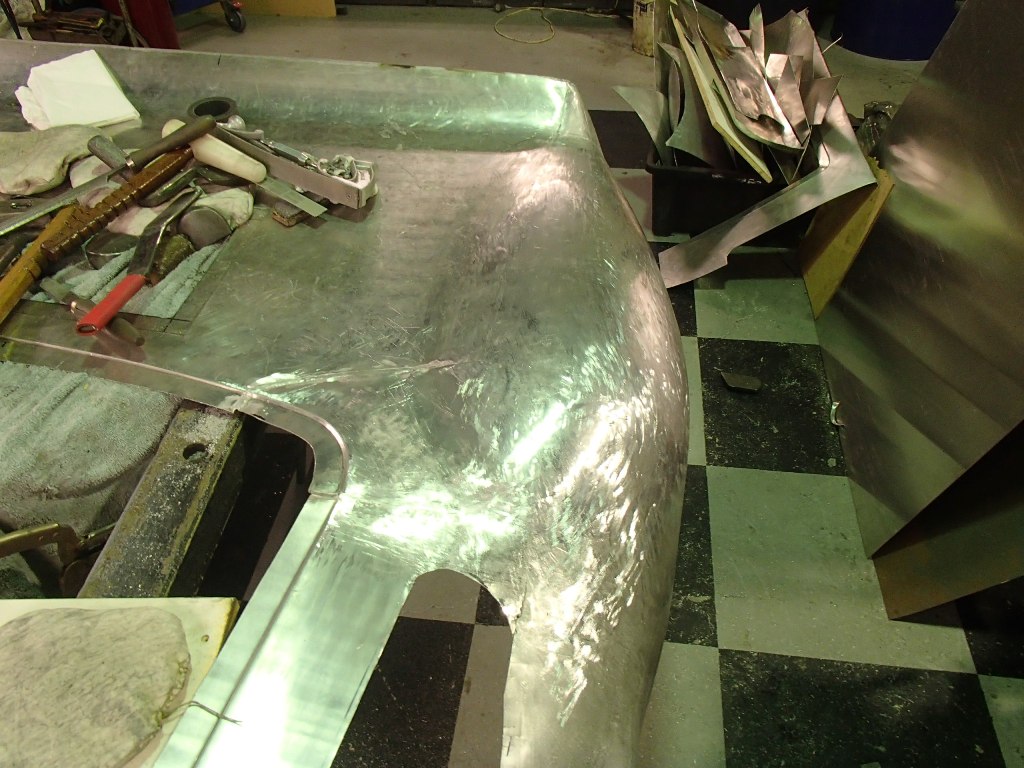

Pic 1 building the L/H side
2 is both sides
3 I radiused all the edges of the sheets to add stiffness.
I still have to do a bit of finish off in the flanges and trimming off areas before bonding it all in.

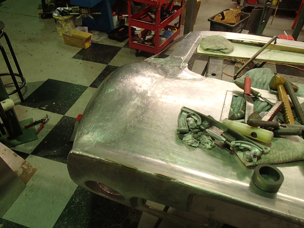

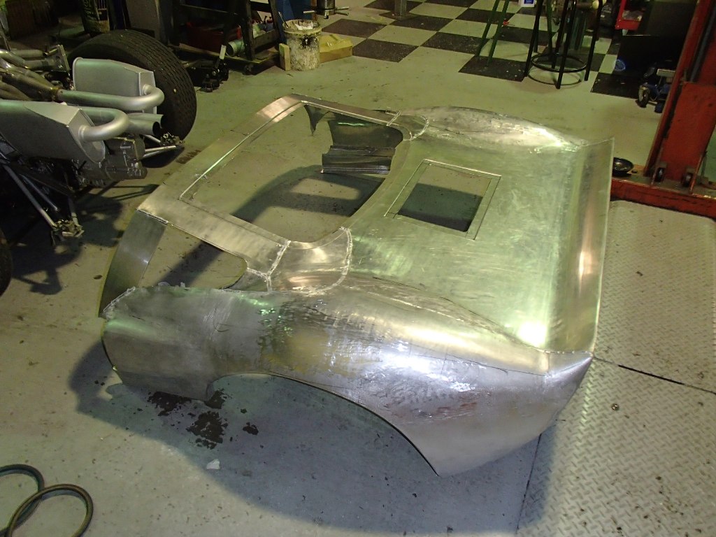

jim is the alloy normal grade i have heard you can anneal it by
oxy and acetlyne and does it work harden like s/steel
chris
Yes it gets harder the more you work it.
The R/H gaurd is the only part I have anealed so far, only because I tortured it by trying to get it into shape.
You soot it with acetlyene first then heat it with the torch.
When the black is gone it is anealed this is maybe 500-550c I would think.it will melt at 650c.
If you over work it and it is stretched you can shrink it as well. if you soot then say # 6 or 8 tip on a neutral flame you apply the heat to the stretched area ,when the soot is gone you hit it with a spray of water from a spray bottle.
You do curcular areas and it will pull down.
If you stretch to far you generally get panel pop when you push on it, you have to much metal and if it is in the middle of a panel it will be trapped by the surrounding metal and shrinking will fix it.
The alloy is 1.6mm 5005 grade.
The biggest issue with a 40 is the shape, it has changing curves and you have to read it or you will cock up real quick.
EG On the rear gaurd you have the compound shape of the top of the hip , as the shape travels into the deck area where the vent lives you go from compound convex to concave ,if you work the convex with a tool to stretch it will come up but it will make the concave go down.
When these areas are right next to each other in the shape you have to be carfull or you can change the shape in an area you dont want to change.

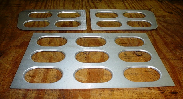

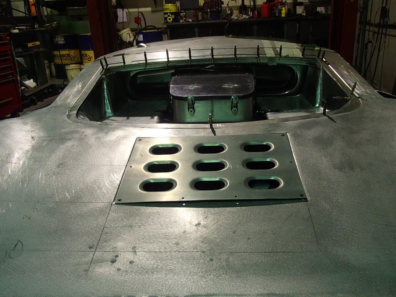

hello jim i was wondering with the inner panels that you put
under rear clip to stop flex and twist will they be welded in or
bonded and another thought with the rear vents on top and
at the back seeing how you are allready alluminium could you
press the nine holes into body as is that way you could give
your alloy vents away to a person in need like meeeeeee.
