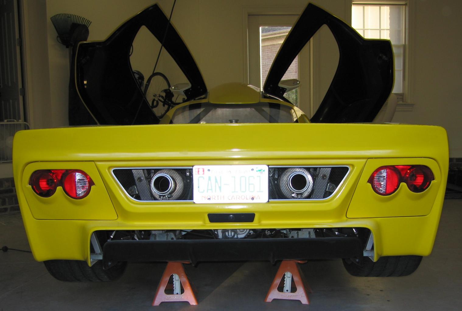

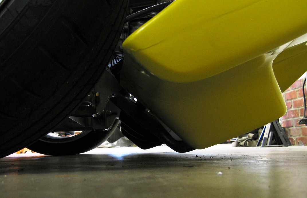

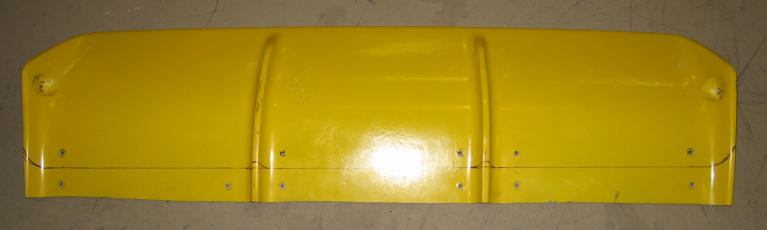

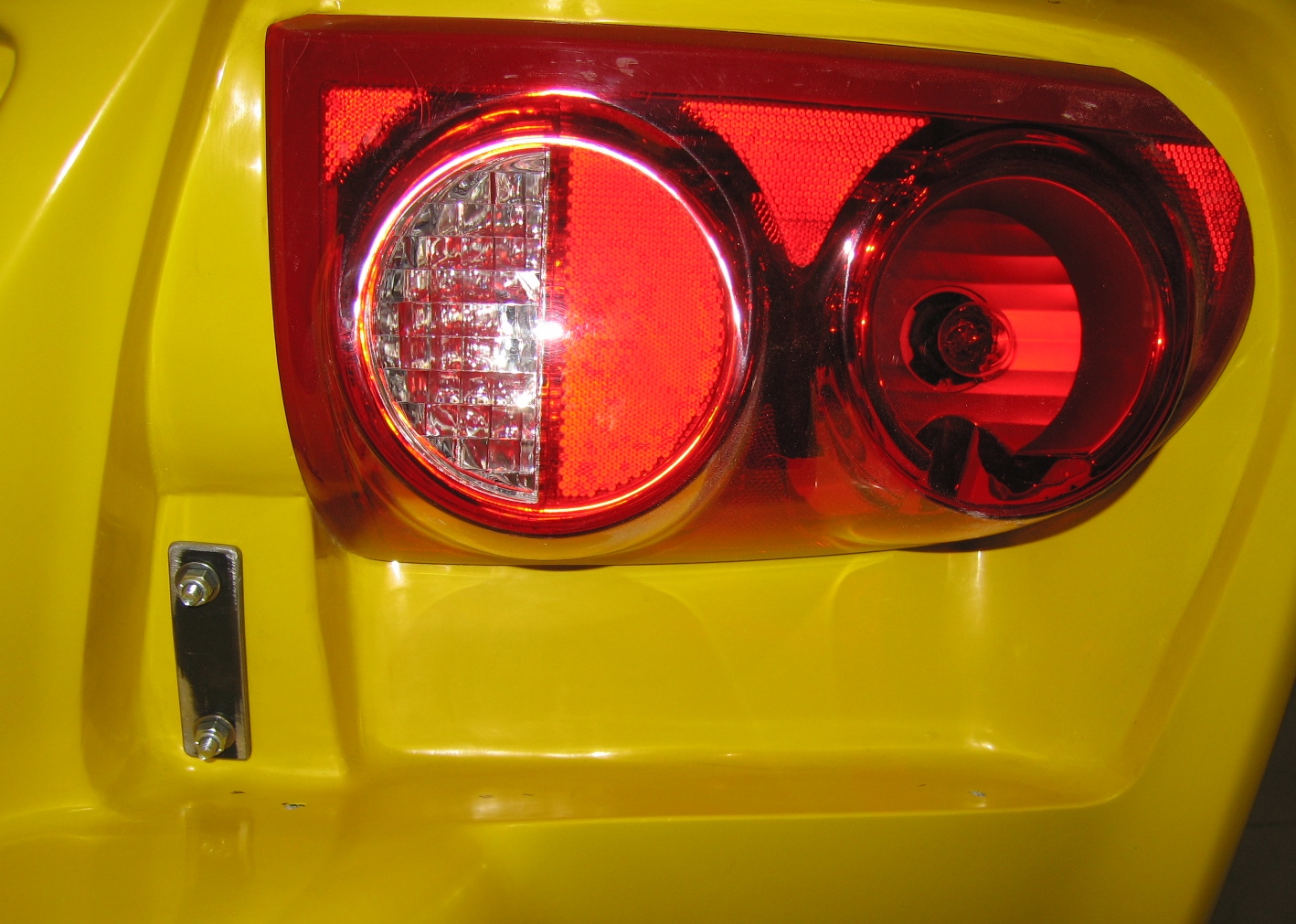

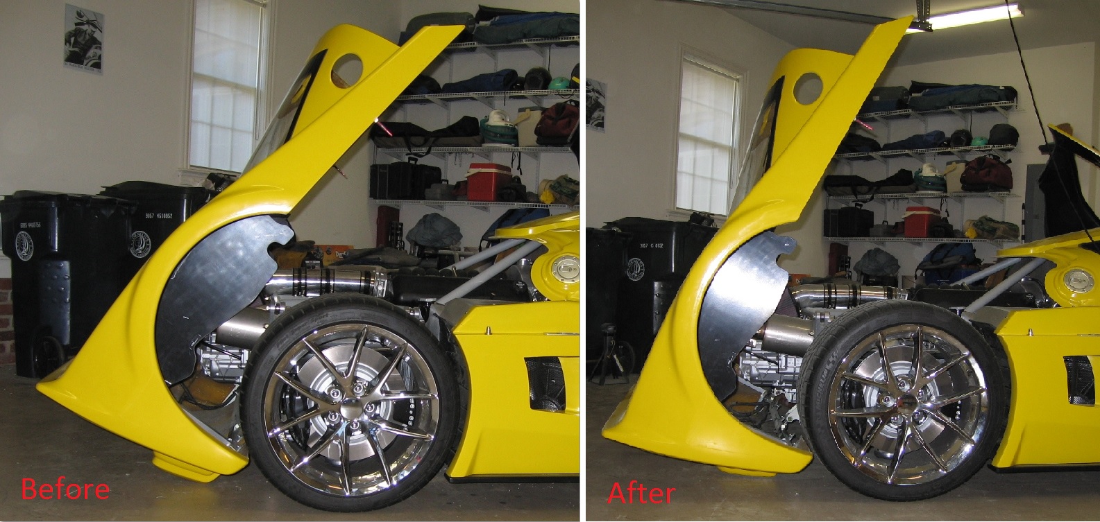

I chose the street tail over the race tail because I thought it gave the rear end a more finished look. However, there were always a few things that bothered me about the street tail:
  • Aesthetically, I thought the bumper and diffuser stuck out too far.
  • The bumper/diffuser protrusion hits the ground when the rear clam is opened.
  • In a car like the SLC where the chassis and body is all business, the bumper/diffuser seemed like a styling exercise with little other function than to cover the rear mechanicals.
  • The diffuser cups back under the engine compartment and blocks the aft portion of the transaxle and makes access difficult for maintenance, shift rod adjustment, etc.
  • There are lots of scoops to bring air into the engine compartment, but only 2 small grills in the back for the air to exit.

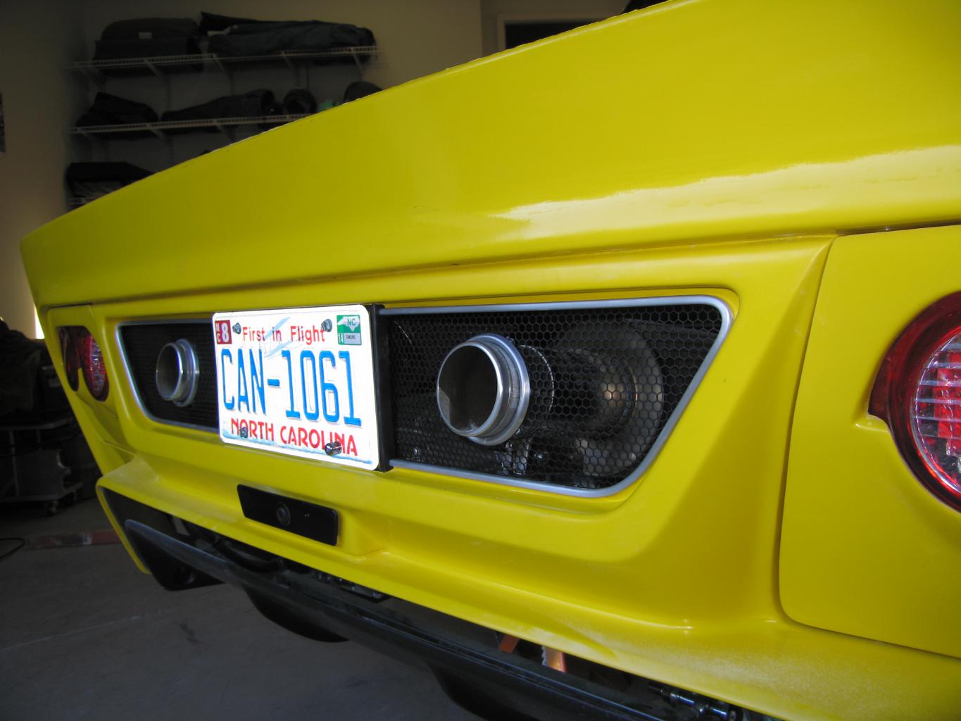

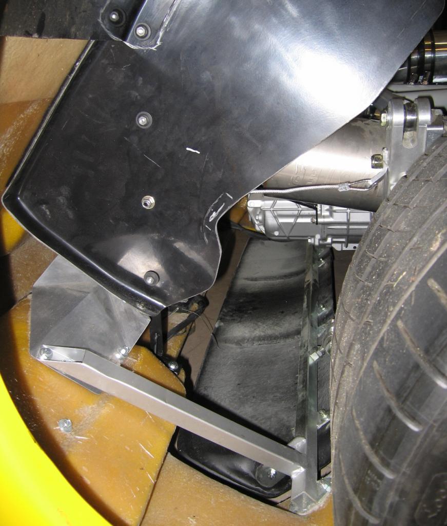

So I got a wild hair, grabbed my jig saw and went medieval on the rear clam bodywork. I cut the “U” shaped bumper out and recessed the diffuser about 2” further forward. If you have already mounted the rear clam, you can simply reposition the rear most set of mounting holes into the forward row of mounts. Then just trim 2” off the forward edge of the diffuser.
The result nearly doubles the exit vents in the rear and the diffuser is now a removable panel for easy access to the rear of the transaxle. The rear clam opens much further, so I added a retainer strap to keep the tail from hitting the ground when open.

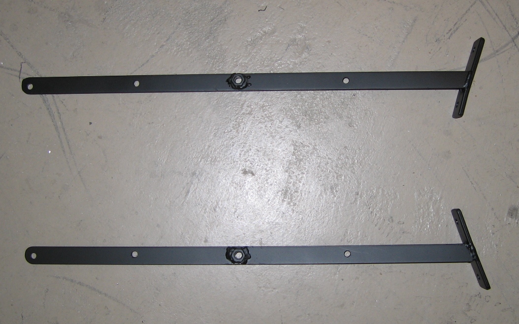

The diffuser/bumper provided some structural strength to the rear clam, so I added 2 braces. Both braces attach to the back of the tail light bucket, so it its hidden and can be retrofitted to a finished car.
  1. A while back I added a brace from the pivot bracket to the back of the tail light bucket.

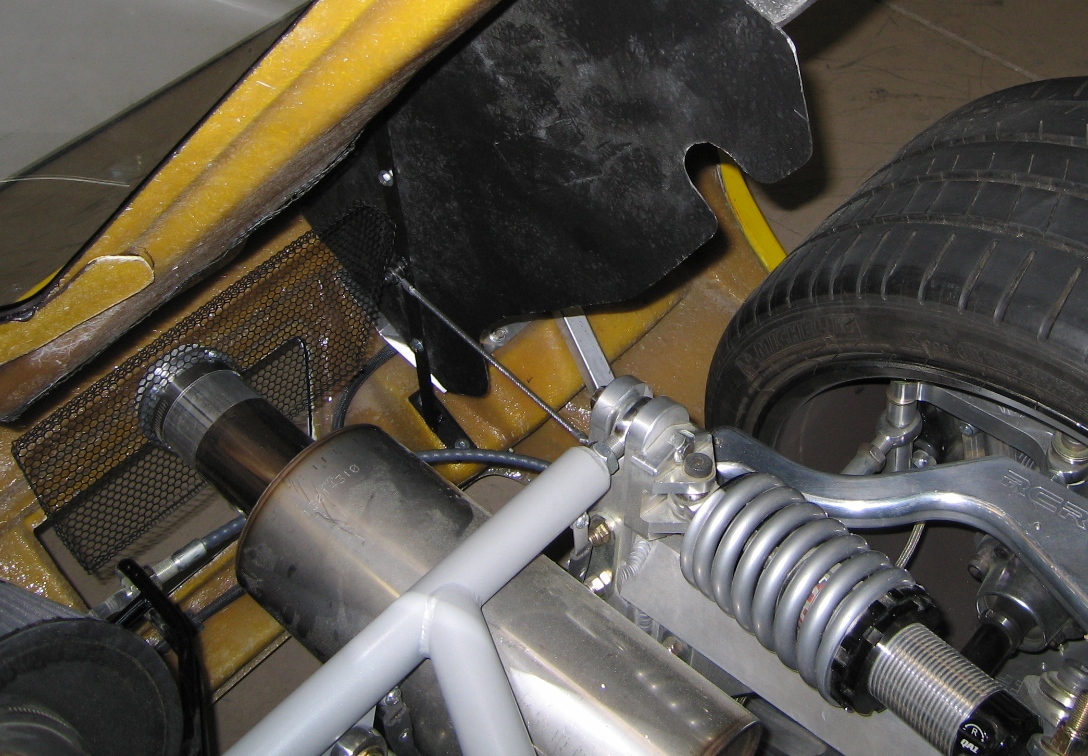

  2. The inner wheel well panels are really made for the race tail, and do not extend all the way to the back of the rear clam. So I fabricated a brace to “Mind the Gap”. The brace also has a retainer strap to keep the tail from hitting the ground when open.
The rear clam is stiff and has minimal flex so you can open it from one side.

Bill,
you are quite right
The street tail was designed to meet and conform with overseas compliance issues.
Some of which require that the tires are not visible from the rear.
The diffuser is indeed to cover all the mechanicals , again to meet ADR and IVA requirements overseas.
The street tail does make the mounting of the taillights much easier than the race tail though...so there are many advantages to it over the race tail for a street car...
There are some new 'gooseneck" mounts in the works that will allow the tail to open further without touching the ground too btw.
Fran,
I would be interested in the new 'gooseneck" mounts when ready.
Just to be clear, I do like the street tail, that's why I chose it.
I just wanted to put my mark on it.:chug:

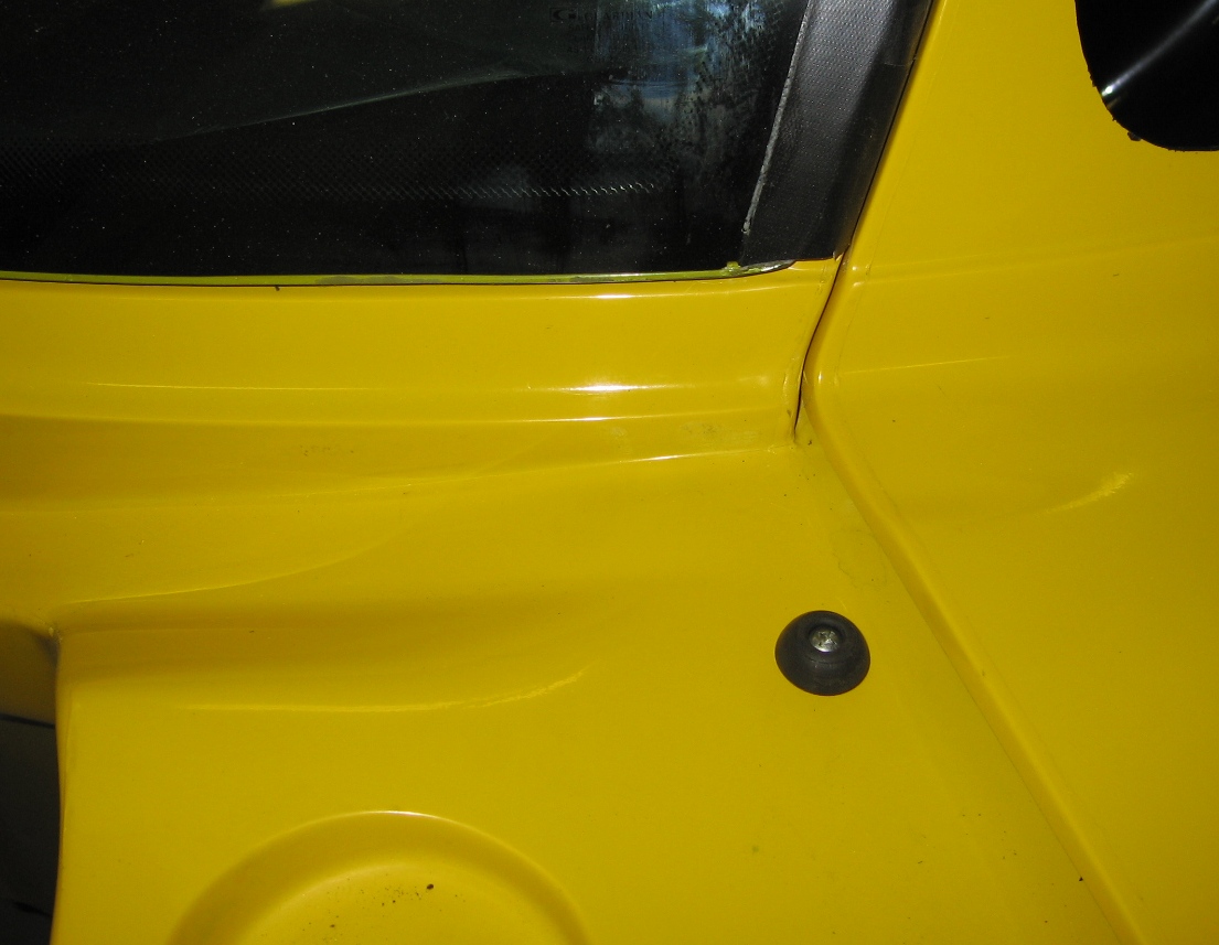

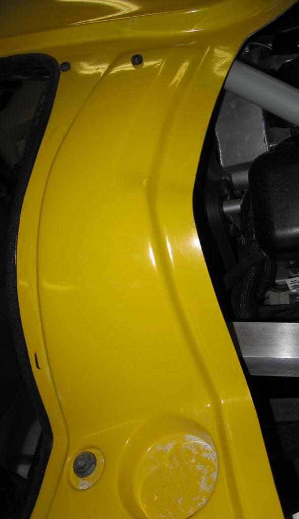

I’m getting close to sending my SLC off for final paint, so I’m focusing on a few prep details. Nothing will mar a pristine paint job faster that body panels that rub each other. I carefully examined where the body panels contact each other and then used an orbital sander with coarse 80 grit paper to remove the fiberglass edges to improve the contour of the shape.
The panels that were rubbing each other were:
  • The back flange of the doors rubbing the spider
  • The rear clam at the fuel filler opening rubbing the spider
  • Driver’s side of front clam rubbing cowl on the spider
Then I installed 8 rubber bumpers to securely hold the body panels away from each other.
  • Top rear corner of each door (2x)
  • Top front corners of the rear clam (2x)
  • Disguised the spider’s rear mounting screws by a bumper with standoffs (2x)
  • Disguised the spider’s front mounting screws by a bumper with standoffs (2x)
It’s not very exciting stuff, but it has to be done before paint.

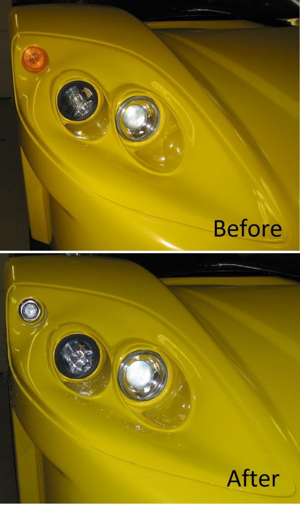

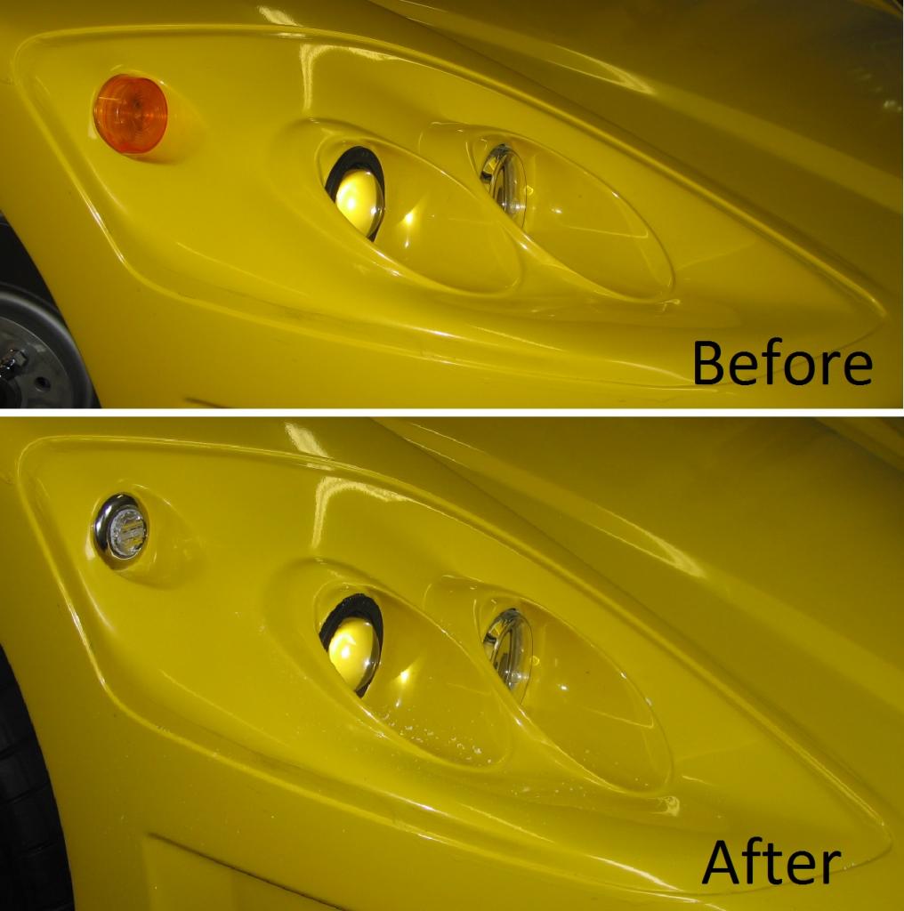

I replaced my front turn signals with a unit that has a stainless trim ring to give the front a more finished look.
Even though the LED lens is smaller, its actually brighter than the originals.

Bill - looks good. ya got a manuf. part# or source?
Is it a two wire or three wire light.
I bought them on ebay from Seller: randpcarriages. They were only about $30 with shipping.
It's a 2 wire connection like the originals. A while back I posted a simple circuit that allows you to connect the ISIS 3 wire harness to a 2 wire LED.
  • Maxxima M09400YCL Amber Clear 6 LED 1-1/4" Marker Light item: 290513858473 $20
  • Maxxima Stainless Steel Trim Ring Bezel LED Light Cover item: 291039607005 $5
