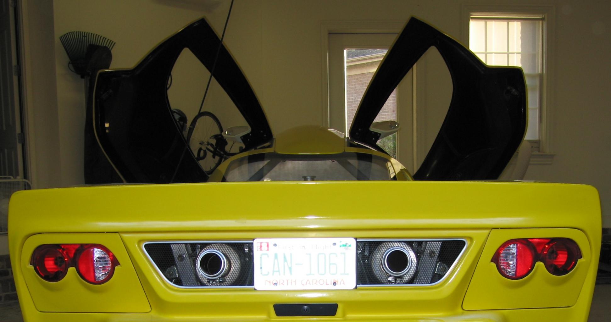

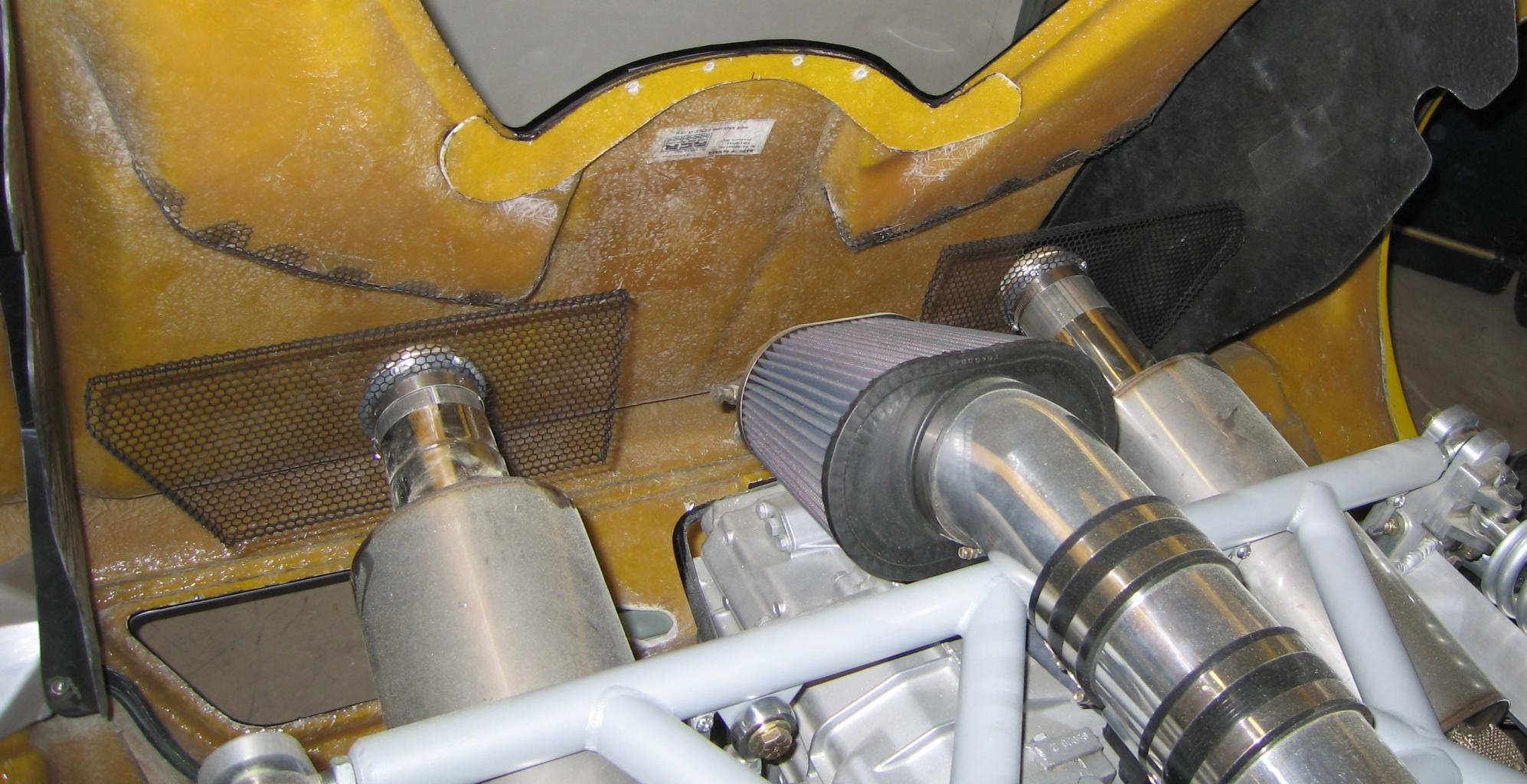

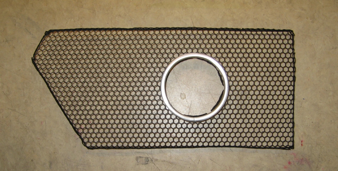

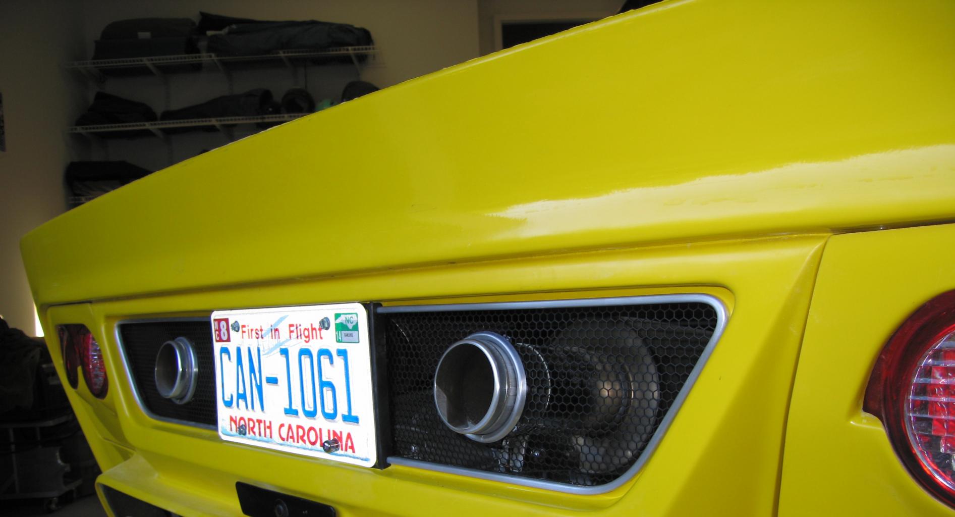

I put the finishing touches on the rear grill.
The angle that the rear clam closes makes it a challenging to build a grill around the stationary exhaust tips. If you attach the grill to the rear clam, the exhaust openings in the grill need to be slotted so the grill doesn't get caught as the clam is shut. The easy answer is to attach the grill to the exhaust instead.
I fabricated the grill from expanded aluminum mesh and rolled over the edges to give it more strength. I then fabricated 1/4" aluminum trim around the exhaust tips and attached it to the aluminum mesh with #4 screws. Then make pie cuts in the mesh to allow the exhaust to pass thru. A simple hose clamp attaches the grill pie cuts to the exhaust for a solid mount.
I used the same 1/4" aluminum trim to fabricate the grill surround trim as well.

Bill, That's a really clean looking job. I like the silver trim that you have around the border. Everything looks really good, back-up camera looks good were its mounted too. SWEET

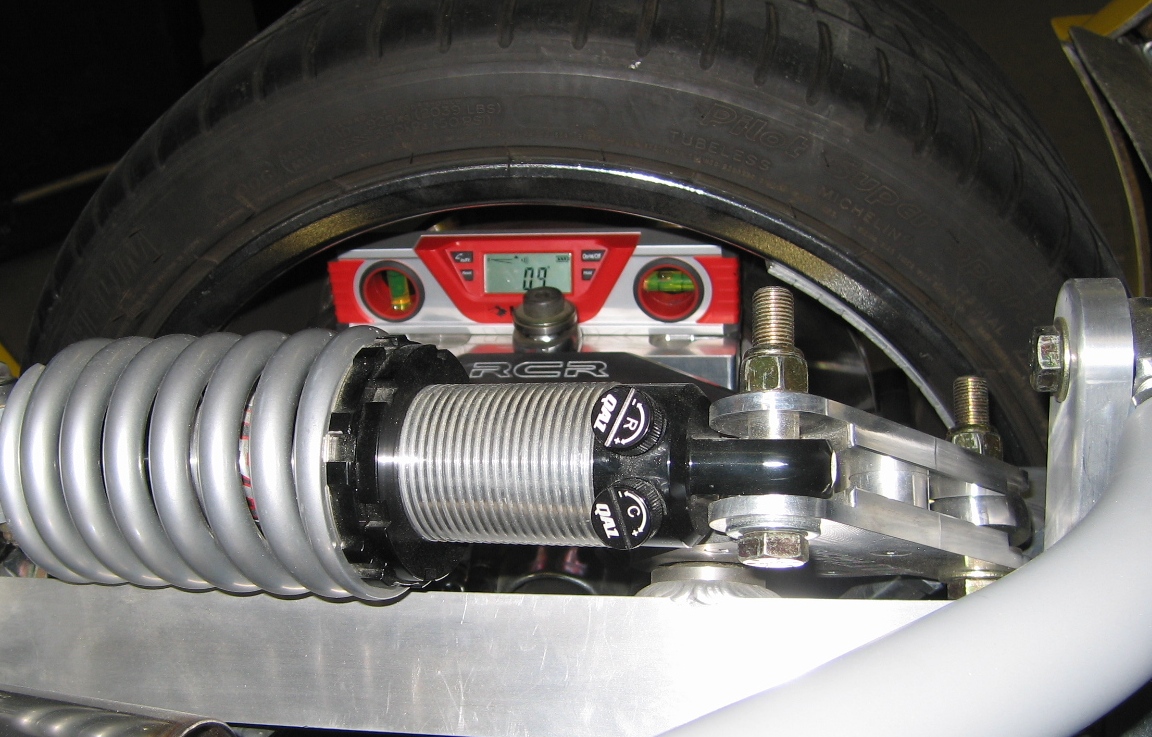

I'm re-aligning my suspension after fiddling with the ride height. I noticed that the rear wheel bearing carrier has a horizontal surface on the top. When I put my digital level on that horizontal surface it reads very close to level (0 degrees).

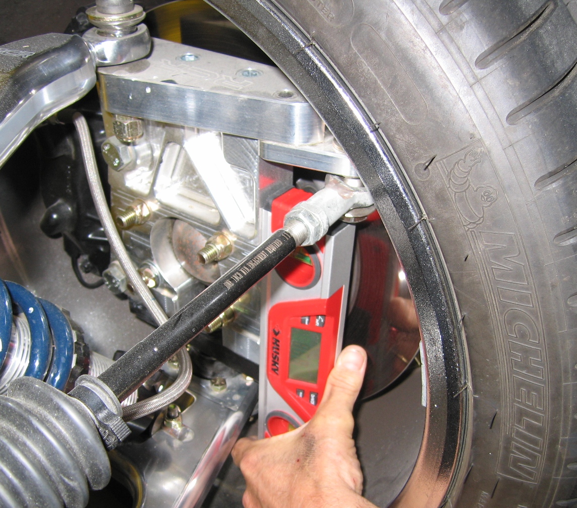

On the front wheel bearing carrier there is a vertical surface that reads very close to 90 degrees.
Question: Is the required 5 degrees of Caster designed into the wheel bearing carrier? In other words, if I adjust the wheel bearing carrier to be level in the rear and 90 in the front, will the caster be 5 degrees?

the rear should be zero or near to.
The front already has 5 deg built into the offset...anything above 90 deg on the surface you are measuring will be in addition to the 5 deg built in.
So in short...the answer is YES...
