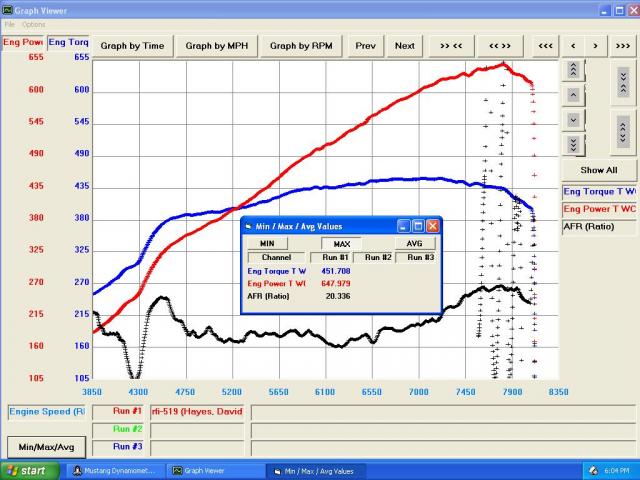

Fwiw, three rotors have moderatley flat torque curve. They are also a 4-stroke engine. I've posted this before but here is a dyno graph of a moderately built 3 rotor on pump gas.
attachment.php

Frankly, I don't know how much more than 500hp can be reasonably utilized in a 2000 - 2200 lb car.
4 to 1 power to weight ratios 500hp/2000lbs in a road race car is about all most people can handle. I don't want to offend but 2 to 1... or less???? get real.
