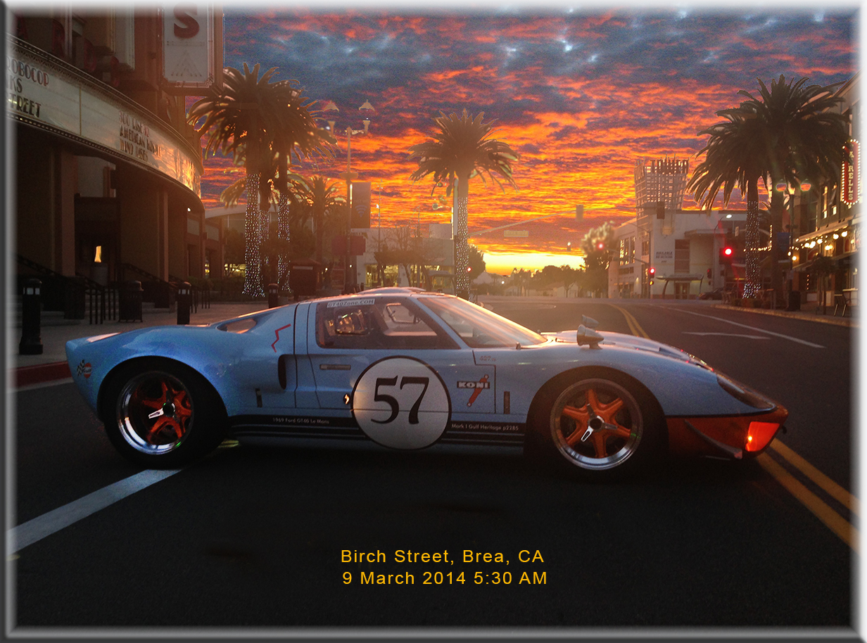

Springtime In America GT40 p2285
Cool pic Robert. Someone saw you driving down the highway yesterday.
