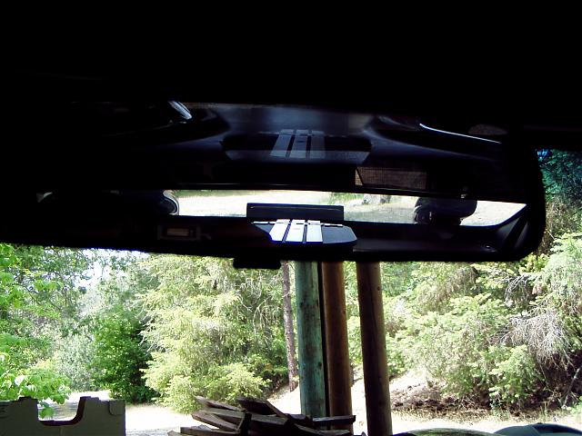

I thought I would ut a thread together n my mirror solutions. The rear view mirror was provided by SPF. I centered it as high as it could be installed on the window.
There is a narrow vertical viewing slit, but you can see that there is a fairly wide view - past the snorkels.

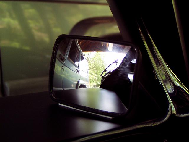

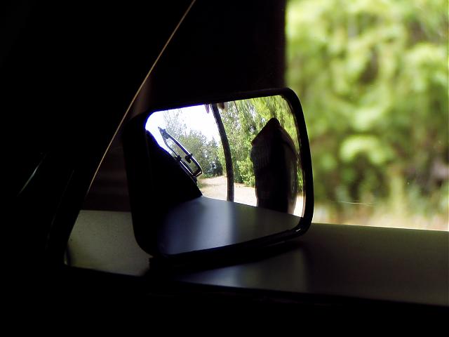

For side mirrors, I haven't seen any style that I liked for exterior mounted ones. I also don't want to drill holes in the bodywork, so I looked for convex interior mirrors and found these. There were real cheap ($2.99 each I think) and extremely light weight. They mount with double sided tape and fit like they were made for this location.
The installed photos are from teh drivers point of view. One the left hand mirror, the reflection of the left most door knob on the blue Jeep is 90 degrees from the driver's eyes looking forward. You can also see the left side air scoop. So, this mirror covers the blind spot.
On the right hand mirror, the telephone pole and trashcan in the reflection are in the blind spot on that side the pole being at about 135 degrees form the driver's eyes looking forward.
When driving with these installed, they did not vibrate and provided clear images driving across some fairly bumpy rural roads at speed.

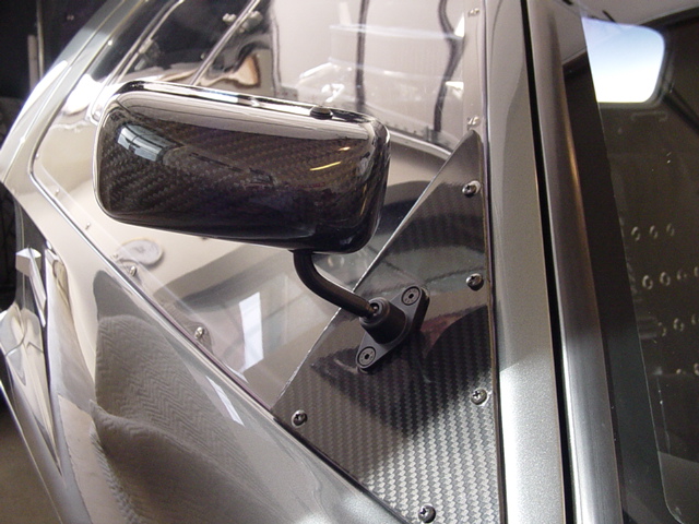

Here is another method of attaching side mirrors by using the existing screw holes in the side windows.
exterior mirrors are pretty tough. These are some great ideas. My oldest son just broke the passenger mirror with his bum. I am glad to know that other people have the same problems with the look and utility of the exterior mirrors. I too would like to know where to get the carbon fiber mirror that mounts to the window screws. They are the closest style that I have now.
The mirrors were purchased from APR Performance. The base was fabricated from flat stock. The 2 mirror mounting screws go through the base and window and are secured by nuts on the inside.
Rich:
Those are some fine looking mirrors and mounting plates! Who makes them and where can I get some?
Kim
Hi Kim, the mirrors are on my GT40 MkII, they are APR Perfomance as mentioned, below is a link - they are the Universal Formula GT3 5.5 Mirrors.
APR Performance - Formula GT3 Mirrors
The base plates are made from two sided carbon fiber, I made a template in the shape you see and cut with a saw with a fine tooth aluminum blade. Not too hard to make, let me know if you would like a set, I would be more then happy to do so. Joe.
