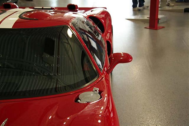

What do you think of these mirrors. I ordered a set. (Not my car in pic):dead:

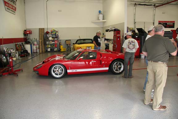

Kevin...Look at the front view and note the black plastic eyebrows on roof...It is a SPF ...Has MK1 wheels...I believe if you look close there is still the space some have complained about in rear wheel well but I have seen a number of pics of original MK11's with now available tires and all pics show that the rear wheel well space is like the SPF...So seems it is differance between no longer original tires and what now available...With Avons and 4" road clearance to frame I'm OK with mine. Steve P2125
Yes, its an SPF. I believe those are 17" wheels, but not sure.
Builder is Snakepower Performance in Glen Ellyn, IL, the same one who built mine.

Mike...To your question re mirrors....For me I wanted the traditional look so went with the dual Talbots mounted as can be seen in my pics about 1/2 way between where the Brits typically mount them (on the fender crest) and to the fender rear and visibility is OK on the MK11...BUT for a more modern look and best visibility I think the pics you posted are best I have seen and look great. Steve P2125
Steve, you are absolutely right. I respect the heritage of the car, but the more time I spend in the car, the more I realize that I need proper rear vision. Right now I only have the windshield mirror, and frankly, it is a dangerous situation. My advice to those waiting for delivery of their SPF would be to have your mirror choices sorted out and installed before you even get behind the wheel.
