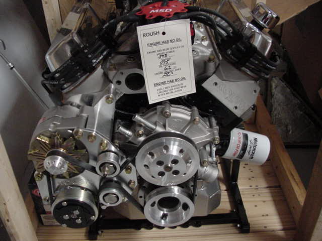

A picture of the engine out of the car by request.

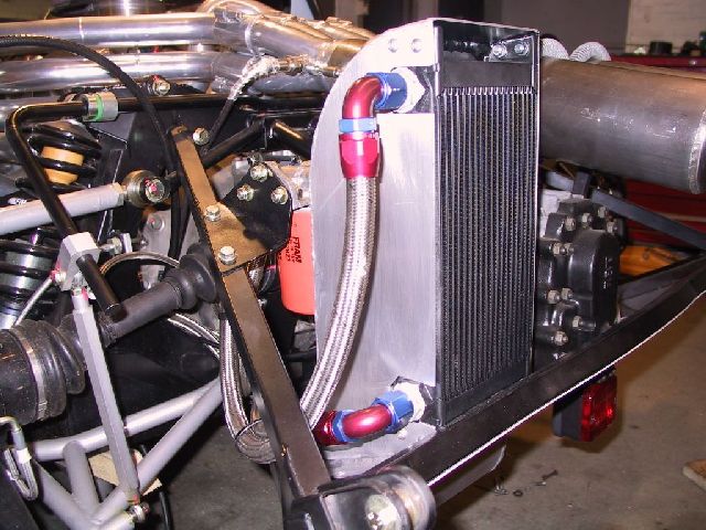

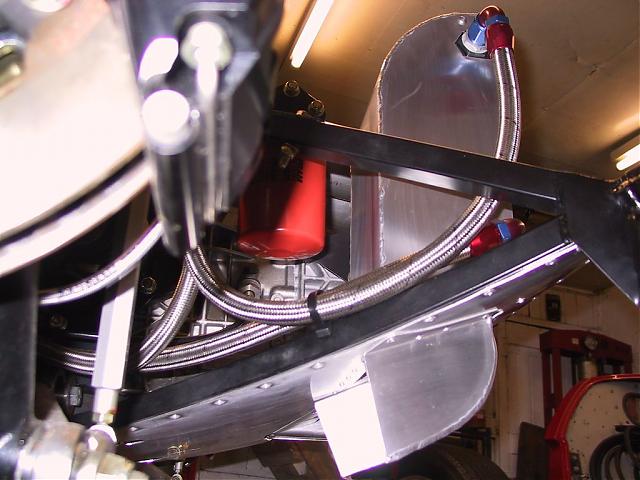

Option for Oil filter and high efficiency oil cooler on SPF.
Rich, this set up is fitted to a SPF mk1, but can equally be fitted to the Mark2, very high air flow/cooling efficiency, this is a copy of oil cooler set up on some later original GT40 race cars, and we also fitted to P1088.
