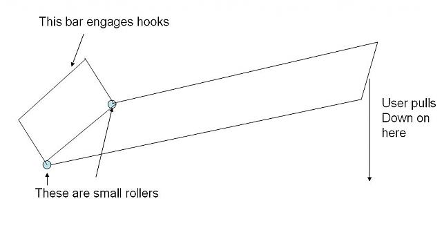

Here is an awful drawing I did in PowerPoint.
Keep in mind the angle must be over 90 degrees so that the load is "over-center" and the weight of the car keeps pressure on the handle to the ground. Also you want to bend end of the handle are upwards, so that it is not on the ground allowing you to get your hands on it when the car is up.
Don't know what the formula for the length of the handle to the weight of the car is 'though. Perhaps one of our more educated members has that info.
Rick
