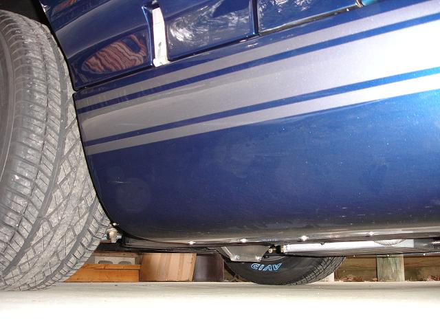

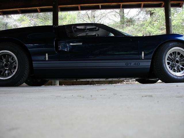

Oh, a couple fo the shots above are to show ground clearance. I didn't have a tape measure with me, I will measure tomorrow, but I estimate 4". The lowest point is the bellhousing in the one pic, but it is within the wheel area.

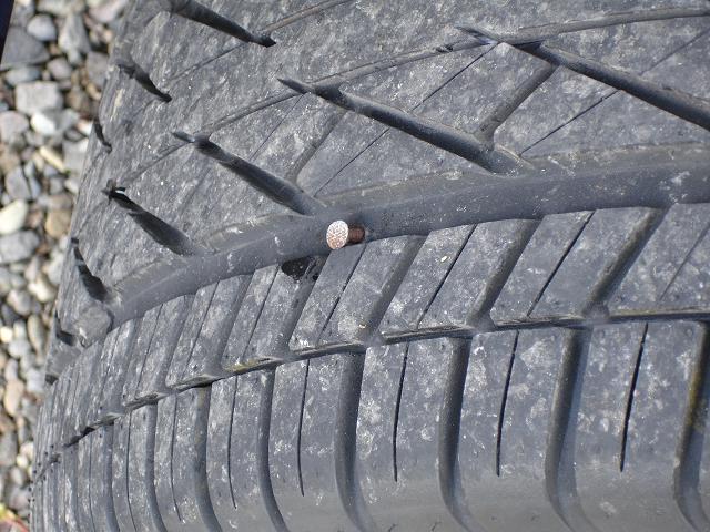

Bittersweet day...had another nice drive, but when I got home I discovered a nice nail in the right rear tire. I don't have a lead hammer to get the wheel off. I called Superformance and they have them in stock for about $20. Now why wouldn' they give one with the car...or suggest you buy one with the car?
I also do not know where the proper jacking points are. Other than the ery front and very rear - I dont have that kind of jack. Anyone know whre I can get one? Or where the car can be jacked from otherwise?
The clearance I measure is 4 3/8" at the sides. I can't measure the clearance at the bellhousing.

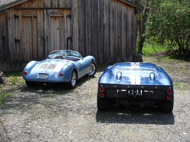

I took the opportunity to put the GT next to my other replica - 1955 Porsche 550 Spyder. 11 Years span the designs.

Some other observations:

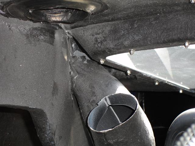

Some of the ducts are not hosed. Here is a shot of the back snorkels from the inside. There other ducts not hosed are the outboard ones up front that would feed brakes I assume. Picture 1 below.

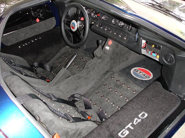

Here is a shot from behind loking in and you canjust see the white oil filter. Have to get at this from below. Picture 2

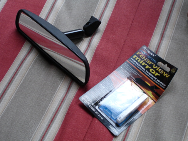

Picture 3 - I just liked the shot!
The two "snorkel" scoops on the rear deck are to cool the rear brakes. The scooped slot between them is to cool the transaxle. Apparently Hi-Tech/SPF has left it to the purchaser to install the ducting from these to the brakes and transaxle. (Actually, unless you plan on getting into endurance racing, such ducting to the components probably isn't necesary.)
I also do not know where the proper jacking points are. Other than the very front and very rear - I dont have that kind of jack. Anyone know whre I can get one? Or where the car can be jacked from otherwise?
At least a couple of the SPF GT40's that've arrived at my local dealer have had brackets at the rear to, just like the originals, pop up the rear of the car for with a quick-jack for a fast rear tire change in the pits. Did yours come with one of these? A quick-jack shouldn't be hard to come up with (but you should use jack stands once you get the car up as, as you probably know, supporting a car with a jack when your under it should never be done.). I would contact Olthoff or HI-Tech for the proper solid points on the car for jacking and supporting, rear and front.
Mike,
Although not original, I intend to use a good quality "Dead Blow" hammer for the knock-offs. These are hammers filled with lead shot or sand and have a fairly soft urethane exterior. I think these will do the trick with less marring than a lead hammer. Wow a nail that quick, bad luck.
I just went out and tried using a standard hydraulic floor jack (not a bottle jack!) on the quick-jack point at the rear and it lifted it no problem. Keep in mind however, I still do not have motors and trans in them. If I were to do it with the engines in I would probably go get a heavy steel bar that would span both quick-jack points and than jack in the middle of that. As always chock the wheels and use stands. Just my 2cents
