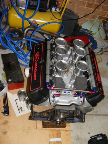

Ahh, bugger. Just checked a photo of the back of my Boss block and found out it does not have the later version stiffening ribs. Oh well, can't do much about it now! Hopefully 7000 rpm and 380 ish RWHP are not going to give it too much grief over time.
And yeah, when the engine builders first put mine on the engine dyno a couple of years ago it poured water out of the head gasket and I have Edelbrock Victor Jr heads. From memory a gasket change to Cleveland fixed it...but my memory is dodgy and it wasn't me doing the work.
