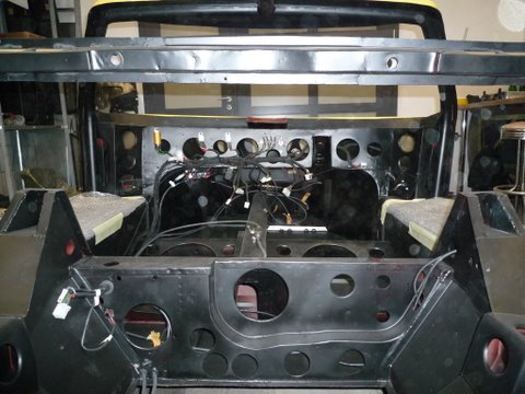

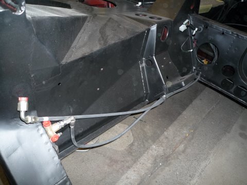

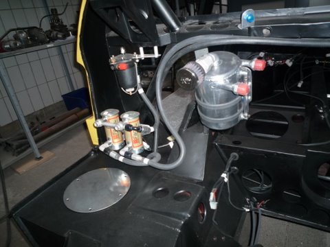

If you're going to panel that area I would be tempted to do it more like the originals and make the panelling go round the lower radius arm mount.
It would be a pain to put the bolts in (may need to consider how you'd do it, maybe a removable panel, how do the originals do it?).
See the attached images.
