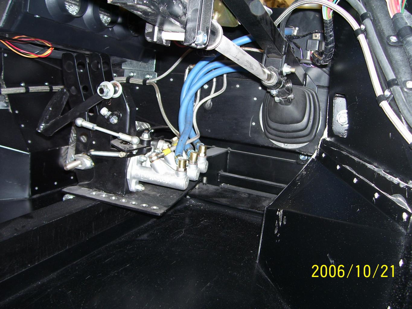

After a few more attempts I've finally got a housing design that works. I went for a more pyramidal shape as per Tom's recommendation. This design pinches the sides in meaning the brake pedal clearly misses the housing.
Now I just need to make it in aluminium. It's the simplest looking jobs that seem to be the trickiest

Hey Keith, wanted to add a housing purely to keep things nice and tidy and to seal away the UV joint to stop anything getting in there. The plan was to make the housing removable with some rivnuts so that if indeed it does get in the way it can be easily removed.
I am also going to try a version today of fitting a simple aluminium surround around the hole and then covering it with some thin rubber sheet I bought with a hole for the column. Again using rivnuts so if the rubber needs replacing or I have issues it can be removed. Will post up some pic as usual.
Keith, I didn't receive your last PM as my inbox was full, it's clear now
OK guys thanks for the response and the suggestions. I think we might have a winner. How about something like this?
It's basically a flat backing plate with a circle cut into it. This give enough room for the UV joint to pass through and is flat so won't cause any space issues. To finish I'd put some riv nuts around the square plate so once removed I have a decent space to work in. I think this is a nice simple solution and with some rubber edging strip around the hole I think it will look nice a tidy.
What do we think? Let me know and I'll knock it up this afternoon.
Trev
Spent a little time this afternoon making the new simple removable panel with hole cut into it. I added a spare bit of rubber edging to test the clearance of the UV joint but didn't have enough to cover the whole opening.
I am really happy with this simple option and the clearances are spot on so will drill it into place tomorrow and fit rivnuts and I've ordered some extra edging to finish everything off
Trev, I'd still fit some kind of rubber boot to seal it. I'm not 100% sure on the tornado layout beyond there but it's got to be reasonably open to the elements, you're not going to want the cold draft you'll get through there blowing straight on your feet.
hmm, thanks David. I am getting some mixed thoughts here, some people saying to cover the hole, some saying to leave it open. Ideally it would be nice to seal it up but because the UV joint and bolt stick through quite a bit making something to cover it requires room around the pedals.
After another look this morning I had another idea. Now I have a circular hole on the removable plate I could fit a domed plastic or metal cap into the opening and then drill a hole in the top to allow the column to pass through. A quick search on ebay and I found a 72mm dust cap for a trailer. Could this work?

Trying to keep it simple Keith, hence why I tried you idea of not bothering to cover the hole. Will try the standard Tornado approach but after playing with some rubber sheet today the problem will still be the bolts rubbing on the rubber sheet. I'd rather the UV joint didn't rub or come into contact with anything as I don't want it to get caught/stuck etc should the rubber wear through over time.

As for the GT40, I've had a thrust washer welded to the new steering column and that's all done now and I've bought a gear gaiter from an old Ford Fiesta which I am hoping should do the job to cover the hole where the UV joint comes through the front bulkhead.
