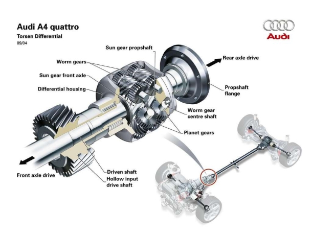

I cant see that Boxster trans holding on to anything with grunt Howard, we are also talking about torque converters as well here which on a small diameter will always struggle with HP/torque. I found an image of the torsen unit on the big Audi quatro box and it does not look like it would involve much to remove the torsen unit to just drive the forward shaft.

Ah, this photo is perfect. Looks like it might be rather difficult to remove the differential as the gear mechanism isn't a simple gear, it goes all the way to the torsen.
From this photo, I would guess that, to accomplish front drive only, we would have to weld the gear to the "front axle drive" shaft and have the driven shaft turned down. Either that, or have the entire rear shaft machined new. I guess we could have a cover plate made for the end of the transmission, to cover up where the torsen would have been - would shorten the transmission quite a bit as well.
The only concern I have about this would be the strength rating of the output shaft gear. Was the front drive axle assembly ever designed to take 100% of the load? The torsen differential probably does a good job of splitting the load between the front and rear.
