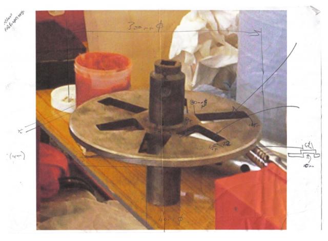

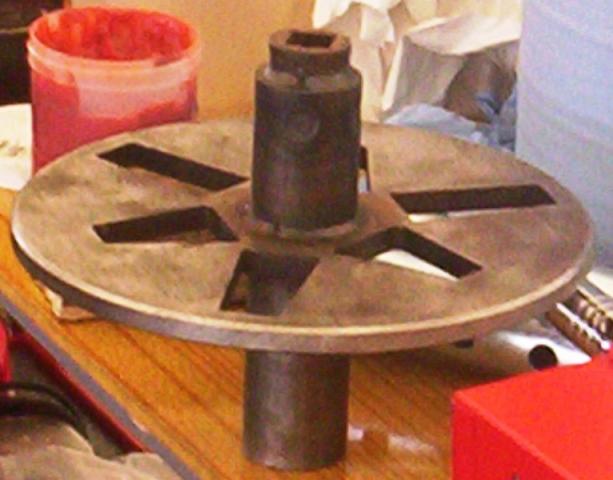

Here is a pic of one i took in France 2006 and, again, with it marked up with nominal sizes. It does seem a very complicated (and heavy) device for such a simple operation though.

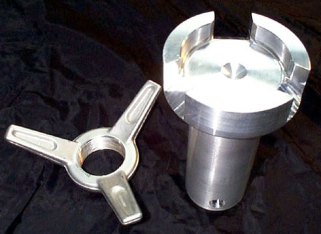

It appears to be of supreme quality, consisting of an aluminum base, with three super-hard plastic bits attached to it to act upon the ears of the spinner. (edit--here is a photo)

Problem I can foresee with both of those is clearing the centre boss, to get low enough to mate onto the three spinner lugs.

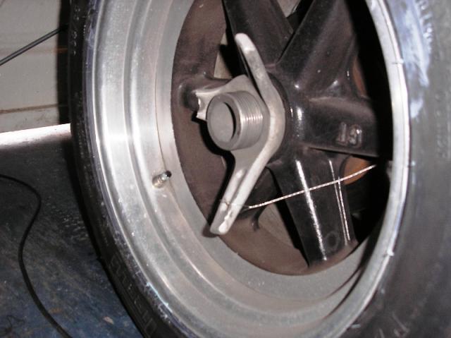

this is a pic of what happens when an apprentice tyre fitter doesn't know which way to hit it!:rolleyes:

I have one of these, and it had a problem in that it may not be deep enough if you have a long knock flange coming out of the wheel. It also has only a spot for a bar to be slid through it no socket attachment, but will work ok otherwise. I think it was also too short for the wide rears rims to be of use.

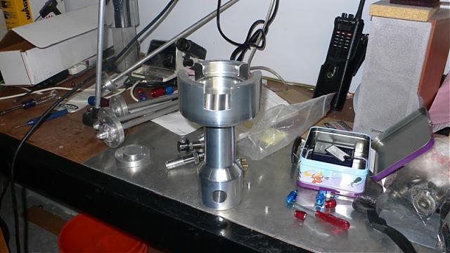

Thanks Sandy. I'll probably fit a boring bar into my lathe and bore out an inset to accommodate the threaded flange (might help to more positively locate the tool). And, was thinking about machining and fitting a 3/4" socket receiver to the outboard end somehow so that the thing will work on a deep set hub. Will post a pic when I've made these mods.

I was going to run it over to my friends machine shop and do a hex on back for a big socket. I think mine might be a bit different then the photo in that it has a bigger end for the side with the bar if that makes sense.

The spinner removal tool I just received from Finish Line Accessories looks exactly the same as Sandy's. It has about a 5/8th's deep inset inside of the three slots machined in it in order to accommodate some excess threaded wheel hub which may extend out somewhat. Overall, a very nicely machined tool for the price!
I also would like to be able to use a long breaker bar with a socket attachment rather than a bar through the machined hole at the outboard end. I'll make a 1/4" circular steel plate to bolt onto the outboard face with a square cut into it for the breaker bar - the aluminum by itself won't stand up to the torque of the breaker bar socket head.
