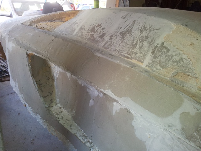

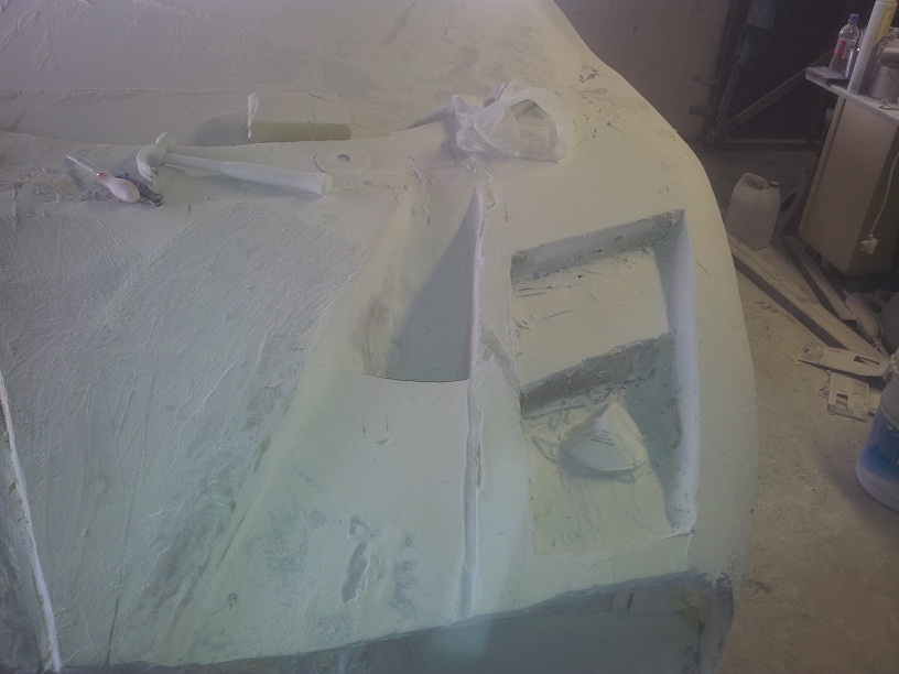

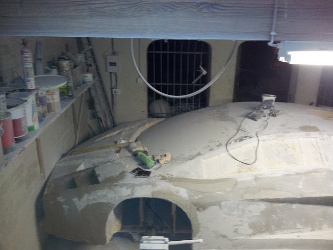

Ok here are the latest photos as promised.
As you can see work has been started on the righthand side as well as the front vents and bonnet vents.
Bonnet vents still need some more ideas, just made a start with it but still not happy.

Judging from the layer of dust on the floor you are making some good progress! As the body is taking shape it is looking like the tiger wants out of it's cage... Keep up the good work.
best regards, Doug

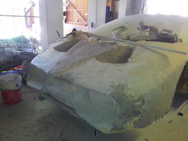

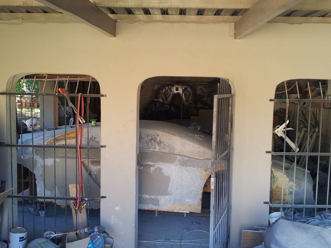

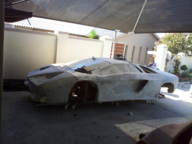

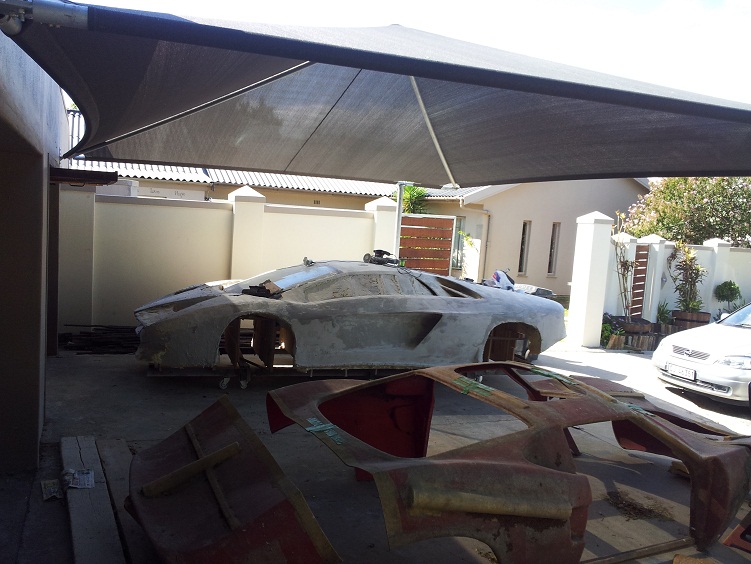

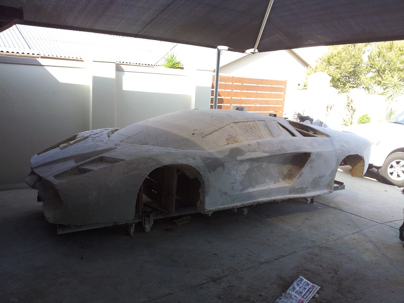

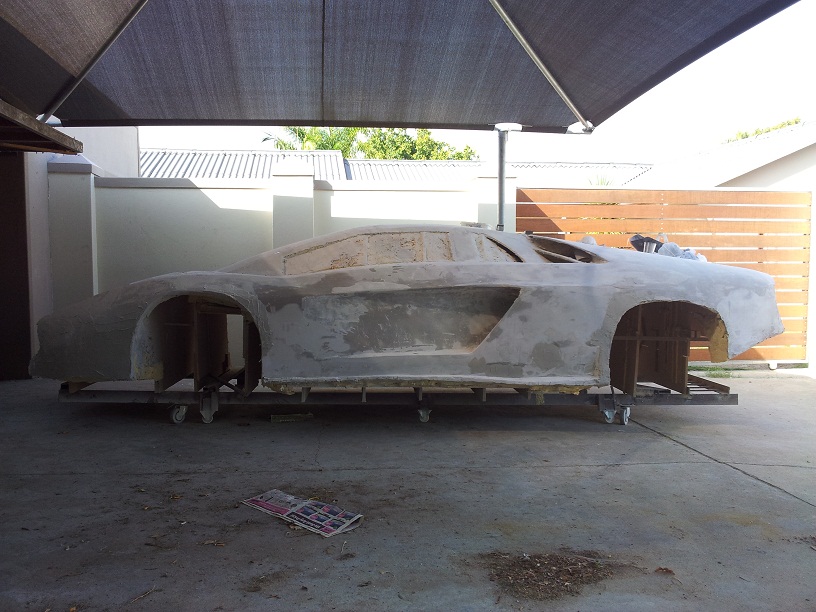

Hi guys.
Did quite a bit on the nose this weekend. AND! My Vigi left the garage for the very first time ... yeah.. on trolley wheels but still. Here are some pics.

Hi, it's good to be able to step back and get a different perspective of your work. The proportions look good. Also, I see a peak of your GT40 molds, have you been able to find a completed car made from them?
best regards, Doug

Hi Doug, unfortunately that is not a GT40 MK3 as I initially thought. I posted the pics of the mould in a GT40 section and it was very quickly pointed out to me that it was not a GT40.
A friendly, helpfull chap, cannot remember his name now, told me that it was a Valkyrie Kit from the States. He actually also posted the link to the Valkyrie website. At that stage I was disappointed but decided that I would still build one because I liked the looks. Then another member kinda dissed the Valkyrie in no uncertain terms. Basically came over pretty negatively. Anyway I still like the looks of the car but dislike the rear wheel section where it doesn't look right and the wheels are exposed at the back. So when i do build one I will first pull a body from the mold and that will become my prop. I will then change the rear wheel section, maybe some other changes too, then pull a mold from that and then start... I know it's a helluva lot of work but I would not be happy with the mold as it is.
Anyway the Vigi has priority by a country mile. So I will definately only look at it once I have the Vigi completed.
Cheers mate
Jackal
Jackal, the fit of the Fiberfab Valkyrie panels is terrible to begin with. You will have a lot of work to make it right. The rear section really needs help. Loose the rear spoiler and widen the lower sections to balance the overall appearance. Just maybe you can study how to cut off the original sections and use them, or pieces of them.

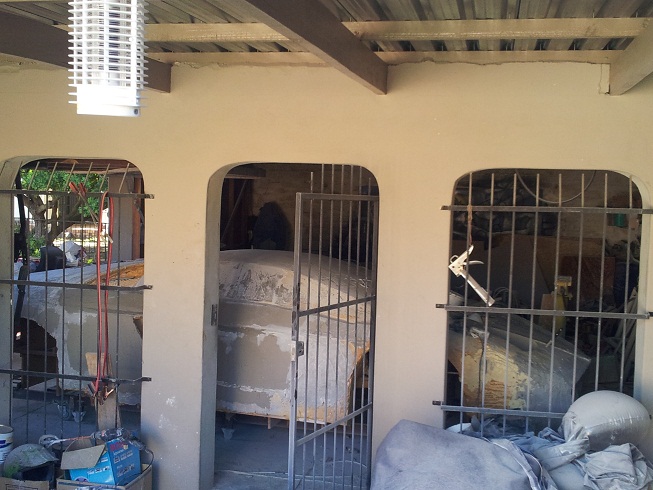

Did my left front light cut in. Will post some photos next week Thursday. Unfortunately I no work because of Easter and a road trip.
Jackal
Jackal
CURRENTLY BANNED

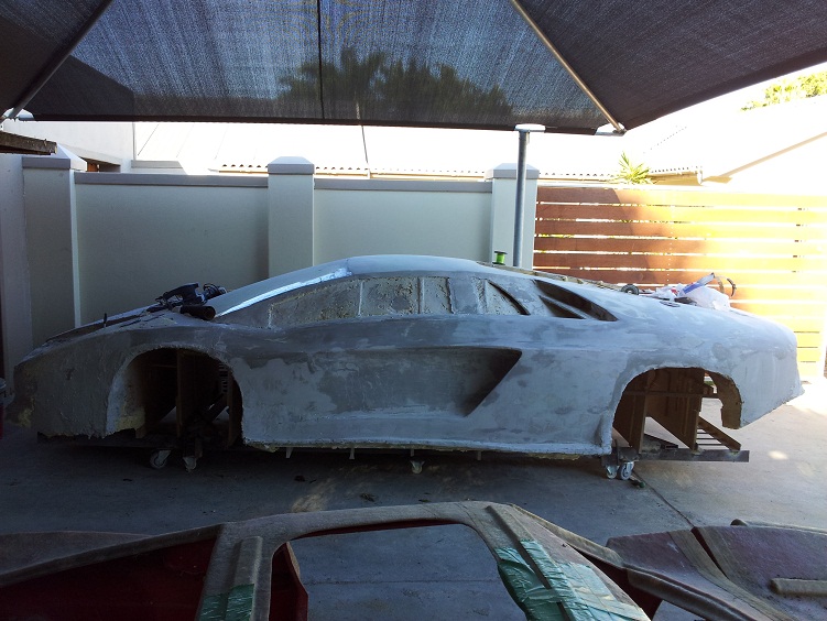

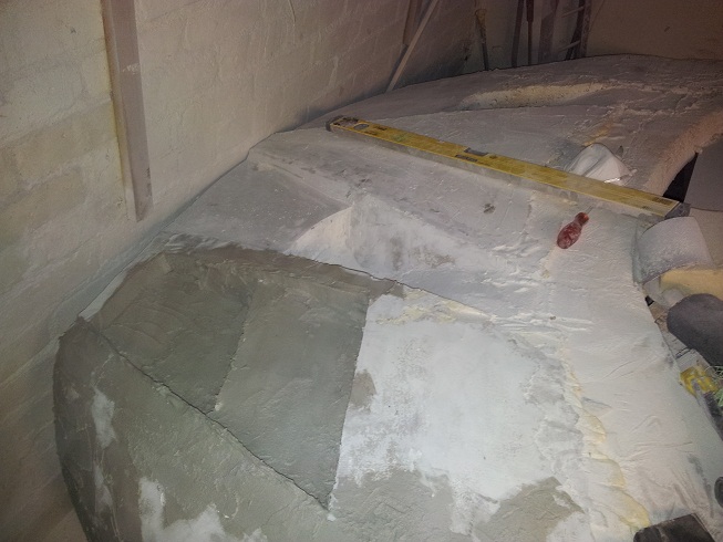

Ooops, took me longer than I thought it would. The left cut in was finished on Wednesday last week and according to the Murcielago's light design. I didn't like it at all though. Not the design itself but because my hood looks very different and the v-shape bonnet and the lights angle running the other way caused clashing angles. So I had to think about and ended up changing it 3 times. I like what I have now. I already put the car in the garage before I remembered to take photos so these photos are from the left side only. I will post some frontal photos once the right light cut-in has been made as well.
Cheers!

Jackal, Do you have some donor lights or are you using originals?
--- Doug
Hi Doug,
No mate I haven't got the originals. I'm shaping my own cut-ins and I will be using projection bulbs. I got the idea from www.supercarreplica.com/
Lenses I will shape, and cut myself.
It's about this dude showing his Murcielago build. Go to the the 'Discuss' tab. Then under Kit car related stuff, look for the projection bulbs.
I'm not too proud to admit that I got the method and idea from this site to also make the tail lights. Also look at how he changed Fiero seats into Lamborghini seats.... stunning work.

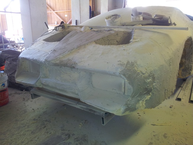

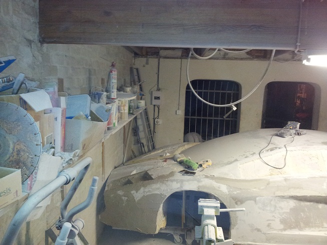

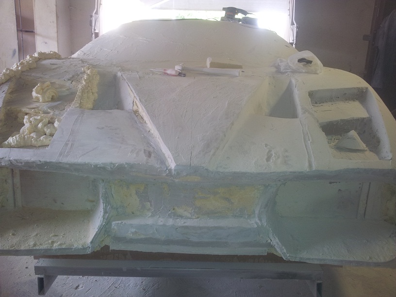

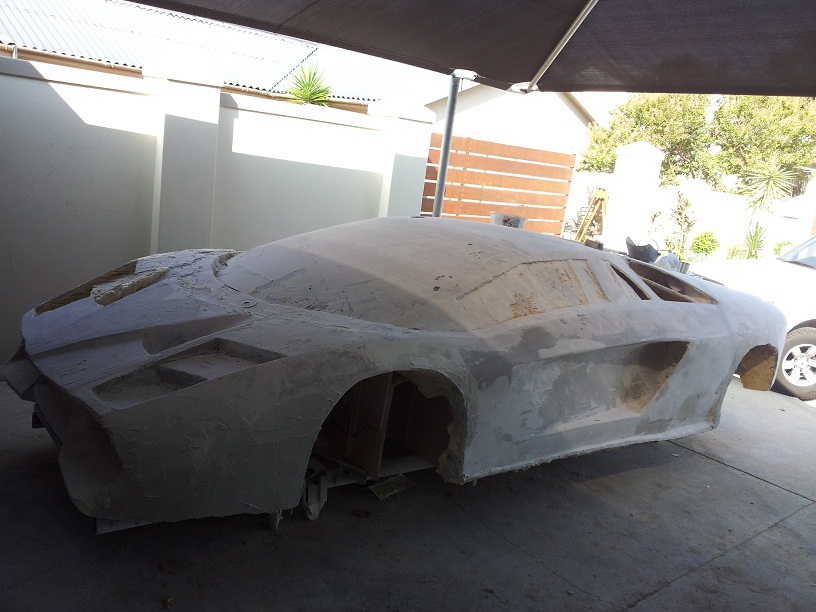

I worked on the left cut-in as well (lights).
Not happy with my front vents yet and the overhang from the front wheel seems to be too long. I will address that this week.

Changed the rear engine cover design to more conventional, enlarging the rear window. Haven't decided what the lid will look like yet. Might be louvred or might just have reversed vents. Decisions decisions! Also did alot of work on the nose (v on the bonnet) Will post some photos as soon as I feel I am far enough. The front intake vents will be change as well. Not happy with them currently. Most probably will be cutting them this evening.
I promise plenty of photos soon!
Sounds like you have been busy. Your project will truely be one of a kind, (best of all worlds?!), in any case surely enough to keep the lambo police at bay.
