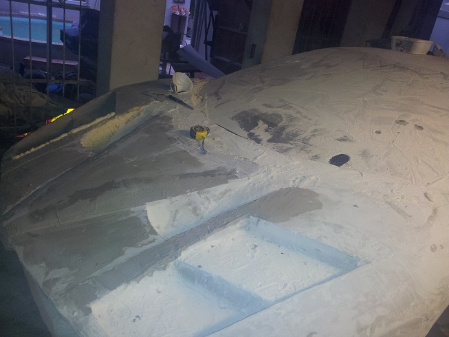

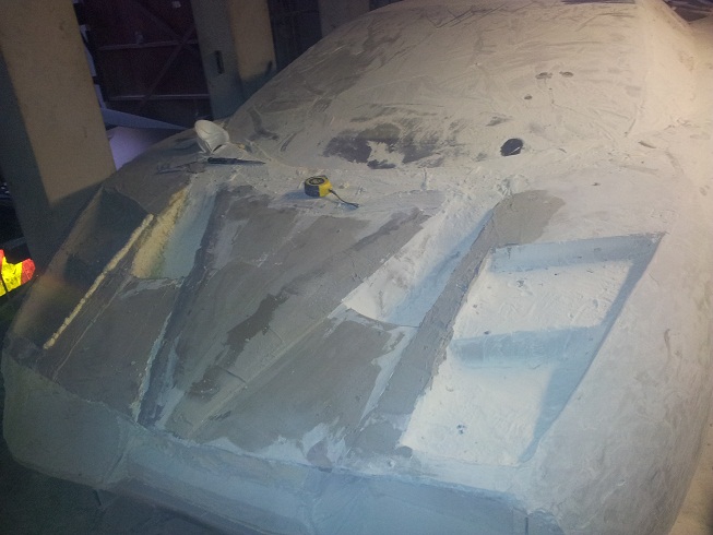

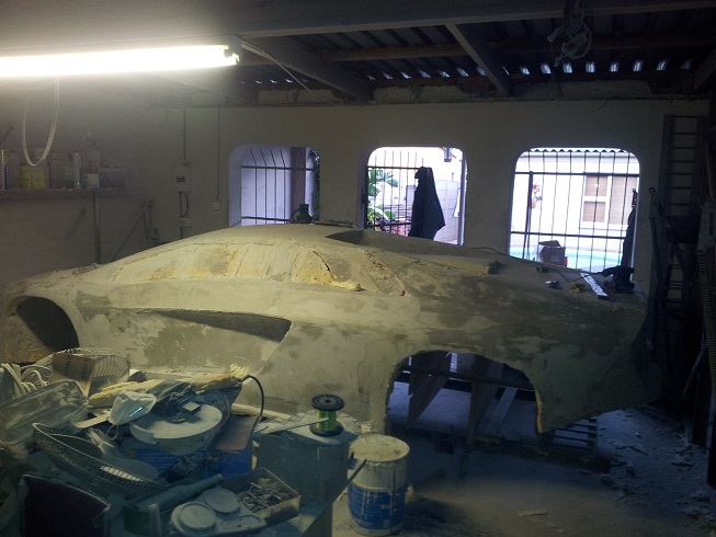

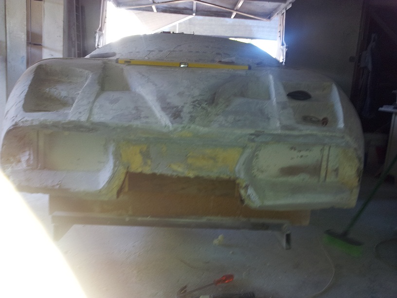

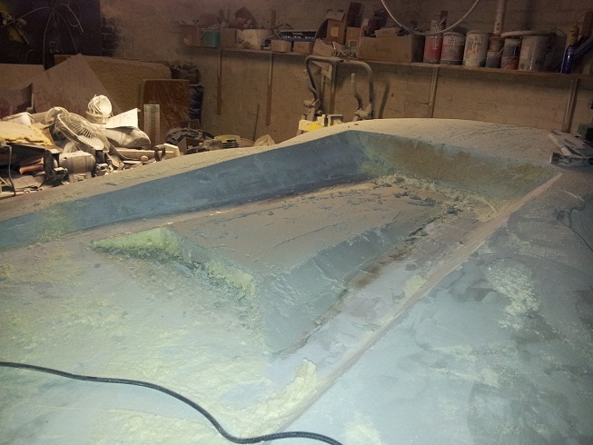

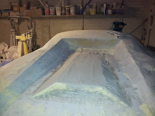

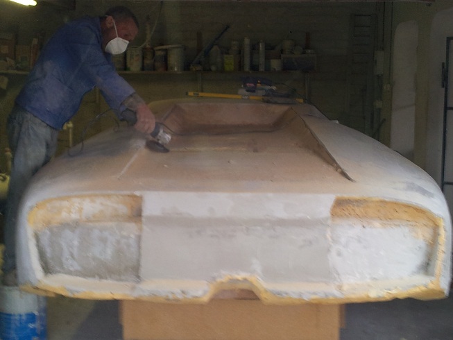

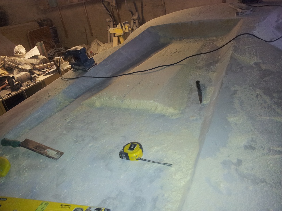

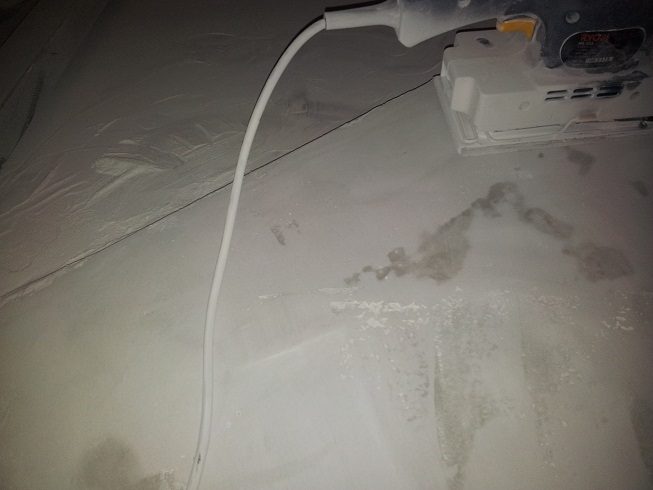

Well the negative first. I have now received my fourth warning from law enforcement about sanding and annoying my neighbor. I'm just going to keep going.
As for the build.
I have been working on the engine lid vent and also on the nose and the right side of the car. The front still needs alot of help! So I'll be on that this evening again.

One tip, get a couple of milk crates to stand on. More stable and easier to move them around than a drum. When I was working on the top surfaces I made some longer benches to stand on so I could move along the length of the car without having to step up and down all the time.

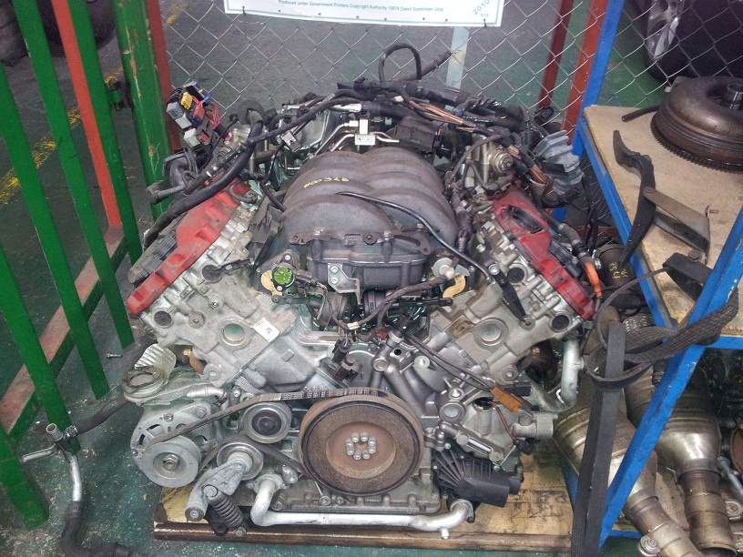

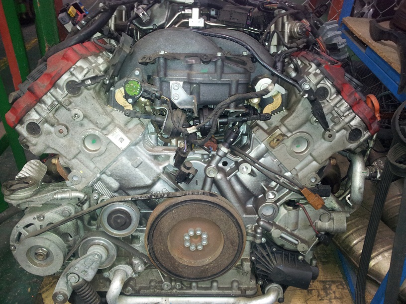

Anyway! Here is my Vigi's new heart! 2007 RS4 FSI V8, 420 BHP! I'm as happy as a pig in sh*t!

Nice V8, you can probably already hear it heading for the red-line. Do you have a trans-axle picked out?

Hi Doug,
Yes mate, the fantasies are running wild! :-)
I bought the engine, gearbox, ecu and wiring herness as a package. Also looking at the complete suspension but will have to look what they want for it. They also have the discs and calipers.

Yes Doug. I have to lock the rear and only have drive through the half shafts to my rear wheels.
Not a very good idea. I really wouldn't expect that to last long at all. The awd gearboxes aren't as strong as the 2wd as they have a hollow input shaft and only have to be half as strong. If you can I'd get hold of a proper 2wd gearbox and sell that one on.
Thanks for the input. Could one replace the hollow input shaft with a solid one?
Sorry if that is a stupid question but my knowledge of gearboxes is about zero! What 2wd box would have the same gearing as the RS box?
Thanx again.
