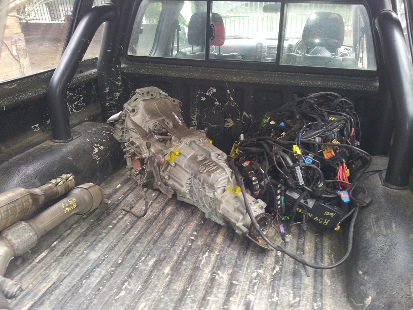

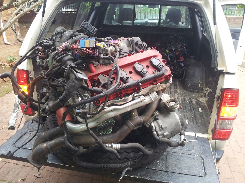

Thanks David. I definately have a OA3. I picked up my engine, box and other stuff today.
