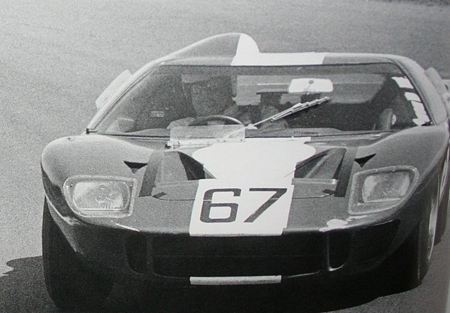

......expanding the "Gurney Bubble....
Like this, for example:

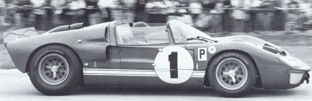

Or, just build a roadster:
