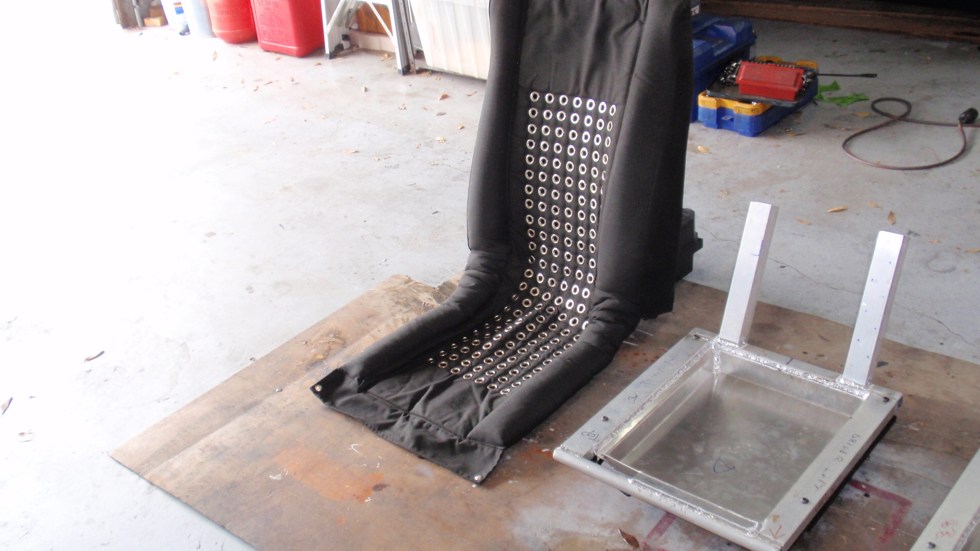

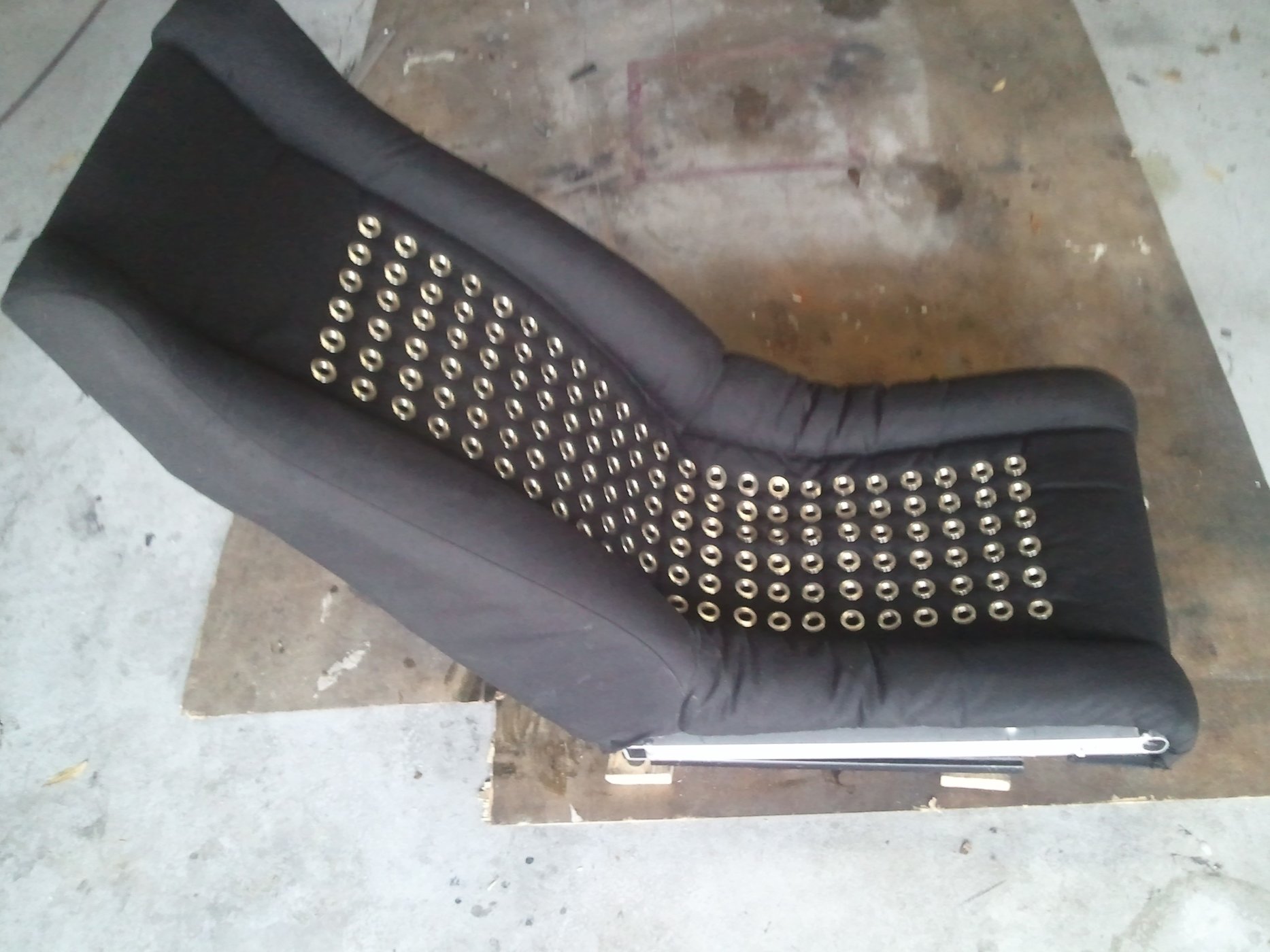

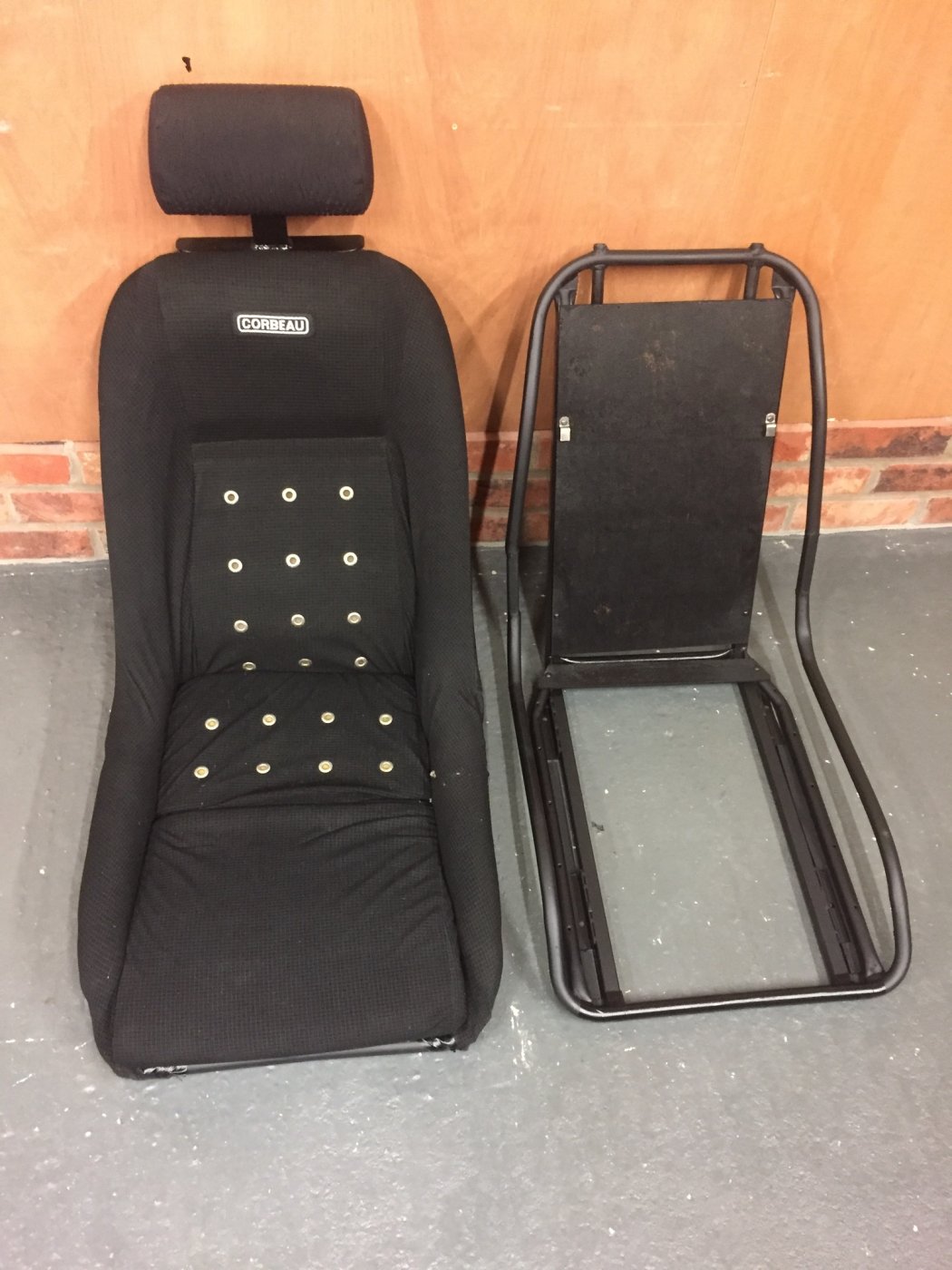

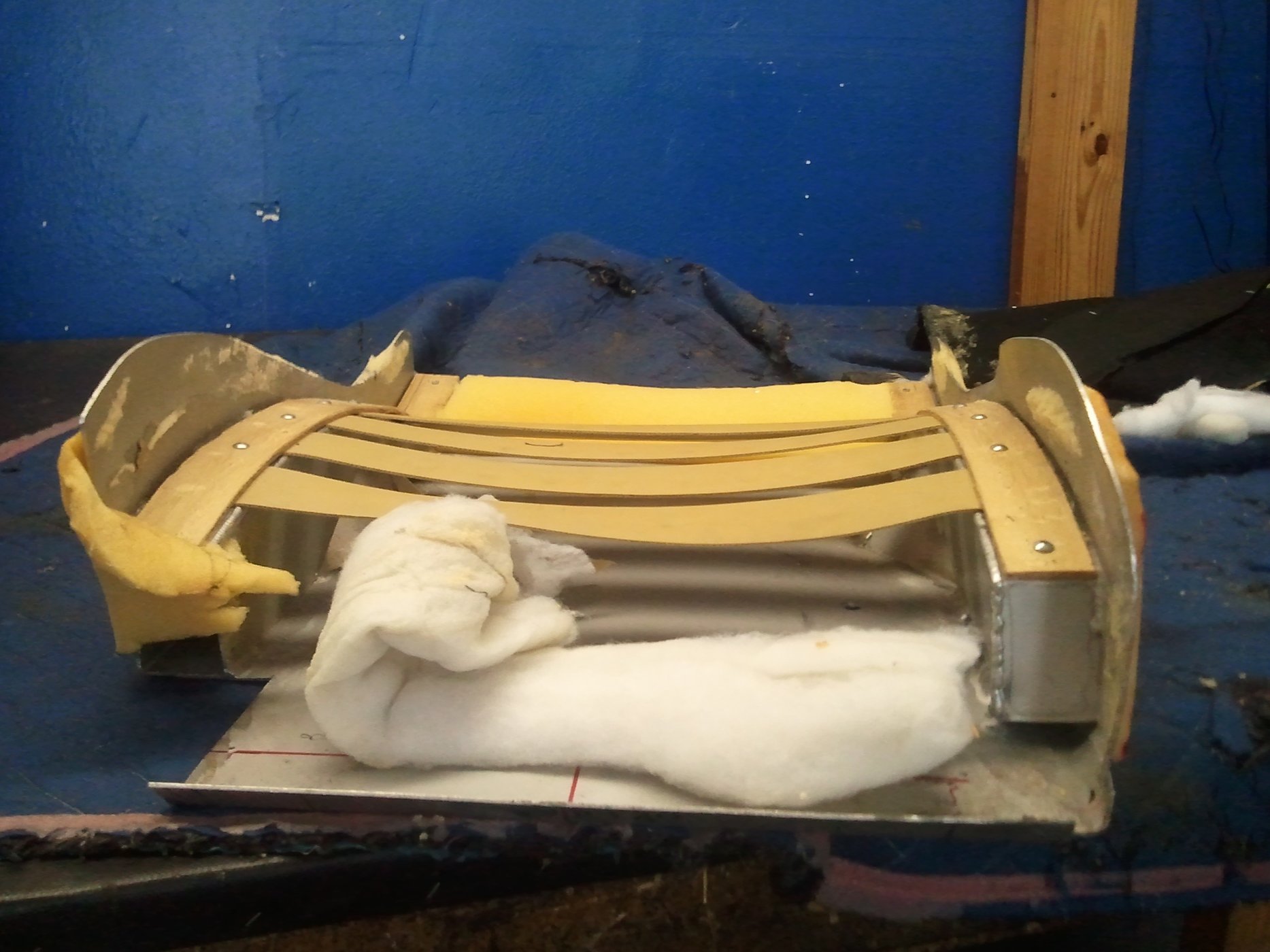

Seats:

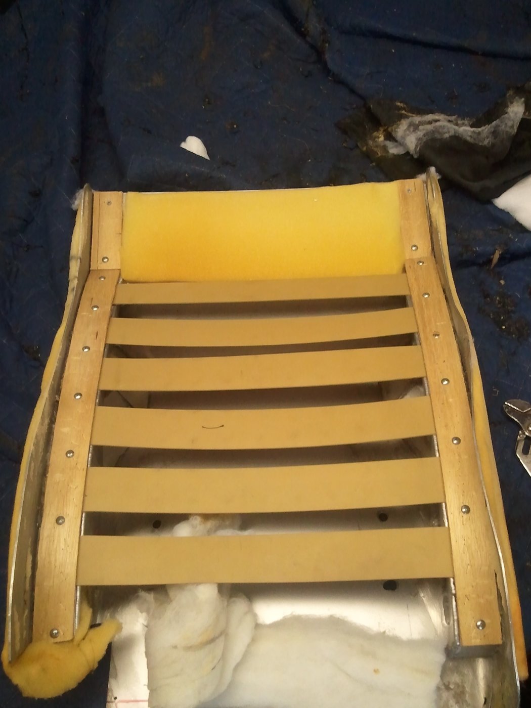

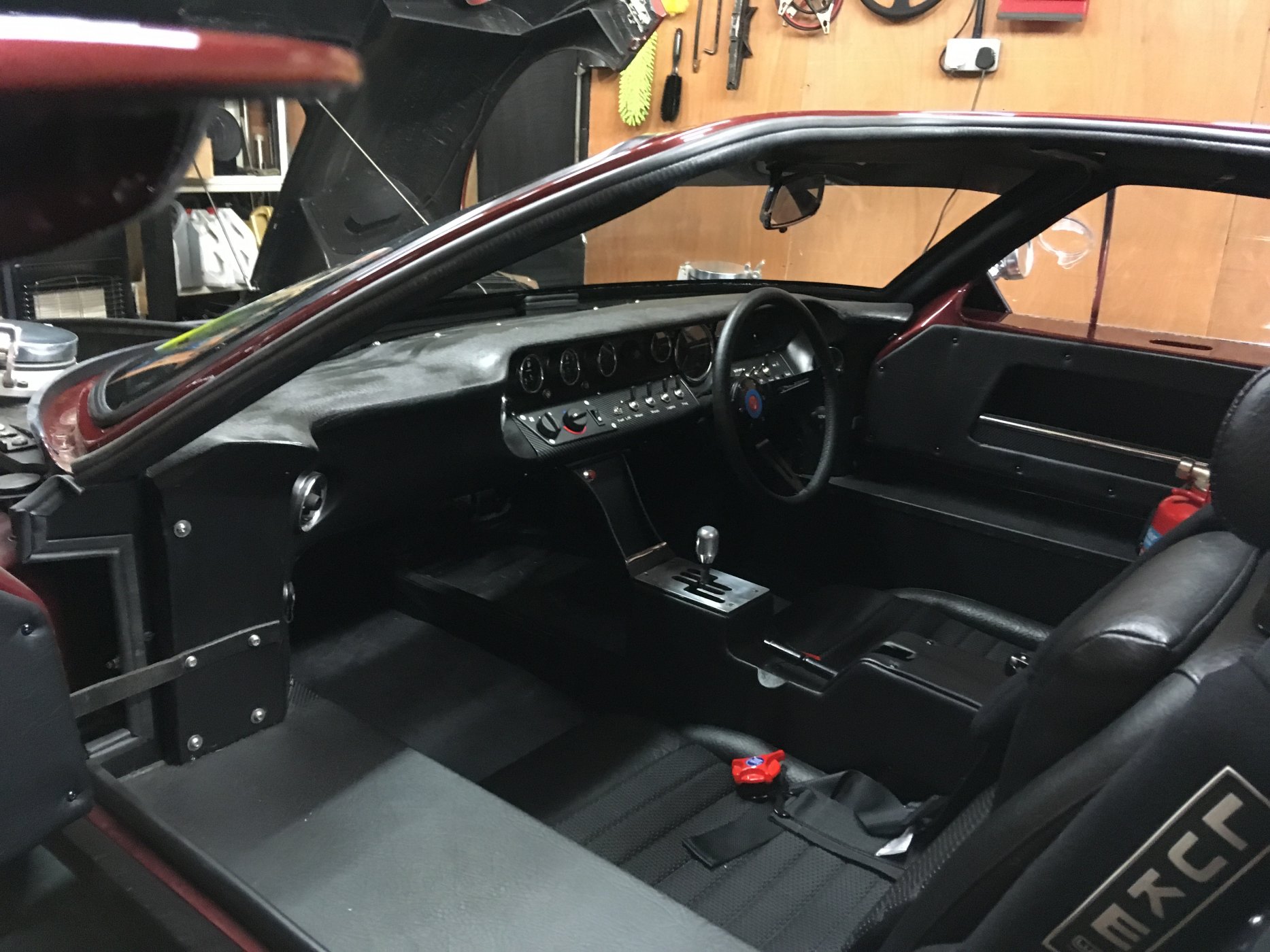

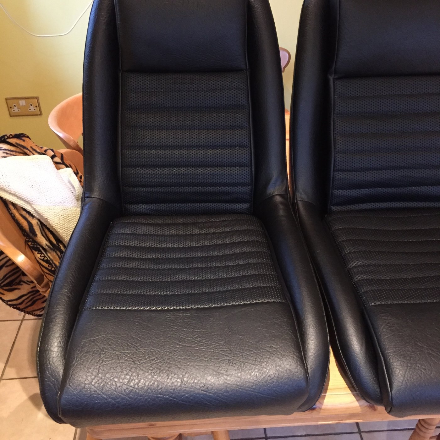

I used an old tatty pair of high side Corbeau cloth seats, modified the steel frames, reducing the high sides, moved the floor mounting point up to get the seat lower and then a good trimmer to finish the job off.
