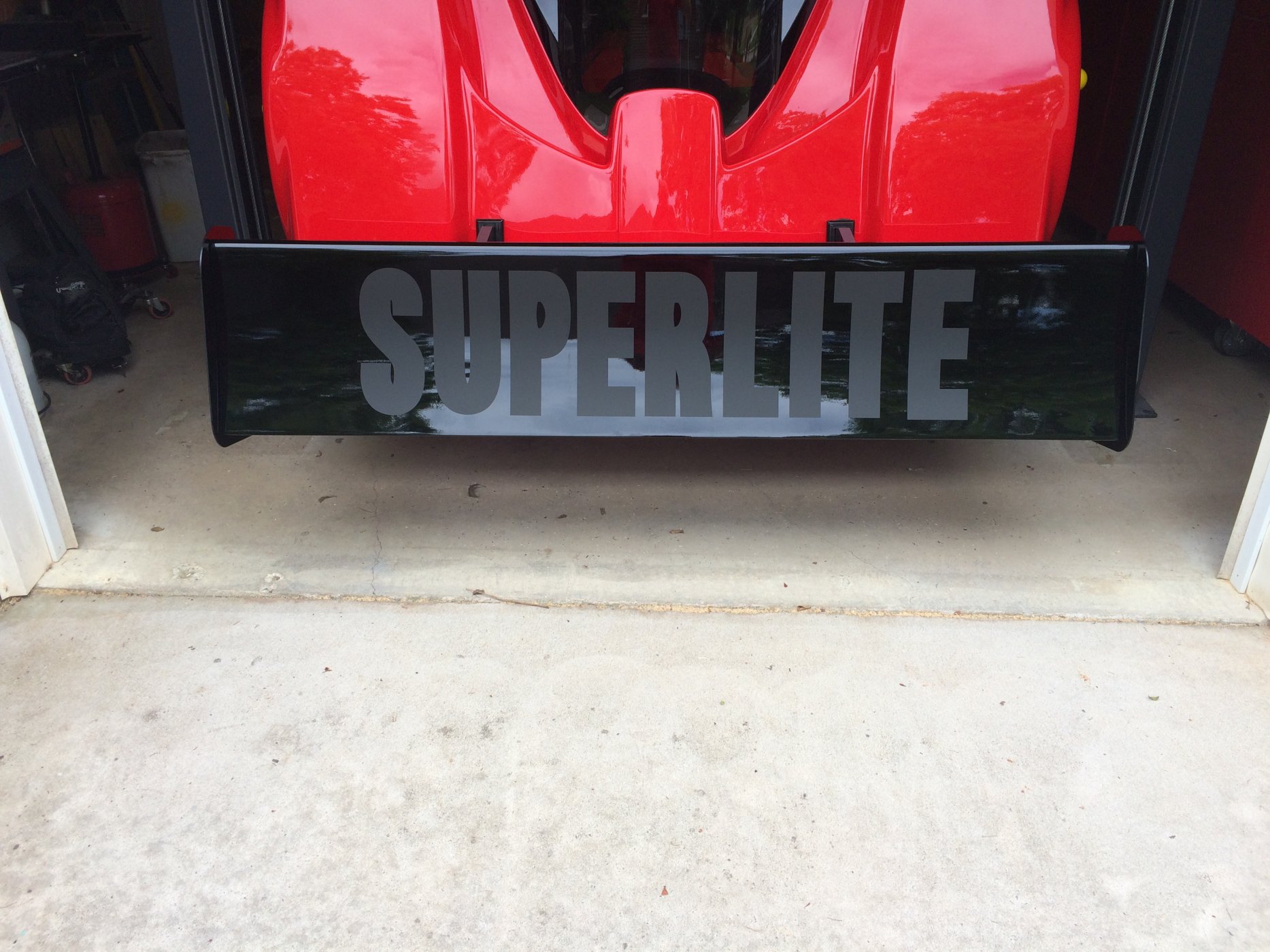

Here’s a teaser pic, I wanted to get the car all together before showing more of the in-process stuff. Now that the family is back my garage time shrinks once again.
