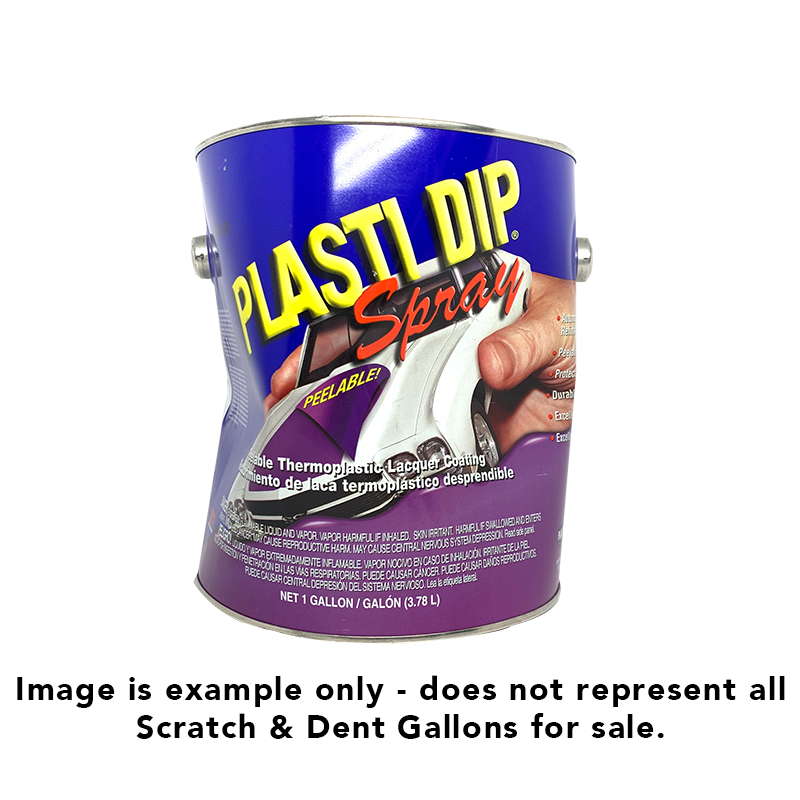

You stocking up on the DYC scratch & dent sale?
Lol - it's a great deal! But I'm already stocked for at least one, possibly 2 more colors ... :rolleyes:
Yep I remember you saying you bought a few different colors to try out. I still have a gallon of camo green that was the next color for the bike, but sold it before I got to do it's 9th dip. :)
