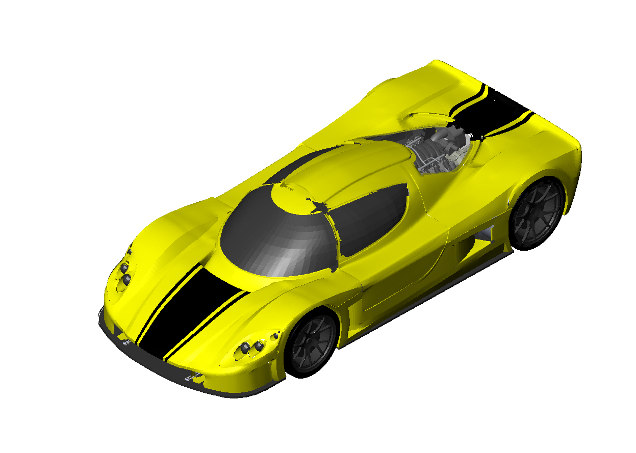

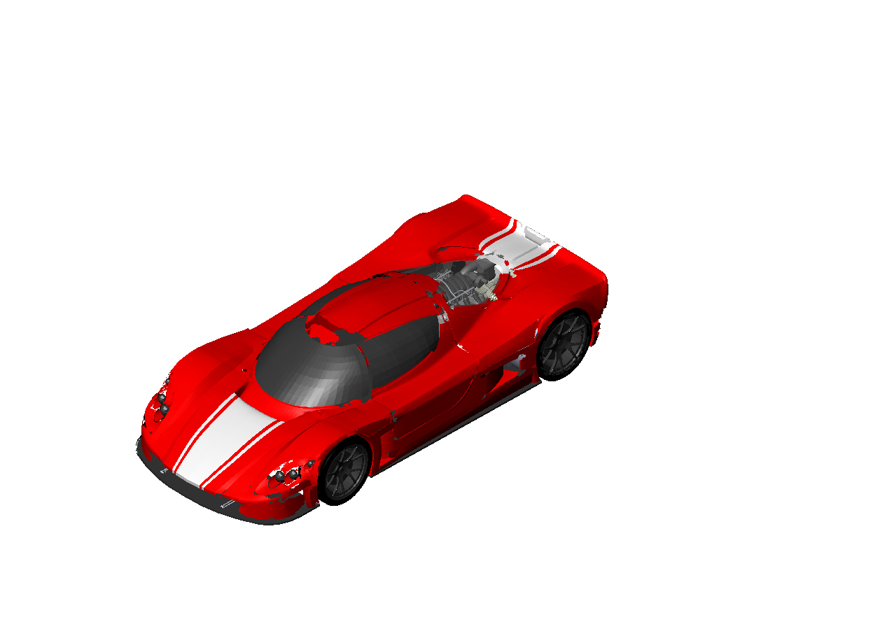

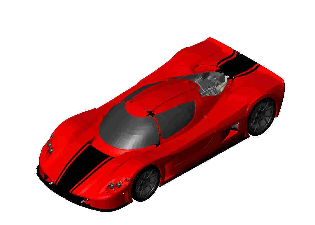

Here are the three options I am mulling over (not to hijack your thread, if I am, sorry). Ignore the curves on the rear stripes, they would be straight up the rear clam in real life (best I could do in Solidworks).
While I love the fact that you can more easily change-up color schemes, I’ve never been a fan of satin or flat paint jobs...

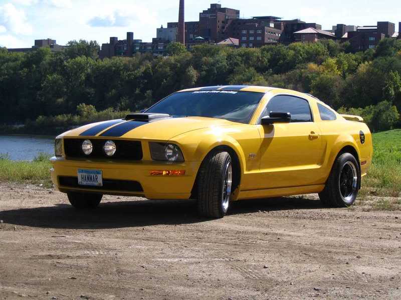

FWIW - I love the shade yellow as I had one of my favorite Mustangs in ”screaming yellow”... But so did all the bees, wasps! Seemed like I was forever being hounded by them....
