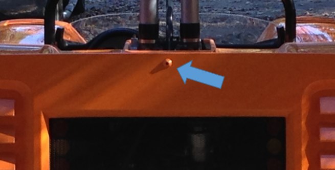

I utilize a back-up camera for the McLaren project, but keeping the surrounding light off the screen (hidden under the door, but still visible in a normal seated position) to where I can actually see who is on either corner is another challenge (for you open cockpit guys). I played around with these super small cameras on the sides of the roll hoop for quarter-view awareness, but in the end, didn't feel I needed anything more than the fender mirrors and the back-up camera.

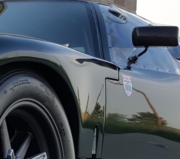

After playing around with them I just didn't like the look of the fender mounted options so I hung some convex CIS GT Racing mirrors from Pegasus off the door. On the plus-side the housing is quite large so it provides excellent visibility (I can see 2 lanes of traffic on each side plus right behind the car). Downside is the housing is on the larger side (at least compared to the APR mirrors most of us used on the SLC).
I think the mirrors look okay on the car and don't break any body lines - i.e., not too large. What does the internet think?

Color contrast may be the key. As it sits now, they are almost invisible, and look fine. I'm not totally "into" the fender mirror look either, but after a year with them on the car, I am much more comfortable with that era's look for mirrors than I think I would have been with the more modern mirrors.
