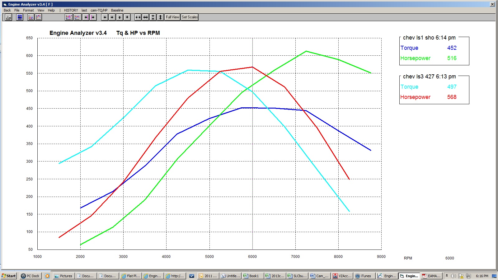

On the motor I am still deciding on the LS1 block and heads, LS3 with LS1 heads or LS3 block and L92 LS3 heads. I purchased an engine analizer software program so I can play with the different items I want to have and see which combination is best. If anyone wants me to put in their engine specs I can see what the hp and range comes out to be. It has a nice optimaztion view that lets me know what would be the best size exhaust, etc so I can play around with it.

I just put in the specifics for my engine. With an LS1 block and fully ported head with 2.02/1.60 I get 617hp at 8,000rpm and 455fttq at 6000.
Now with an LS3 block and LS1 heads same as above. 642rhp at 7500rpm and 500tq at 5500 and 6000rpm. So about 30hp for the LS3 block and this makes some sense as the bigger would make more, but it is 9% larger so you would think it would automatically make 9% more power, but there are many many other factors to consider.
Now with an LS3 block and L92 heads ported I get 648hp at 8000rpm and 500tq from 5500-7000rpm.
So this makes me wonder why the larger heads do not do as much. Well the exh valve size is the same and maybe that is part of it and also the velocity in the runner at the higher rpms can cause it.
So this tells me that the LS1 block and heads will be more than enough power for me. Revving the engine helps with hp numbers for sure. 617hp is a nice sexy number to me. I am glad I got the program now as it will save me the money I thought I was going to get for the LS3 block. The LS3 did have more in the mid range and below vs peak power so it would be better there, but at what cost though? If I can find a block cheap enough then yes, but at this point the LS1 5.0L should do me fine.
BTW- having the standard long runner intake versus the custom 5" short runner intake made like a 75hp difference from mid on up. It was huge.
Here is a pic of the graph of the LS1 vs LS3 flat plane short stroke.

I think they might be a little high from what I know, but not all that much. I am reving the piss out of it and the higher the rpm the more hp, but less torque. So it is all relative. I am using a custom short runner intake. At 6000 rpm I would make around 500hp and that makes sense since it is fully build with nasty cams. If it was regular engine I would have a longer intake and make a bit more down low. Shoot, if I make 500rwhp I will be happy at this point. But the numbers might be a little higher, but if I change one thing or another it should give me an idea of what is workign better or not. I will also have the sold roller cam with Jesel rockers.
Ken. I just put in these parameters for the 427 so let me know if it is correct. 4.1 bore 4.0 stroke, 6.0 con rod, stock bearings, LS3 head, 2.16I 1.60E with like 270cc and good flow, 11:1 compression, 234/242 cams with .602/.615 lift, stock intake that is about 90% efficient with 10" runners 2" diam, exh 1.75 ID 19" long 95% efficient using a tube header. I came up with a max hp of 566. This is right in the ballpark of what your engine guy said and makes sense and had 539fttq at 4500. The reason I am making more hp is that I am revving higher. Now, in reality your engine is more powerful, has more tq and should be a much faster motor. HP numbers can be deceiving when just looking at that alone. Your engine will have 100tq more so that can be much better.

Ken, when you said AI LS3 I assumed the 270cc runner. The rest I pretty much guessed correclty. I had the bore a tiny bit off but had the cubic inch volume correct. On the header I will keep it as a tube type assumption because the LS7 ones are supposed to be really really good. I get the same basic numbers 557hp and 547tq and as your engine builder.I am also thinking you might only rev to like 6500 because power drops off and piston speed is 4333 at 6500 and 4667 at 7000. My piston speed at 8500 is 4515. That should be a nasty nice motor and it looks amazing. So I am starting to trust this program a bit more now.
I also adjusted the intake length on mine to get more hp average, under the curve. The Max hp went down to like 595, a 20hp loss, but overall better mid range and only hurt at the very very top. Things like that make the program worth it to me when I am designing and make the intake, header and other things.
If anyone has all their engine build info and want to throw it over to me let me know. I can put it in. There is also an optomize option which lets me know what some of the specifics are best.

Thanks for running the program. Seems fairly accurate. My goals are for a track days type of car that can also easily be driven on the street with not too much difficulty in creating the tune. Reliability and longevity was also considered.
