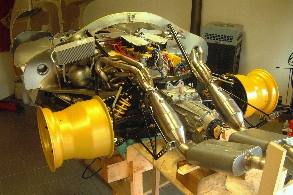

Hi guys,
thanks for your encouraging answers.
Tom,
1) The wheels shown are my own design; Accordong to design they weigh short of 0.5 kg less than the aluminium wheels and additionally have less rotational inertia. I made some of the pieces for those wheels myself, but not all (including some of the tooling), most of them are way too big for my machines. The most difficult part in fabricationg those is figuring our how to minimize distortion. Runout of the wheels shown is very satisfactory.
2) The quill shafts shown are the drive shafts (gear box -> shafts in the rear uprights), they look a bit different than the typical ones because of the higher diameter between the splines. This is because they are hollow, designed for equal strength at the splines and between them. They are quite lightweight.
Best,
Leo
Very glad to see you're back! I have missed your updates quite a bit!
What gearbox are you using?
Do you plan to have your car road registered?
Please, tell us MUCH more of what have happened in the last years!
Olivier
Hi Olivier,
The gearbox we're using (see pictures) is a Quaife ZFQ, as sold by Chris Melia.
We are looking to get the car road licensed, this however will be a tough test to take with the strict regulations here. We'll see how it goes.

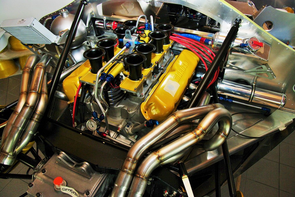

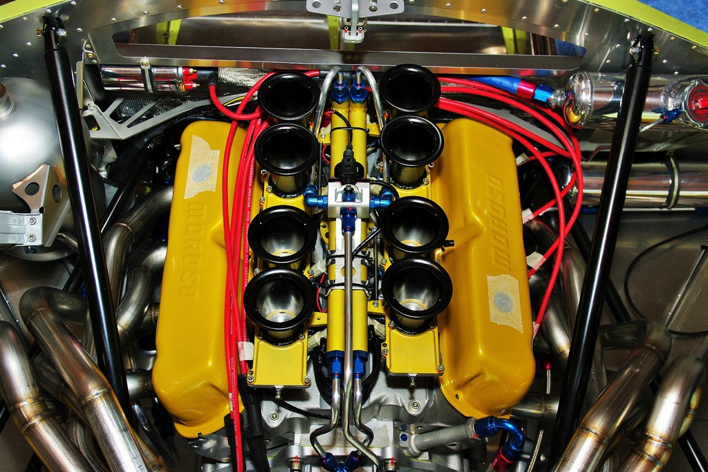

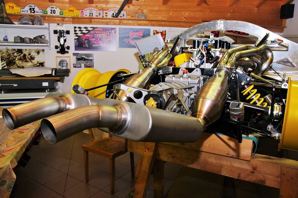

Hi guys,
attatched you find some more recent pictures of our project. All of the structural hardware is done, currently we are dealing with the wiring, systems testing, and some minor fabrication work.
At this point I want to emphasize that our car is built to look externally similar to the 1968 built Ford P68, but on the inside it is a re-engineered, yet unofficial successor. Therefore, we feel that it should have its own name. Since our monocoque was finished in 2013, and in accordance to the designation of its predecessor "P68", we will call it "GTP-13".
I hope you enjoy the pictures,
greetings from Austria,
Leo

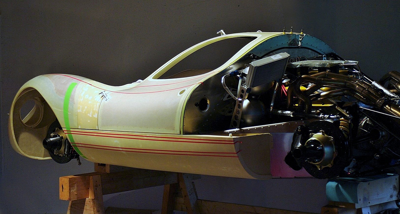

Gentlemen,
following you find a quite current (three months old) picture of the GTP-13, prior to painting. More current photos are coming soon.
attachment.php
Best regards,
Leo.
