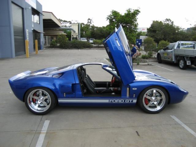

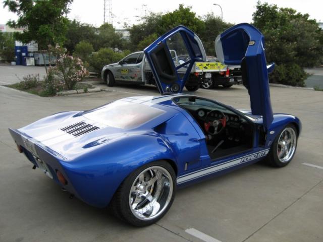

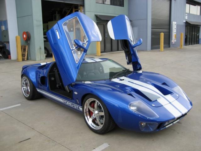

Photos of the GT40 replica we did with a scissor door(Lambo) conversion.
You really can't use anything off the shelf to get the best result. We wanted to do a conversion where it would give you the same access as if you did not have any doors fitted. A lot of scissor door conversions actually make it more difficult to enter/exit the vehicle and that is a result of door shape and hinge design.
We did some mods to the door and guard as insurance for clearance, but these were not required in the end.
Not for everyone, but it really did work well and all involved were very pleased with the result.
Certainly not a project to be taken on lightly.

As you say, it may not be for everone, but I think you did an awesome job on it. It looks perfect for those that haul theirs, around in a small enclosed trailer. It looks like a job well done Craig.
Regards Brian
Alan, I will need to dig them up as they have been archived off my computer. I have only kept finished photos of that GT40 on my computer.
The scissor hinges were also fitted in such a manner so that the doors could be swapped back to standard hinges and normal operation relatively easily.
Thanks for the compliments, the hinge mechanism looked impressive and was finished off as well as the rest of the car.

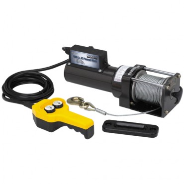

Funny you should mention that because I have just such a scheme in my two-car garage/shop, but for a different reason: there is just enough of a slope to my driveway that I can't necessarily push a car from driveway into garage by myself. Harbor Freight 96127 $140. And it plugs into the wall. Bolted to the floor at the back of the garage with expanding bolts in holes drilled with a Harbor Freight hammer drill, of course.
Now, as to making it reversible. I thought a lot about pulleys and shuttles and things like that but have never been able to work that out. What's needed is a separate takeup spool on the same axle as the existing one, and then you could just string rope through a pulley at the front of the garage and attach to the middle of the rope. But I don't see an easy way to modify that winch because the clutch is right where you'd want to extend its axle.
The brute force method would be a second winch off to the side running through a pulley allowing the cable/rope to make a right angle turn into the garage and then run them together. Bleah.

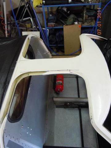

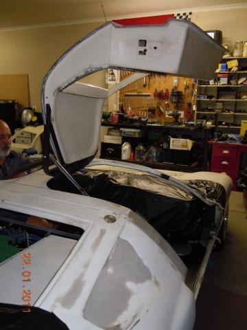

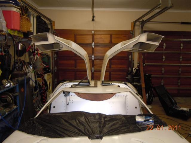

It works ! I have attached some pic's of the project and this weekend had the actuator in and works like a charm. Need some 10 inches on the side for the door to open - (so no more winches). Both doors are in and the right hand door is fully functional - need a lot of fibreglass work now.

HI Heinrich
Forgive me if I am stating the obvious, but can I suggest that you check the screen for fitment at this stage. Looks like the front top of the spider is a bit skew in the last pic.
