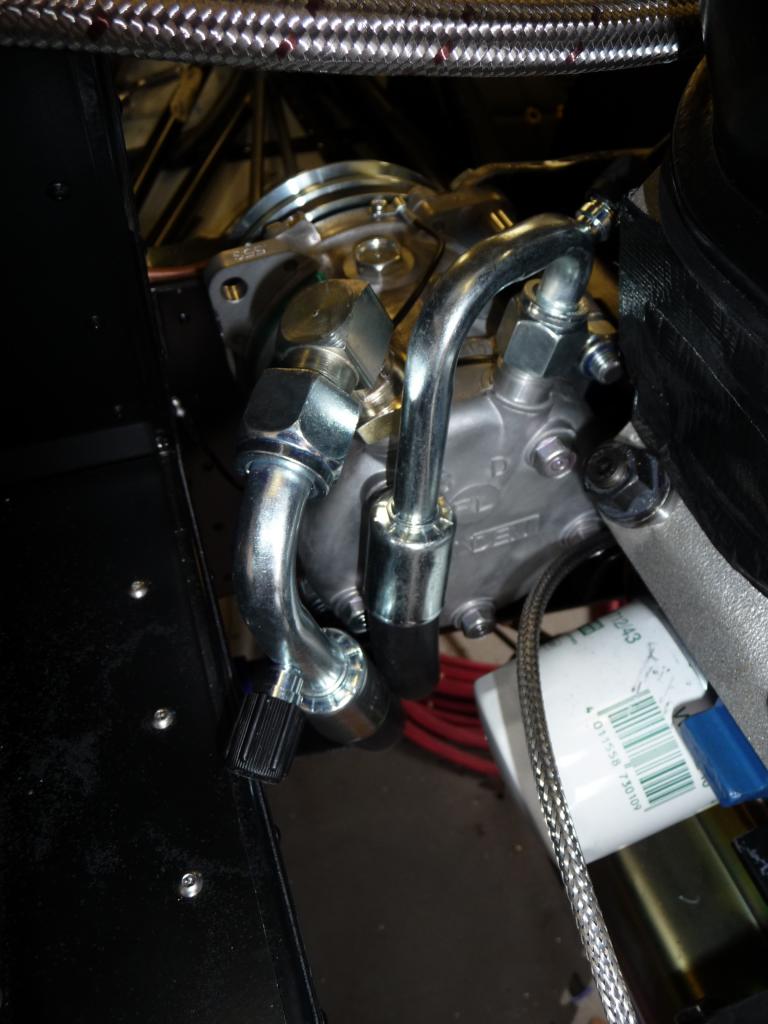

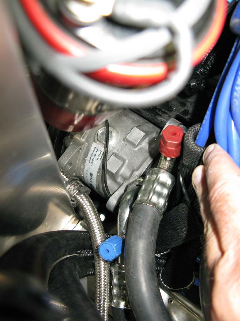

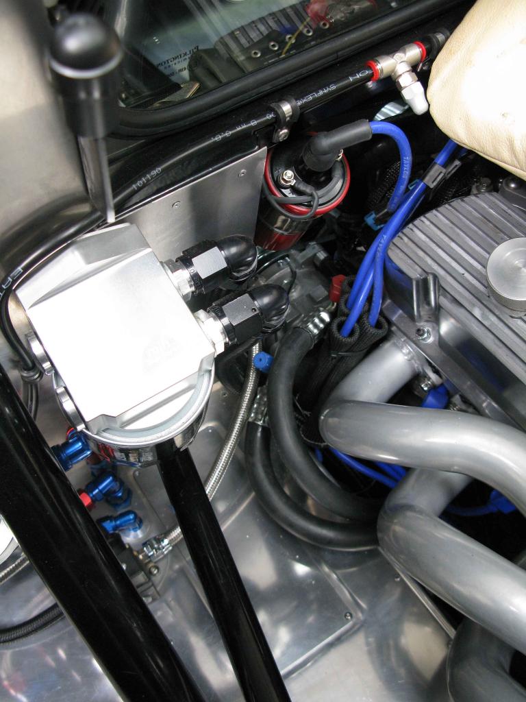

These are the air con filling connections that are built into the elbows that come out of the pump.
As you can see there's not much room in this area but just enough that nothing fouls the exhaust system, heat resistant boots cover the plug leads where they get close. I may move the leads later as I will most likely be fitting a turkey tray heat shield around the injectors, but for now there ok.

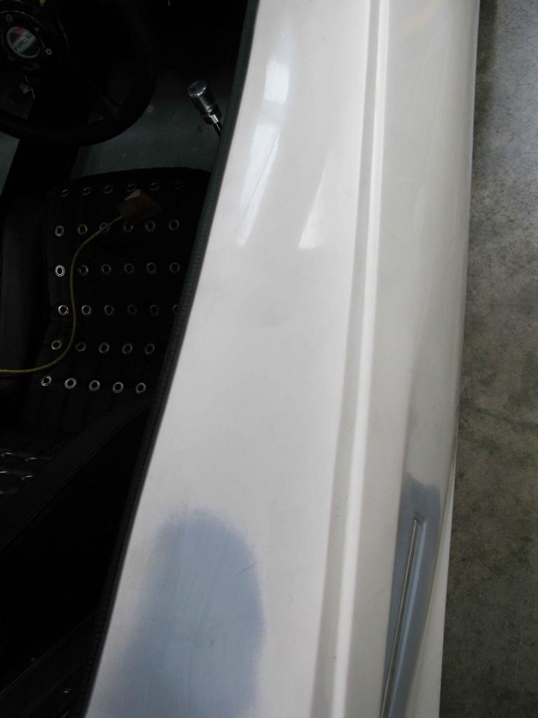

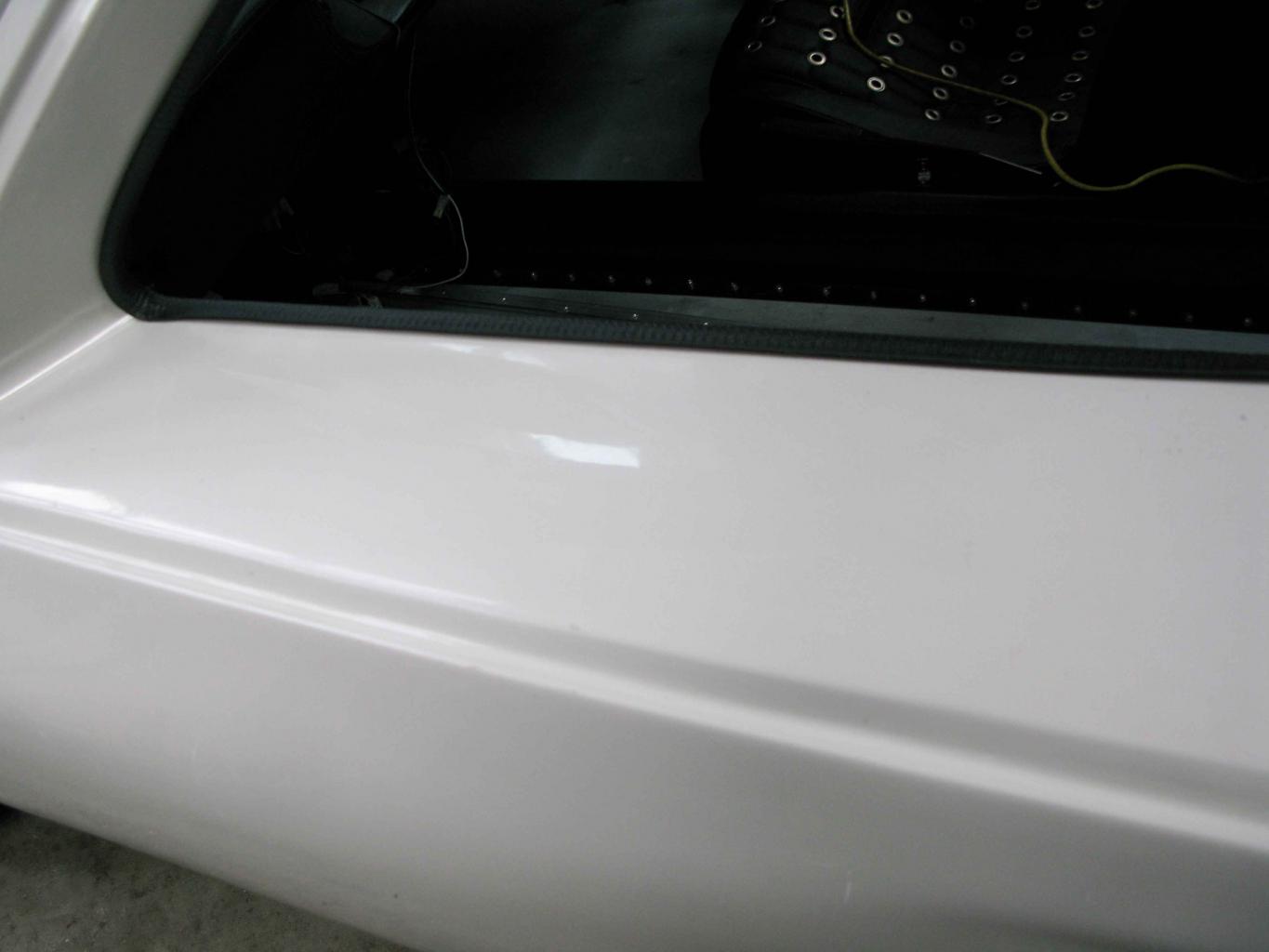

Removed some parts that are not to be fitted for IVA.
And the alarm man has gone on holiday so I had to do the wiring myself but it seems to work a treat.
Fitted the new plugs and straight away it was crisp and responsive
fitted plates over where the grill goes
That's it for now
I'm doing no more, just got to wipe the body over and load it on a transporter.

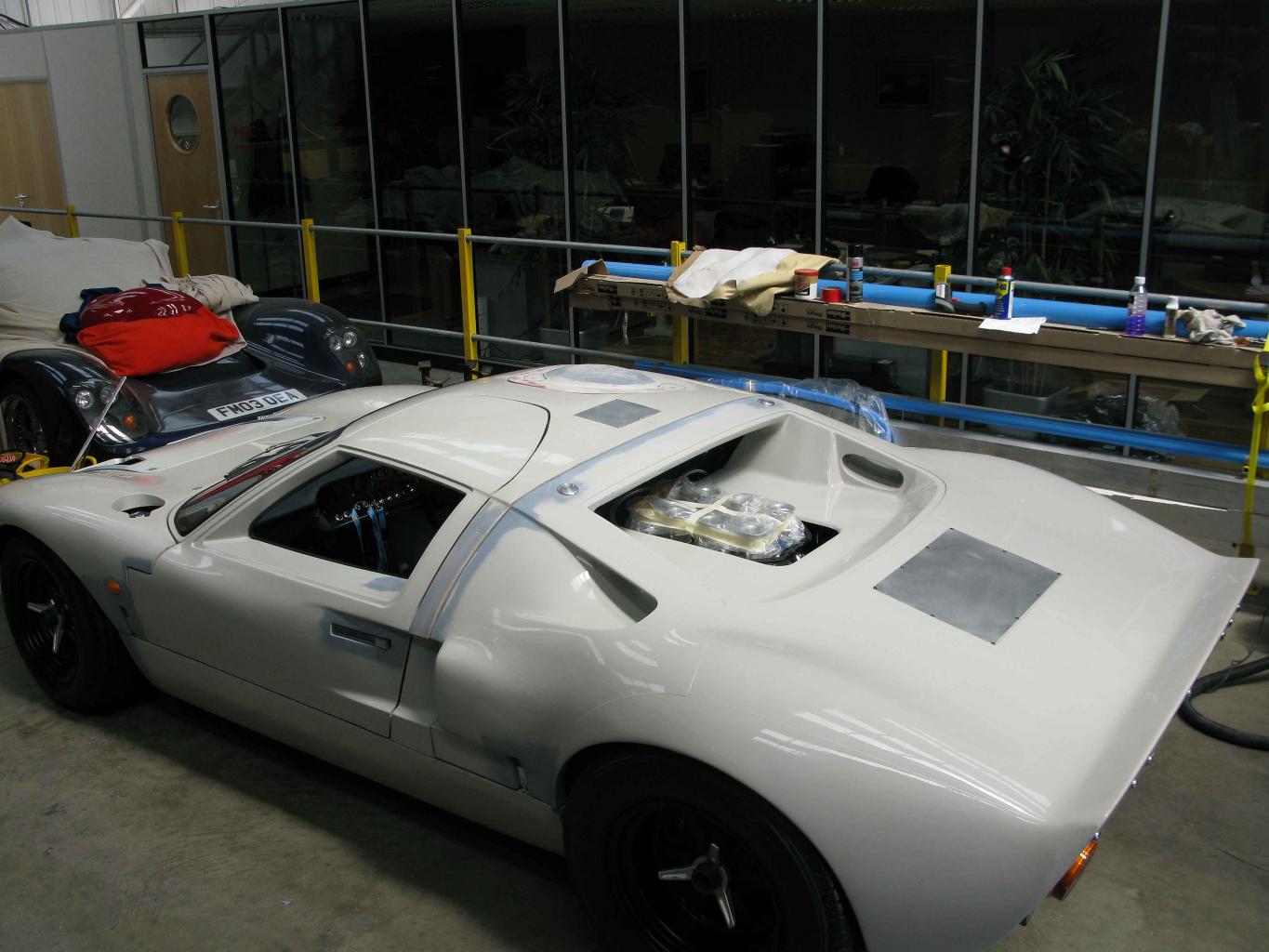

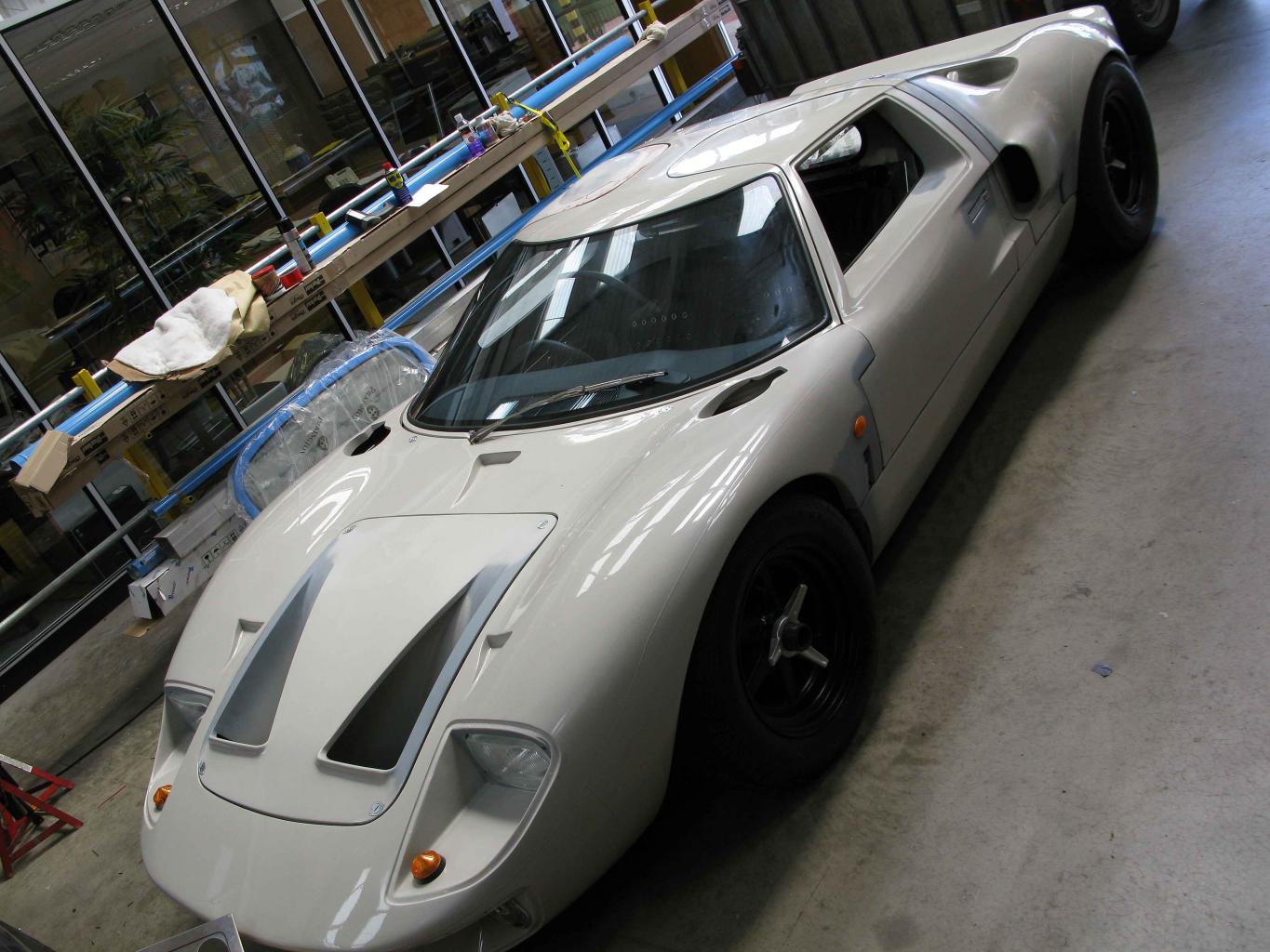

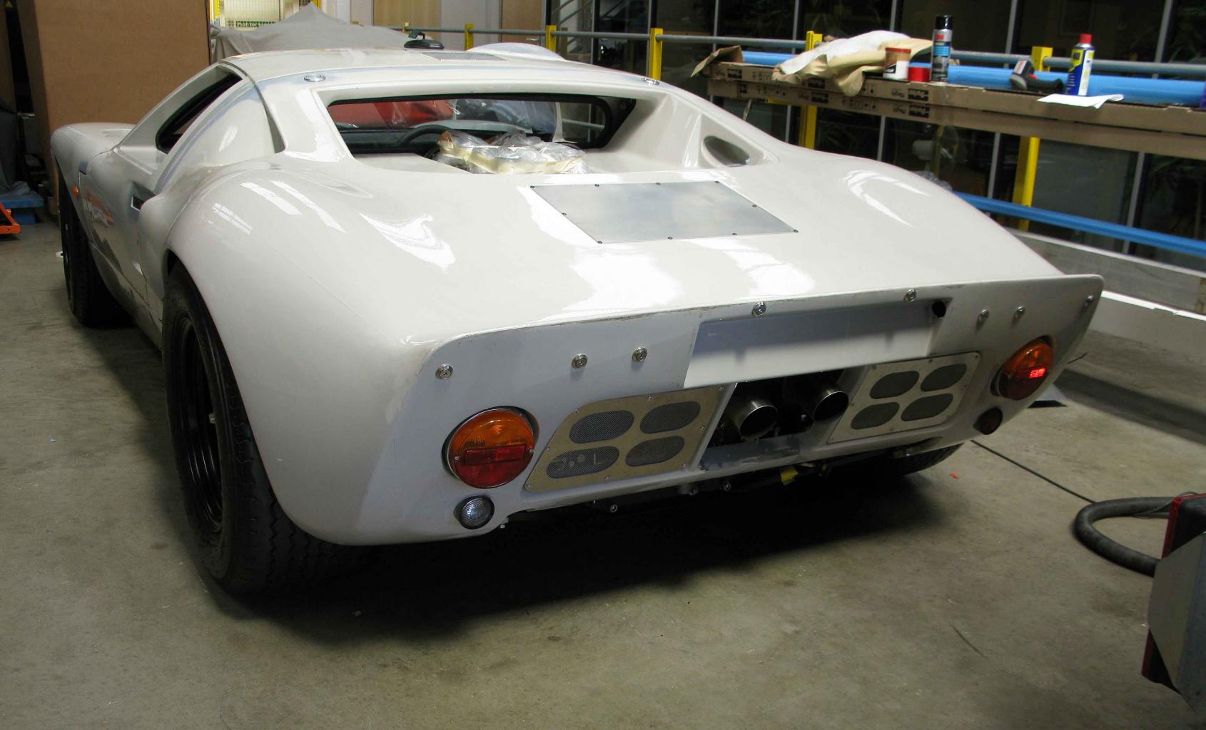

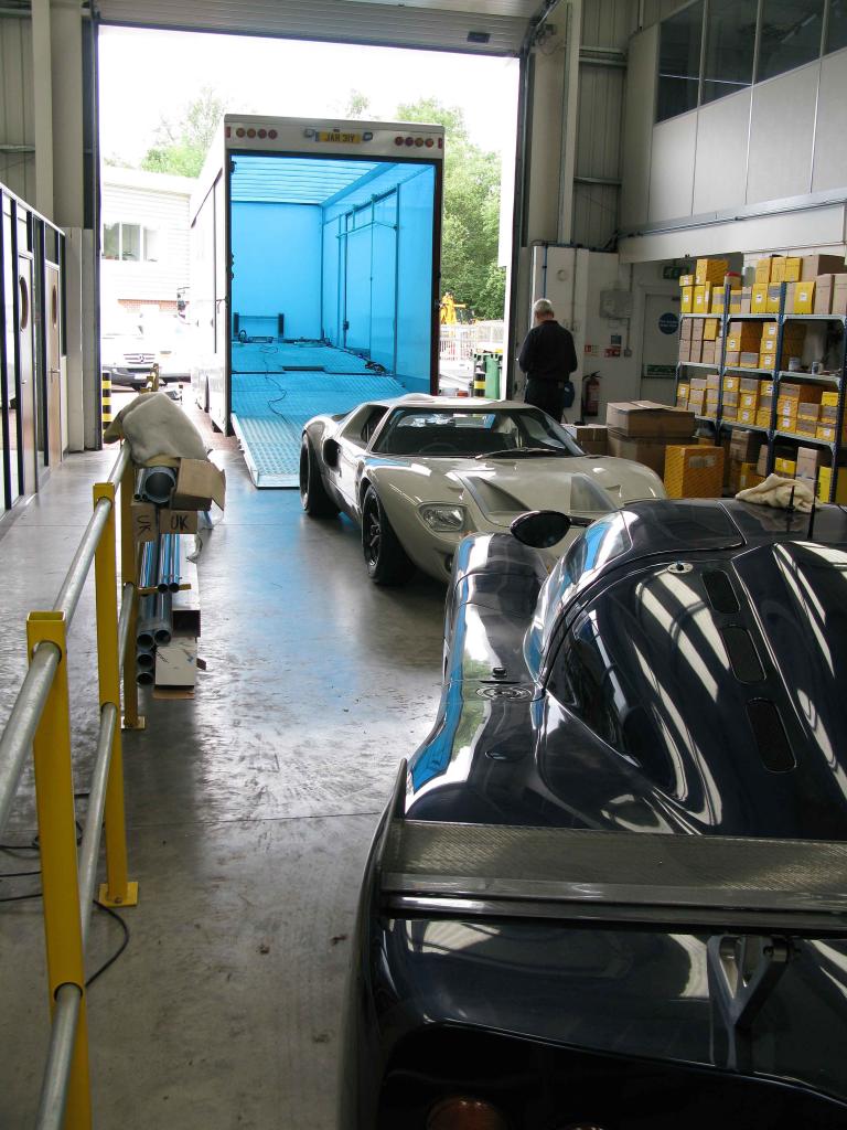

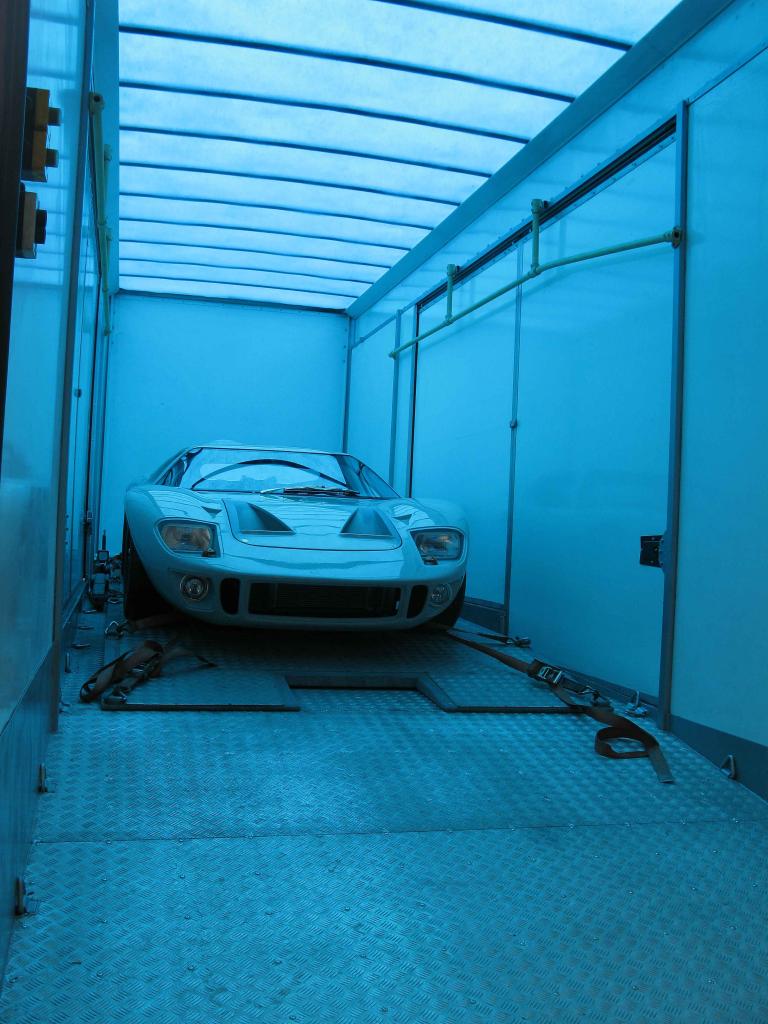

Car collected today.
Bit of an over kill.
Transporter could take 3-4 cars and mine was on its own.
