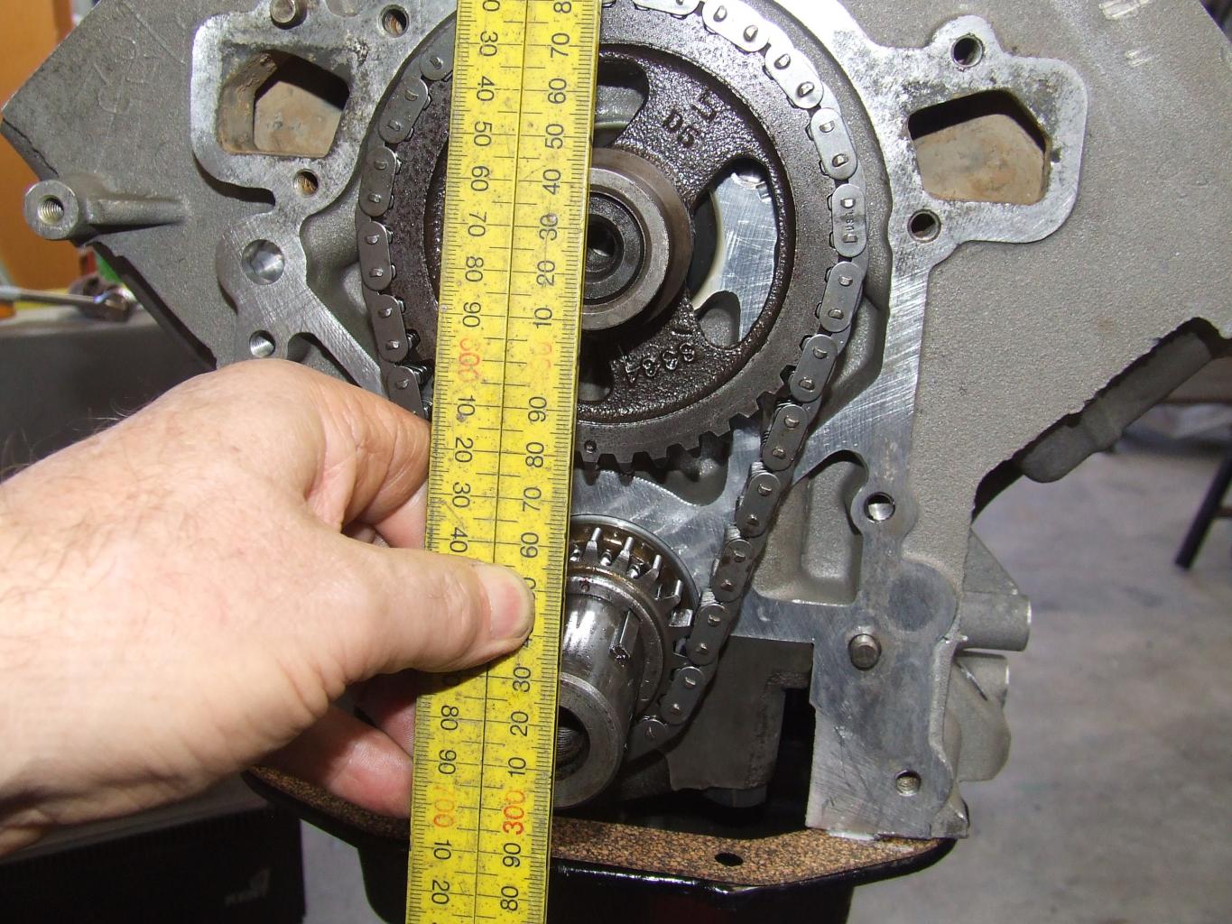

I managed to fire it up without too much drama after some timing issues. Double checked it again by hand rotation with the no 1 inlet opening then closing to TDC with timing marks agreeing. It started but was off song song so rotated the dizzy to get it running a bit smoother.(Not sure if its just the Crower Cam) Once I had all systems running, I then checked the timing with the strobe and it appeared miles out...and when I tried to rotate the dizzy closer to the mark, it ran rougher so left as was to run in the cam. Water temp was holding well at 85 deg, still don`t trust these electric pumps so will get an infred temp gun to check things even though it has good water flow. Its hard to tell if things are hot when you have a bunch of hot extractors radiating away. First start up is always anxious as there is all kinds of smoke and fumes from Hi Temp paint and exhaust wrap, once all that burnt off it was a little clearer. What sort of temp should one expect to see around the

Russell, well done, I'm always lurking and learning in the background here but your small timing issue reminds me of when I changed a timing chain case, and discovered that the timing pointer location was about 1/2" away from the original. Just in case.
Dave
Dave, thanks for the comments, i feel pretty sure that I am all lined up...even took a picture to remind myself. Once I talk to my Carby guru, I will run it again.

Hey Jac i dosnt look like he has an option with the crank pulley he's got, cant see any other keyways. i know with mine the "dots" were way off the mark.
kaspa
Always options John, in this case offset keys at either crank or cam, preferably camshaft can be used to correct any errors.
Yes thats true Jac, I also noticed its still a single row chain, and i know from personnel experience their notorious for stretching even with a stock cam, valve train, i fitted an after market double roller in the boat motor i had and never had any more issues, some thing you might want to consider Russel. as they also have multiple cam index key ways.
cheers Kaspa
No, its a Morse chain, very good stuff and not to be confused with a roller chain, a lot of folk think they are crap as they usually see them after a couple of thousand Km, but they self compensate for wear by design and if you ever take the time to pull a stuffed one apart you would think quite clever really. The 'real' problem is some manufacturers made sets with keyway machined in at 4° retard to comply with emissions standards of the day and if you get one of those sets and fit without checking you get that unrequested retard of cam timing.
