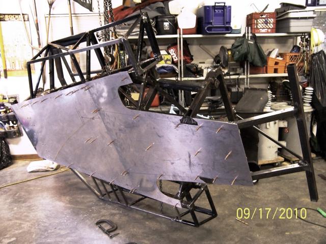

2) The 15 mil tape can be used on side panels where no other parts are being hung on them or putting them in a static continual one-direction load. What I like about this is the combination of reasonable grip (if sufficient area is employed), and sealing capability.
3) The tray panel under the car will use adhesive (pre-drilled, clamped, and then riveted in the existing holes after clean-up). I've also got several aluminum to aluminum bonding areas (brake pedal assembly mounts and bosses) that will use adhesive and rivets.

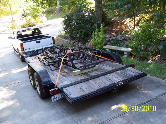

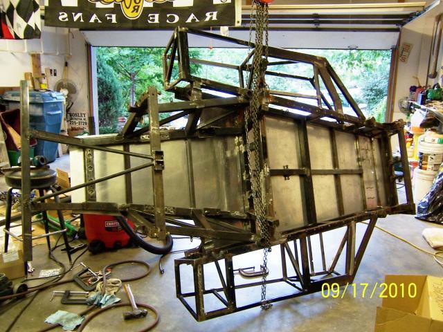

Funny (strange funny, not humorous funny). I'm picking up the frame from the powdercoater first thing tomorrow morning. I'll send an update after I get it back home. This powdercoater business has had a sketchy history, but has switched ownership recently. The guy who bought it recently appears to have some good business sense, and has been in this business most of his adult life, really wants to turn the business around, so I rolled the dice and took it to him ("let me see how hungry he really is?"). Tomorrow I'll find out if that was a good choice or bad choice.
What is really cool about this was it took essentially eight hours to completely strip the frame of everything. Would take days on a normal car. Photos prior to the trip out of the garage with the newly added rear bottom tray under the engine and transaxle, some small SS mufflers (with a fabricated aluminum brace for them, and then off to the powdercoater:
