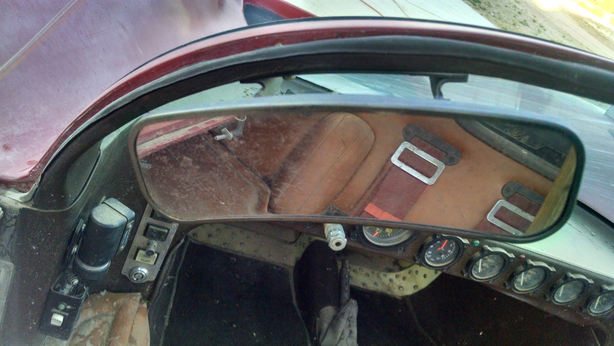

My red Manta Mirage (the original Santa Ana factory showroom car) used flat glass mirrors mounted on the front fenders but they were virtually worthless. Their basic problem was that they were small mirrors and, being mounted so far away from the driver's eyes, their field of view is tiny. To solve this problem, I mounted two slightly convex mirrors inside the cockpit, following the windshield hoop. These mirrors have a large field of view and solve the rear/side blind spot problem. The mirrors are metal so there is no glass to break in case of an accident. I found them years ago at an aircraft salvage yard here in Tucson. I removed them from two F-86 jet fighter cockpits. Yes, fighters need rear view mirrors too. :)
Here is a photo of the driver's side mirror. Sorry for things being so dirty- it was in storage for a while.

Yes, I am concerned that mounting mirrors forward of the cockpit will minimize their usefulness. Or they will give a great view of the rear of the car, but not so good a view of surrounding traffic.
I like your solution. Unfortunately there are no fighter boneyards anywhere near me. Although a road trip to visit one suddenly sounds like a good idea!

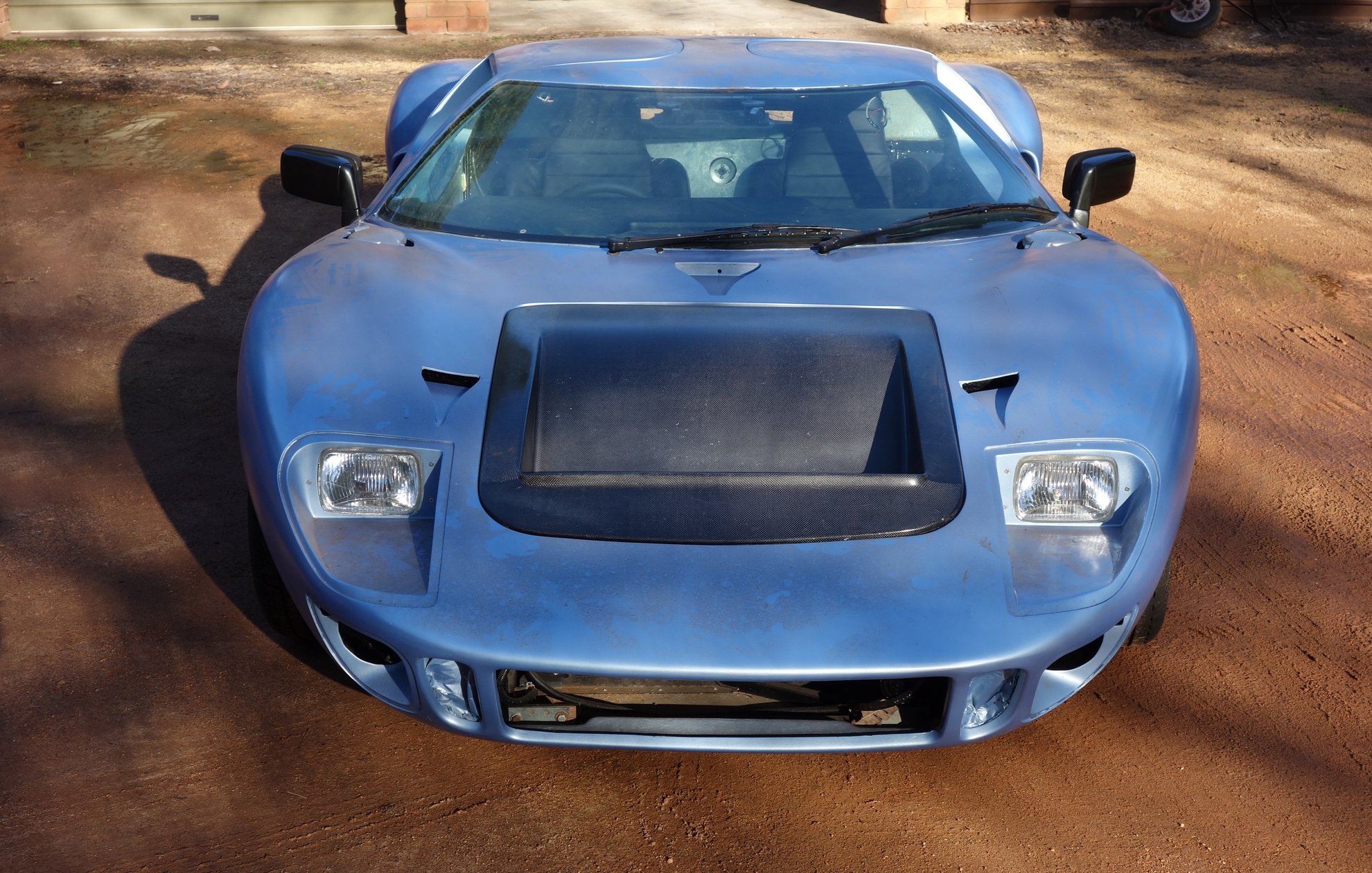

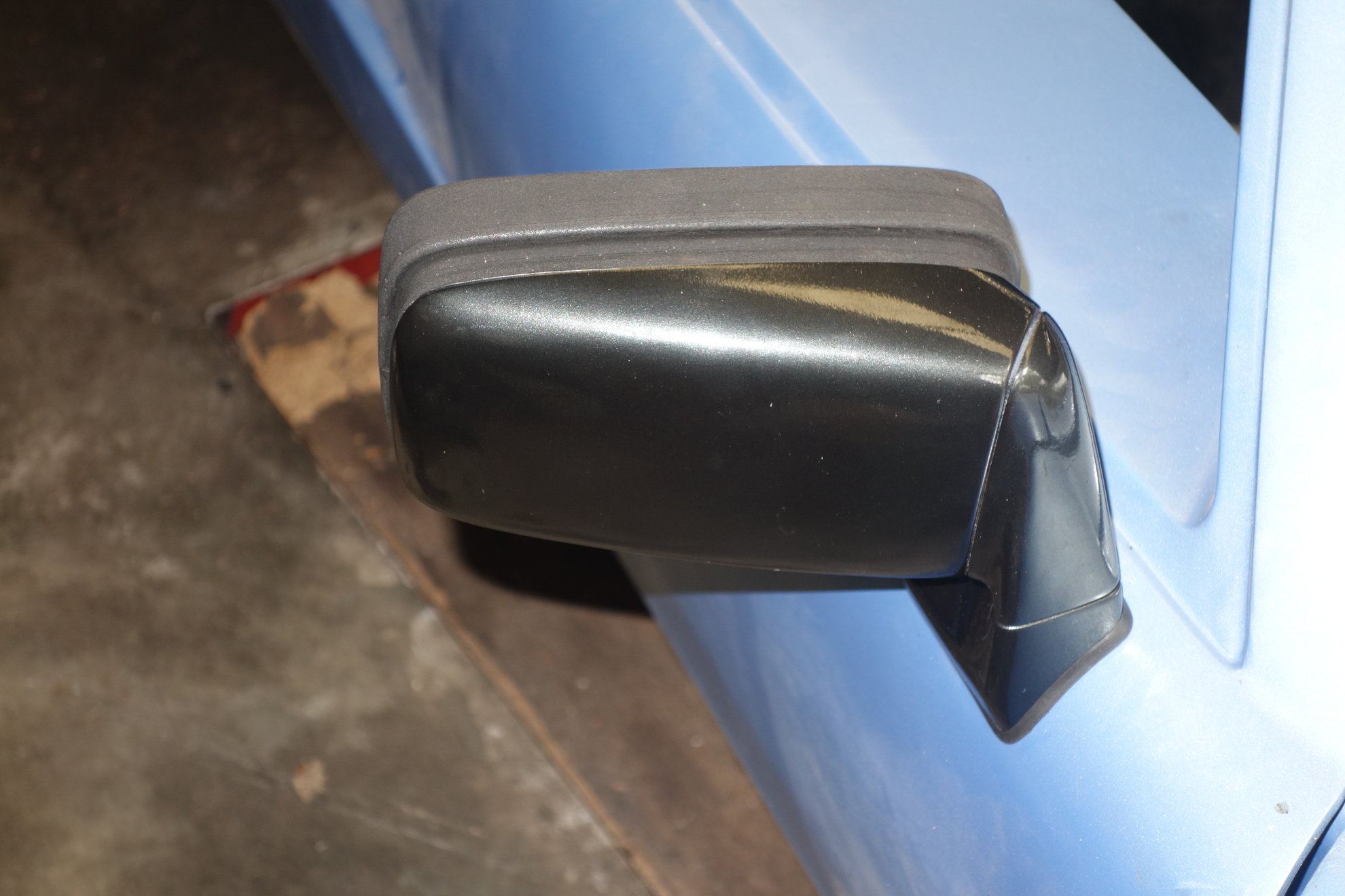

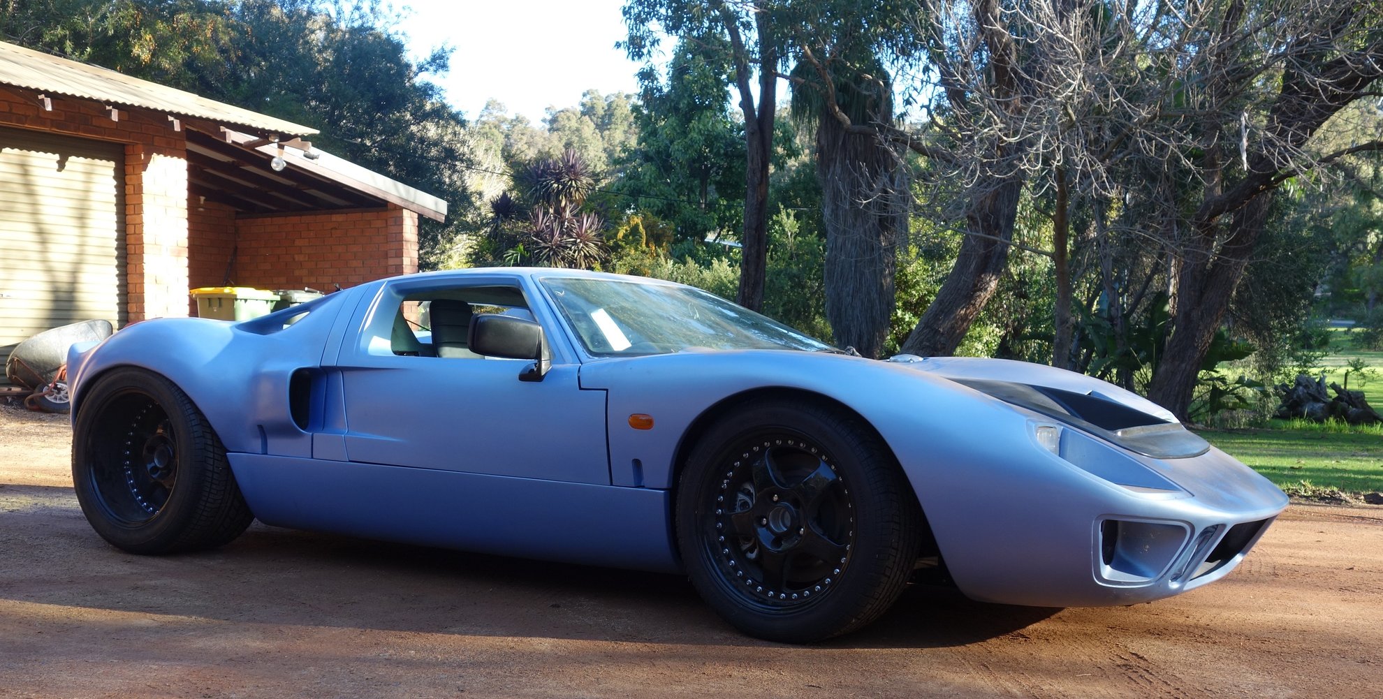

Doug, I wanted the same mounting, but due to a series of unfortunate events (installer turnover mid build) the message was lost and the mirrors got mounted on the body. Although not my first choice, I think the style works and the visibility is excellent (for a car like this). Here's some photos from outside and from inside out. A bit hard to appreciate the vision in a photo, but so far so good.
Cameron
That looks like a good solution to me.
I know what you mean about the miscommunication during the build. Seemingly small details can become an issue if not discussed with the owner.
Love your car, and thanks for the pictures!
Doug

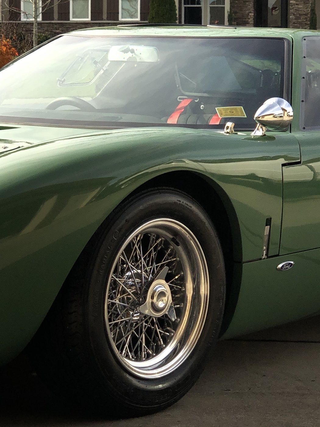

Doug, I copied and pasted the picture but then couldn't seem to be able to type. This is what I did, copied from Dave Collins who recommended it and sent me the mirror details. You could also search Daves' threads to find any info there.
Dave
The matching paint looks good.
The bracket looks to be very stout.
Nice, clean install. Thanks for the post!
Doug

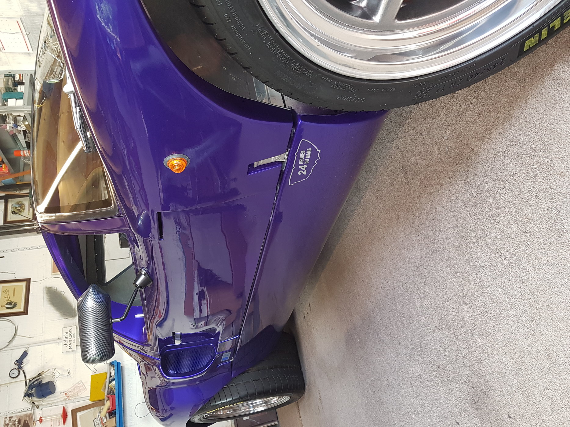

I mounted mine as per original. The passenger side (left) is more useful than the drivers (right). Outward visibility isn’t the 40’s strong suit. Just follow the “first rule”.
