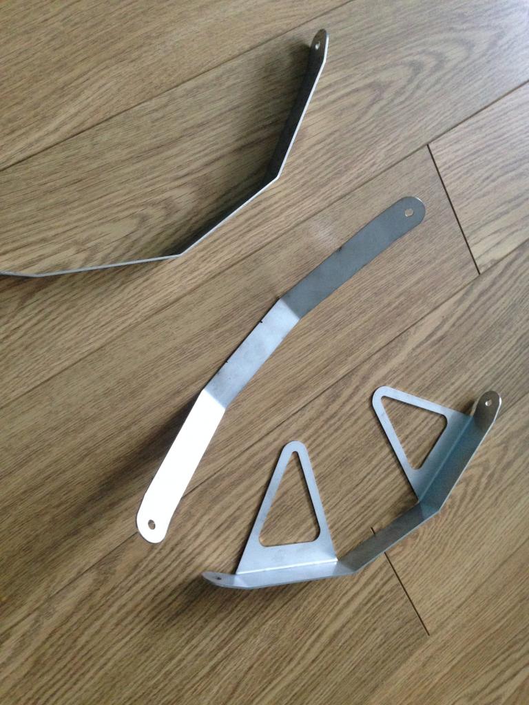

Two milestones reached Today. Firstly, the Fuel Tank straps that a small group of us GT Forte builders had designed along with the tanks have arrived. very nice they look too. Will be adding rubber to the insides where they meet the tanks.

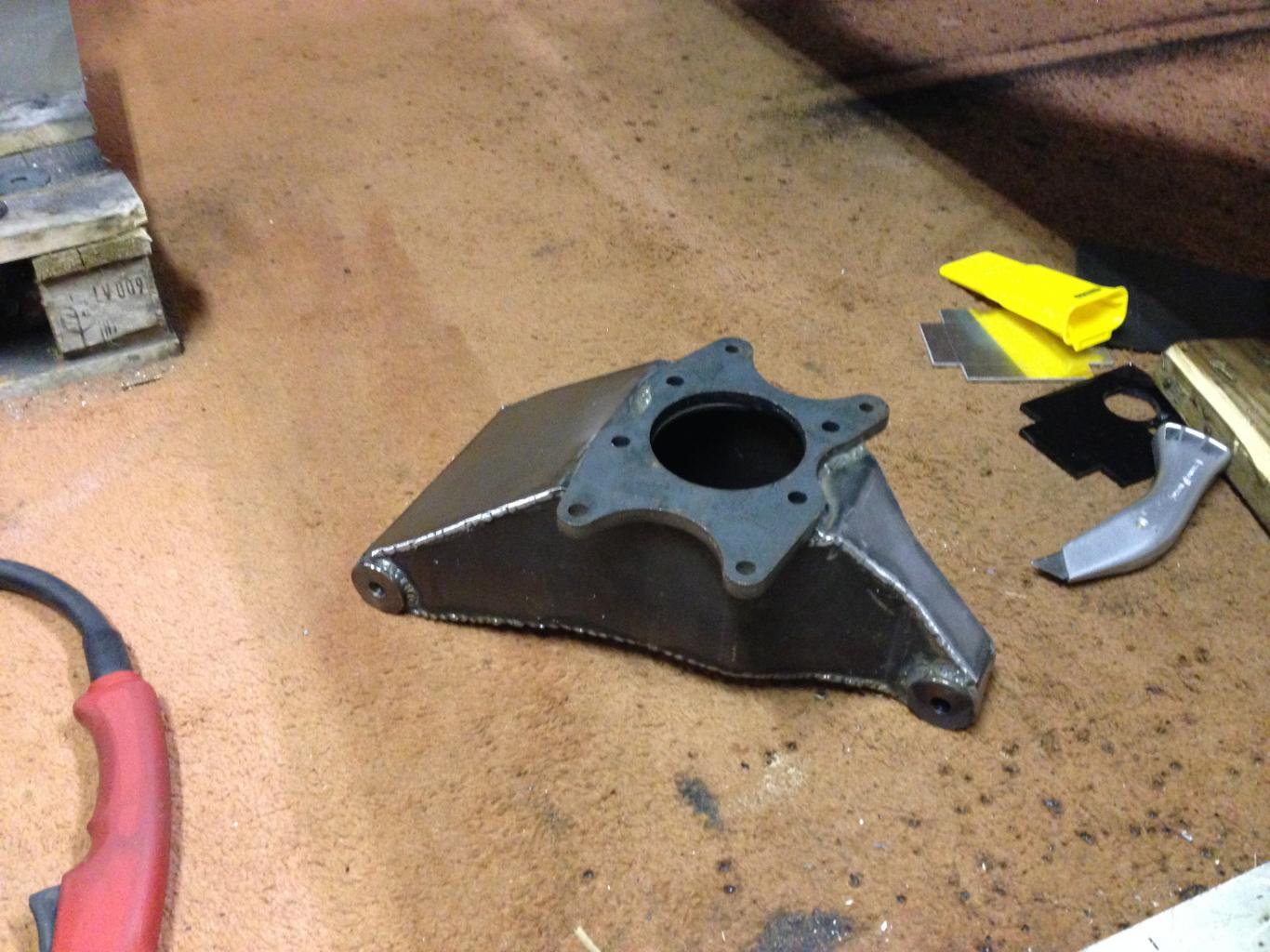

Secondly, finally took the plunge and had a crack at putting together the Near Side rear upright from the parts kit I purchased. Its taken about 90 minutes all in all and I'm happy with then result prior to power filing the edges back. nice to be working on 3mm steel plate and above as can crack the welder up a bit and push the welds nicely into the metal.
At less than £90 an upright, I'm more than pleased.

Very impressive Nick and unbelievably good value for money.
Yep, and the quality is good. Its all laser cut as you would expect and pre folded etc. Forget just how tough 3mm steel is after panelling with 18 Guage Ally for the last 3 weeks.

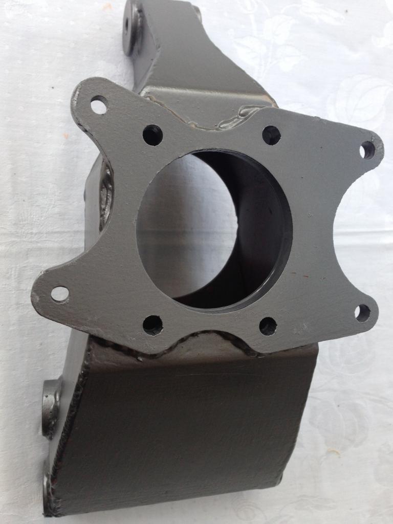

Quick update on the Rear Uprights, had to slow up the past week as my 91 year old Father fell and broke his hip. So car build took a residing back seat for a week and just a few hours here and there in between hospital visits.
Have completed to build of both the near and offsides now and have painted one to see the result. I went for a paint normally used to restore Alloy Wheels, it gives a dark Ally look although not too close as if your trying to make it look like Aluminium with the benefit that its resilient to chips, brake dust and the like normally found around the wheels. Has a Teflon non-stick frying pan kind of feel so hopefully they should stand up well. As I have the lower reverse "A" Frames already, I'll soon be able to mount the Uprights and then get to work on making the Top Links and Trailing Links. I've gone Rod End on all these so should have a nice flexible set up when I'm done.
All in all I reckon it took me 3 hours to make both from the kit GT-Forte supplied. Including the primer and paint (not my time of course) , I have two Uprights I know I can trust for the princely sum of £170.

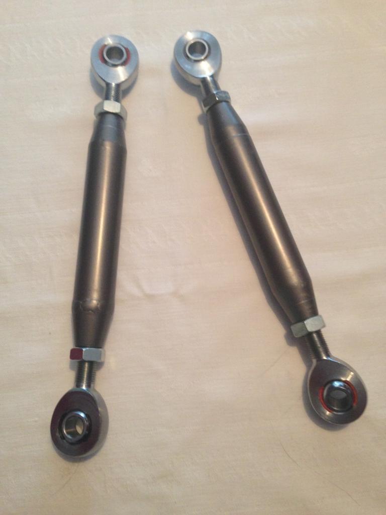

Now I have finished the build and paint of the two Steel rear uprights, thought I'd have a crack at the rear top links.
As I already have my lower reverse 'A' Frames, this will allow me to position the uprights from above and below so I can work out the correct dimensions for the rear trailing links.
The Rod ends are Left / Right handed on each of the top links for easy adjustment. I went for 1/2" UNF on the adjustment thread and they accommodate 7/16 at the bearings. Very well priced from McGill Motorsport in the UK.
They have rubber Dust gators to protect the bearings when in use, not shown in the picture.
