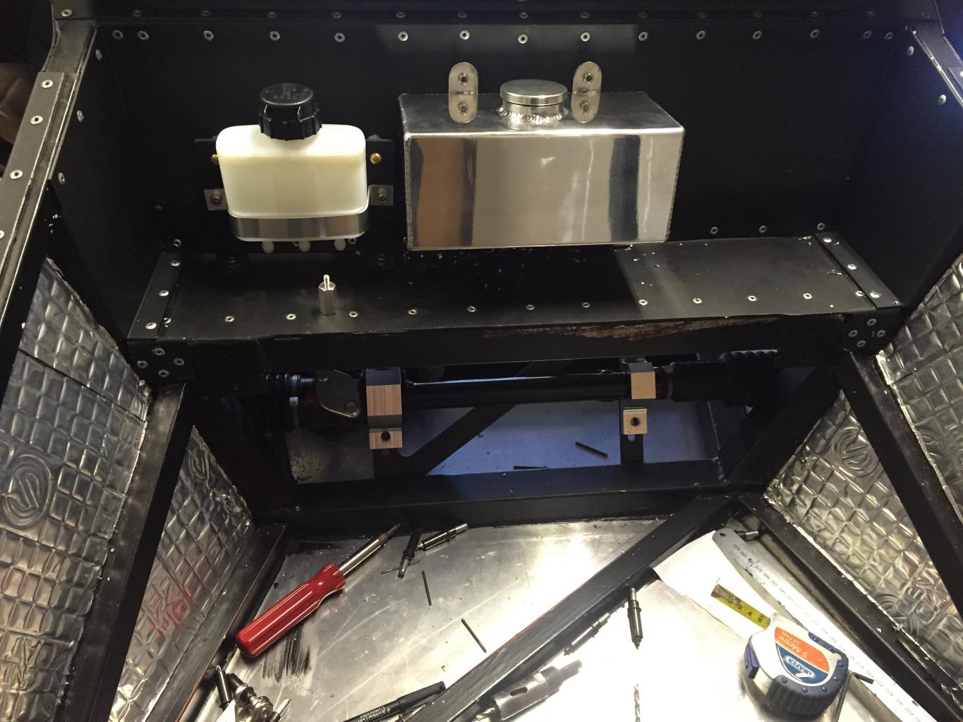

Anyway, I got a few hours this weekend to complete a few simple jobs, also ordered some blingy bits - nothing like a bit of retail therapy to bring a smile.

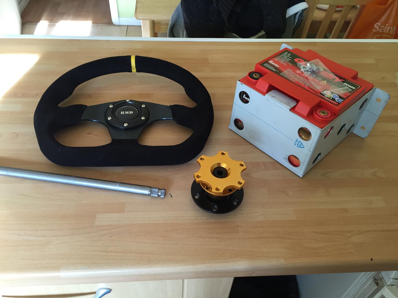

Concentrated of tidying up the front end a bit by mounting the Clutch and Dual Brake Reservoir, added my shiny wash bottle and test fitted the steering rack.
With the addition of some additional parts such as Battery, Bracket, Quick Release mechanism and Steering Wheel I've plenty to occupy me when the next opportunity arises or I need to grab a beer and go somewhere quiet ;-)
Nick.

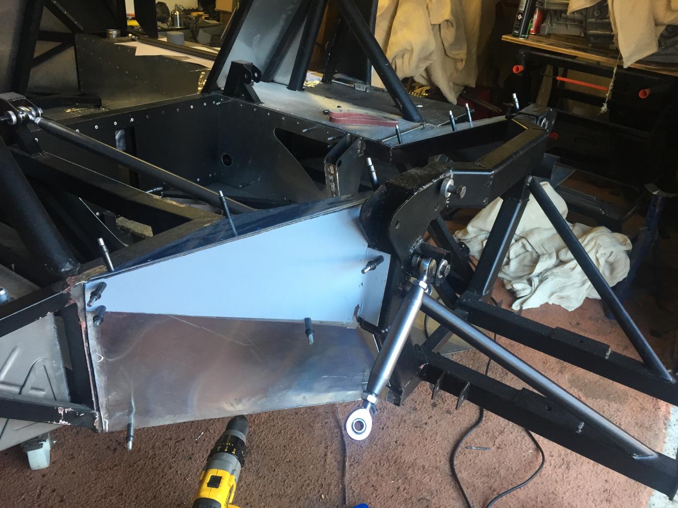

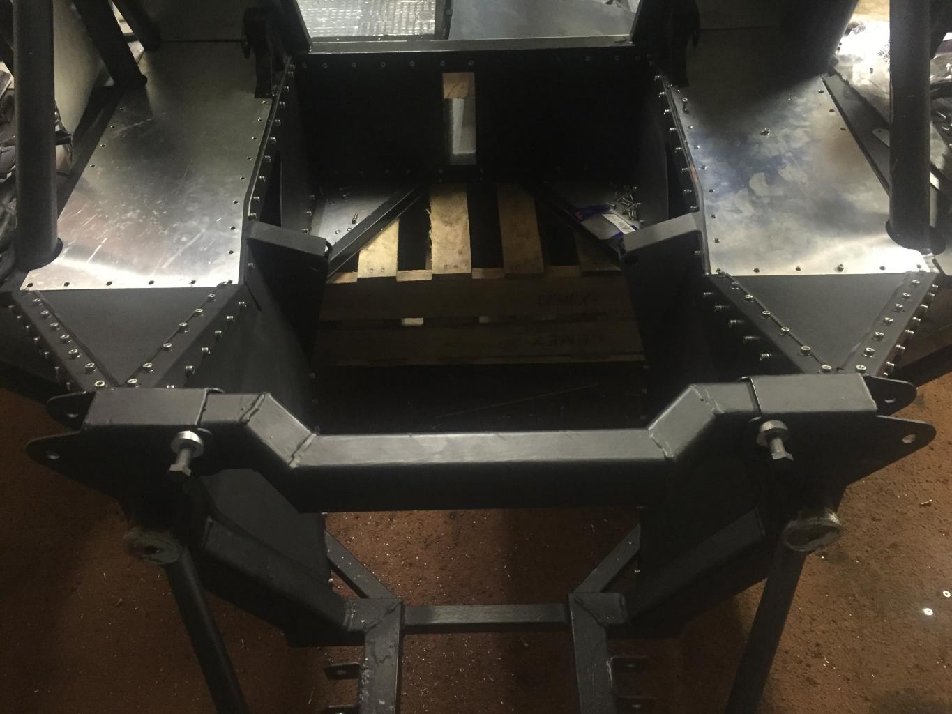

Managed to get a final 3 hours of work in Today between visit to the parents and a late Sunday afternoon beer.
Andrew (Rockhoppers on this Forum) and I have modified the back end of our GT- Forte's, not for performance but the look.
Have Today completed the Near Side rear and should with the benefit of my new template, complete the offside by the end of the week.
If I can complete the paneling by mid November, it will finally put to rest one of of the most pains taking jobs (and a job I massively underestimated) to rest.
Finally, I really do feel like progress is being made and I can see the fruits of the hours of Labour and just sitting with a beer now and again thinking things through, the times with beer in hand just sitting and staring seems unproductive at the time but it helps prevents the real howling mistakes. :thumbsup:

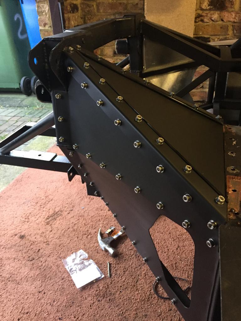

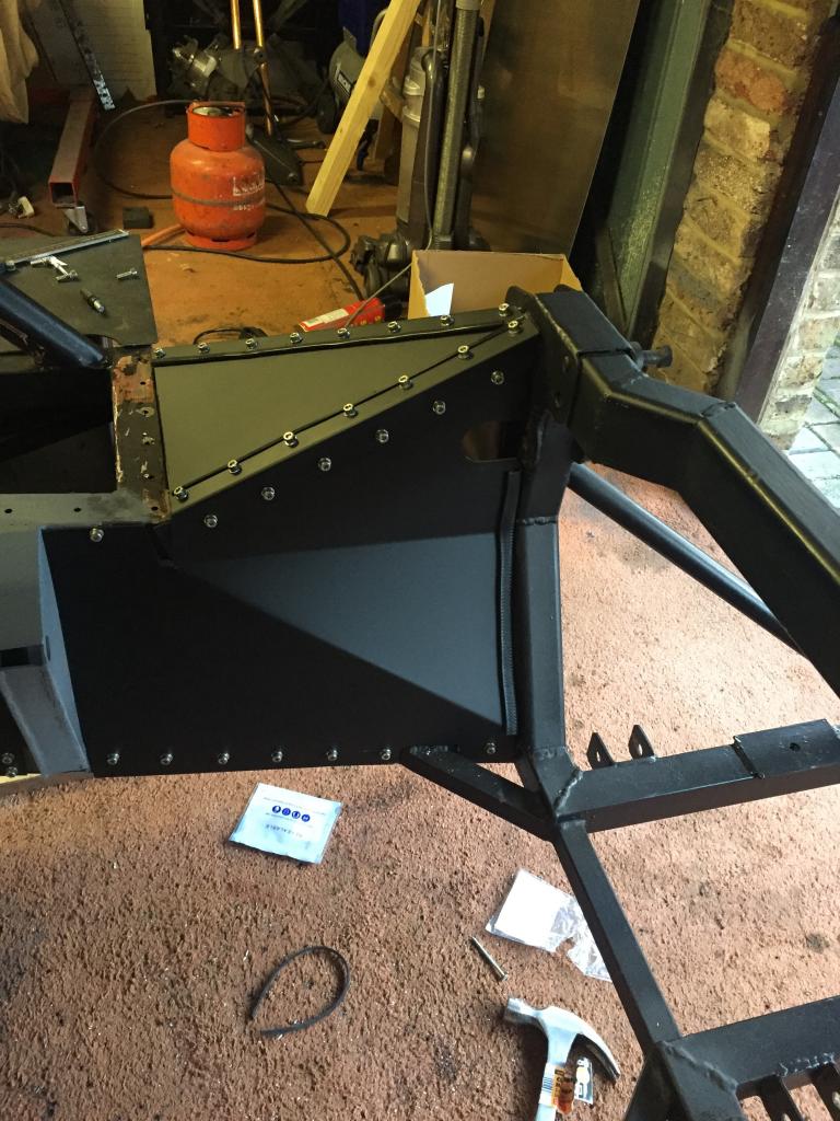

NickD

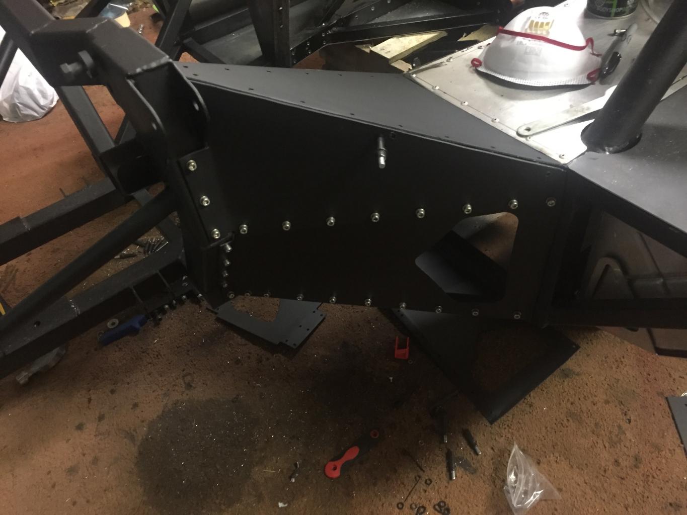

What with all the family medical probs at the moment, Managed to get a couple of hours this weekend to further the rear paneling, its the only brain downtime I can get at the moment when I can really chill. I've gone for a heavy very Black and Matt stonechip paint that covers really well and has almost no reflective sheen.
Decided to RivNut all the rearward panels as I'm sure they will get chipped from time to time so this will ease the task of re-painting or powder coating at a later time.
I've gone M5 but will probably change from the cap head to a smaller style as these are a little too proud of the panels for my taste.
The contrast of Matt with the Stainless looks better than I had hoped and also masks the panel scratches I had on the bare ally panels.
Should have all the rear panels completed by the weekend.

Nick,
looking good and keep up the good work. Please though, may I offer a word of caution regarding the use of Rivnuts in "exposed to the elements "panelling. With the amounts of spray and water that this area could be exposed to, please make sure, that as you are using stainless bolts to hold the panels in place, that you really apply LOTS of anti seize grease to the threads of the Rnuts and bolts. As sure as "eggs is eggs" you will have problems long term with rust/thread galling and loosening/spinning Rnuts. Do also make sure that you always use the knurled type Rnuts.

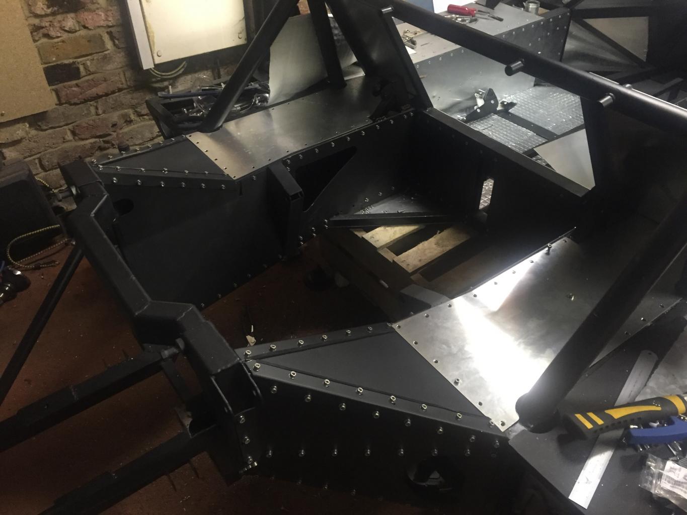

NickD
Have spent a a good few hours experimenting with paneling at the rear of my Forte. Having decided to flute the rear as opposed to the original Forte design, have had to add the additional steel and decide on the paneling style and how best to finish it so its pleasing on the eye if ever the rear clam-shell is raised.
Probably going to revert to a simple stainless M5 as opposed to the proud Socket Head, I'm pleased with the result. The Stainless on Matt Black gives a very nice contrast and geometry to the panels.
Should have the entire engine bay and rear panels completed by Sunday given a fair wind.

NickD
Progression of the ND40
Spent quite a few hours Today putting some of the final touches to the rear end and engine bay paneling. Will swap allot of the proud M5 socket heads to a lower profile as we move forward but I'm pleased with the look and fit in general.
The front end was paneled months ago but family probs slowed this section down so a big sigh of relief that another major hurdle is almost put to bed.
Most of the next stage's of build, I already have in box's just waiting for my time so less strain on the wallet, especially this time of year.
