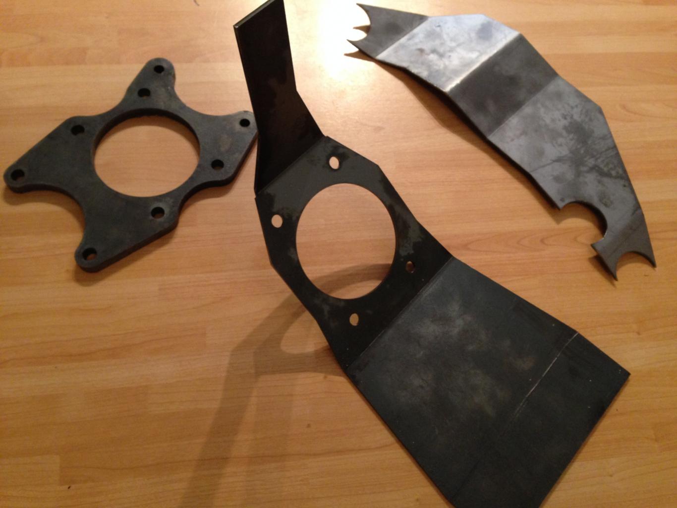

I've a good week lined up with lots of panelling and when I get bored of that or fancy a break, going to be building the rear uprights.
Going to be trying out the Flat-Pack I received Today.
Well impressed with the quality of the Pre-Cut and Pre-Folded parts. Lets see how they turn out.

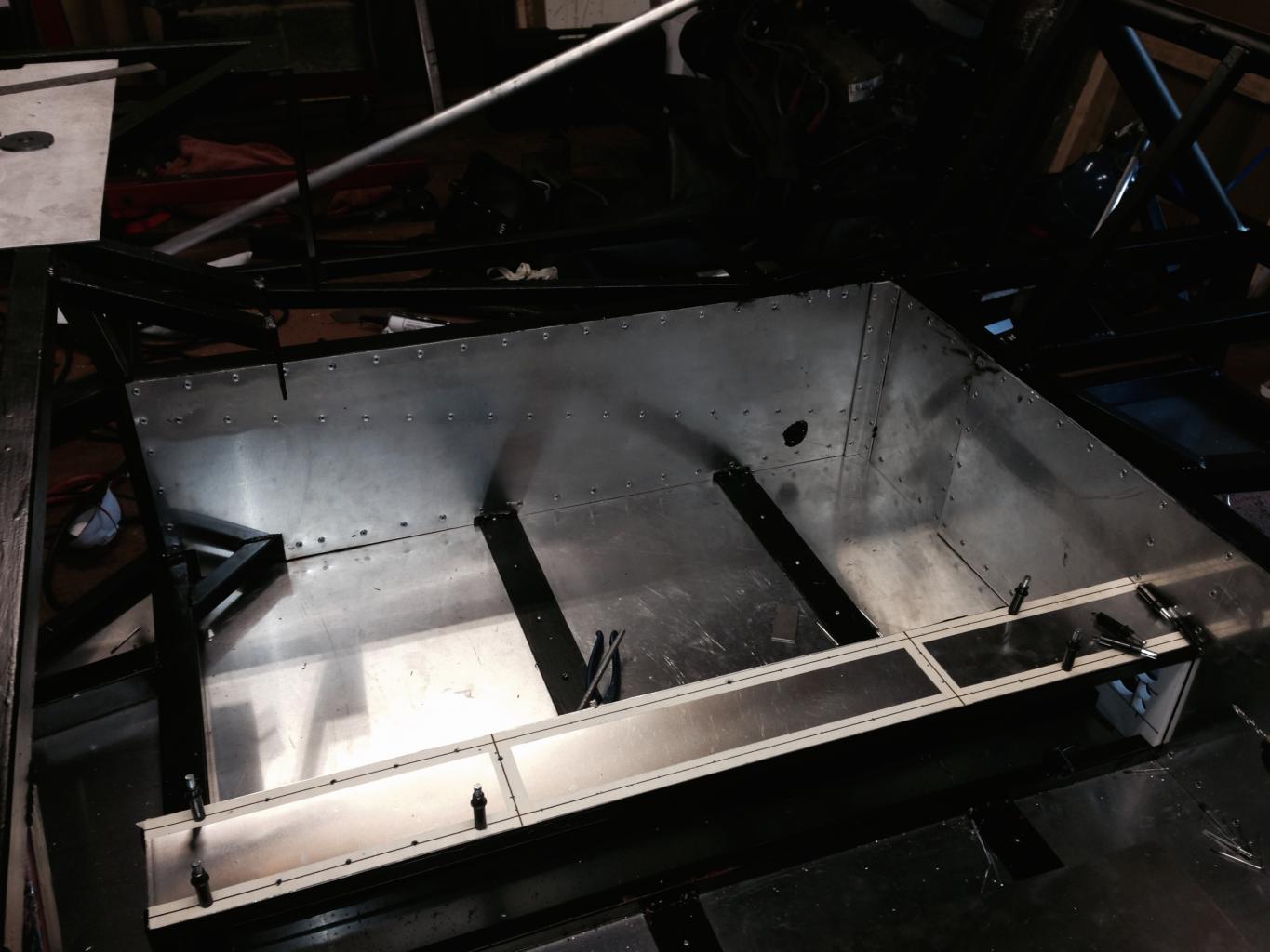

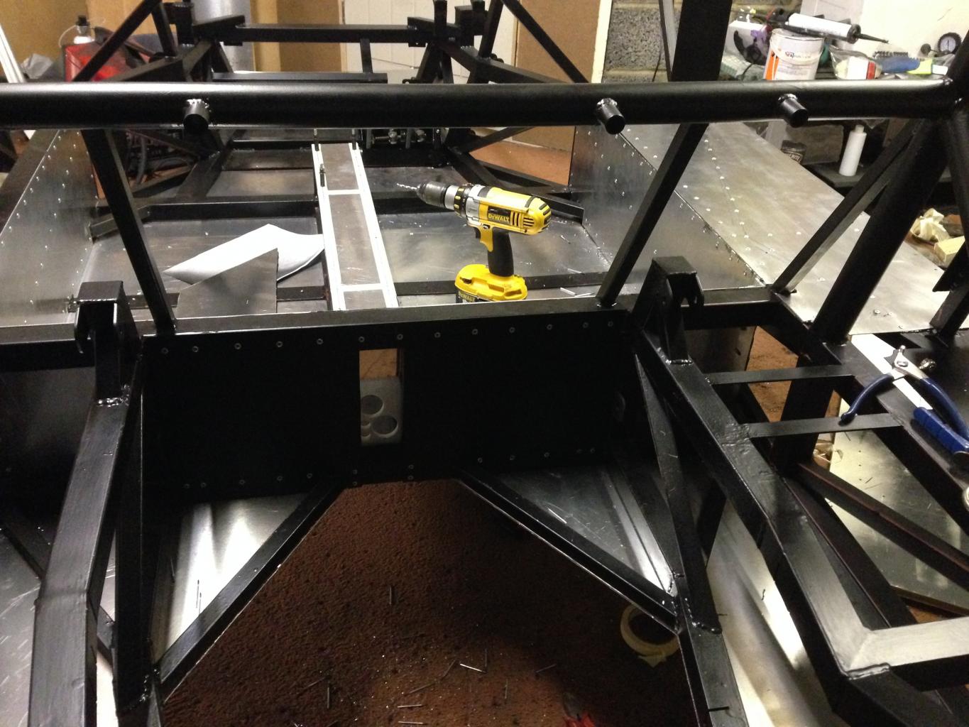

The DeWalt battery drill and the Pneumatic Riveter really earned their stripes this evening. Fitted the drivers side "Right hand" cockpit panel in place.
I've decided to keep all the car panel to chassis riveting at 50mm spacing (like the floor panels), not necessary but aesthetically it looks great, panels sound so solid also.
The corner section where the panels butt joint has a solid 4mm 90 degree ally angle backed with sealant to ensure no water leaks.
Passenger side Tomorrow I hope, if the aches and pains in the arms and back subside ;-(

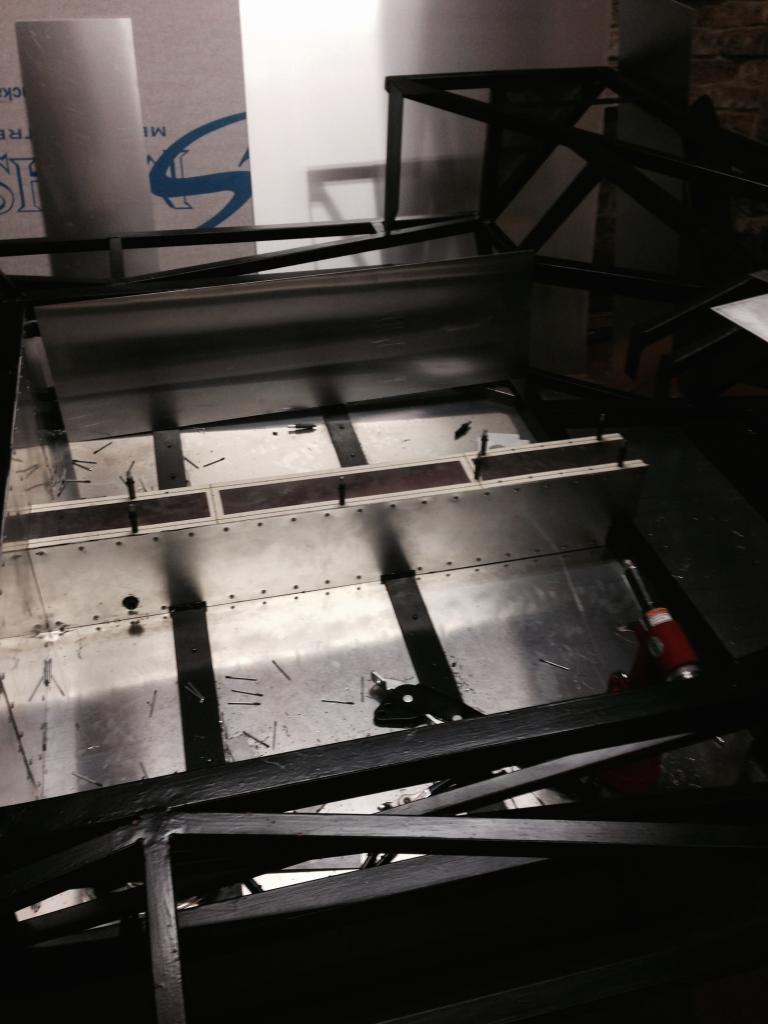

Passenger side now done and a Can of well earned beer in hand. Its slowly starting to take that magical form we all love so much.
Have joined forces with a few other UK based GT-Forte builders who are more or less at the same phase give or take a few months, nice to have chaps to sound out and critique both ways.
Got the passenger compartment panelling in early evening, she is starting to feel very, very solid - not like the old Lotus's I used to have, one sneeze and something would fall off !

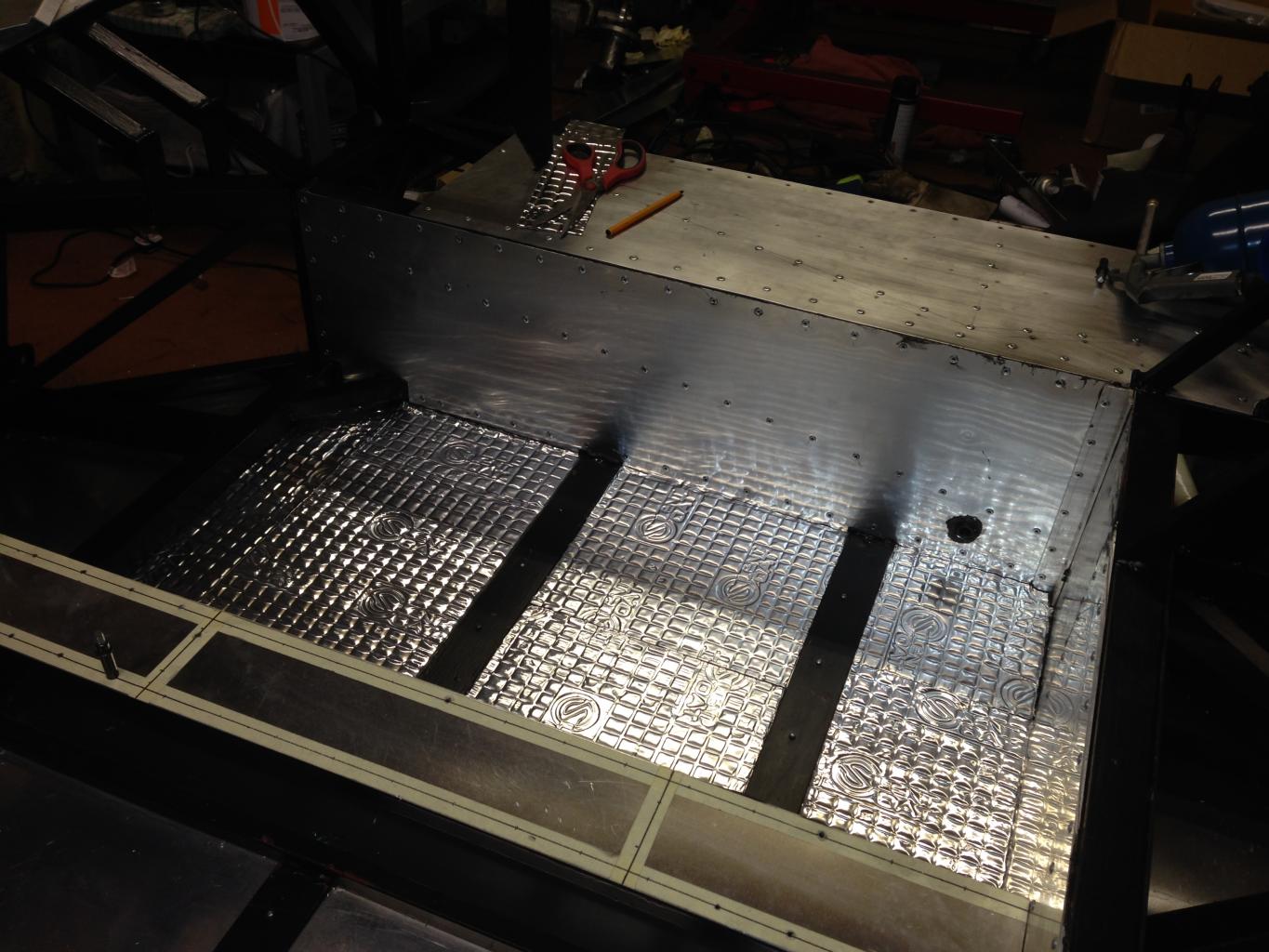

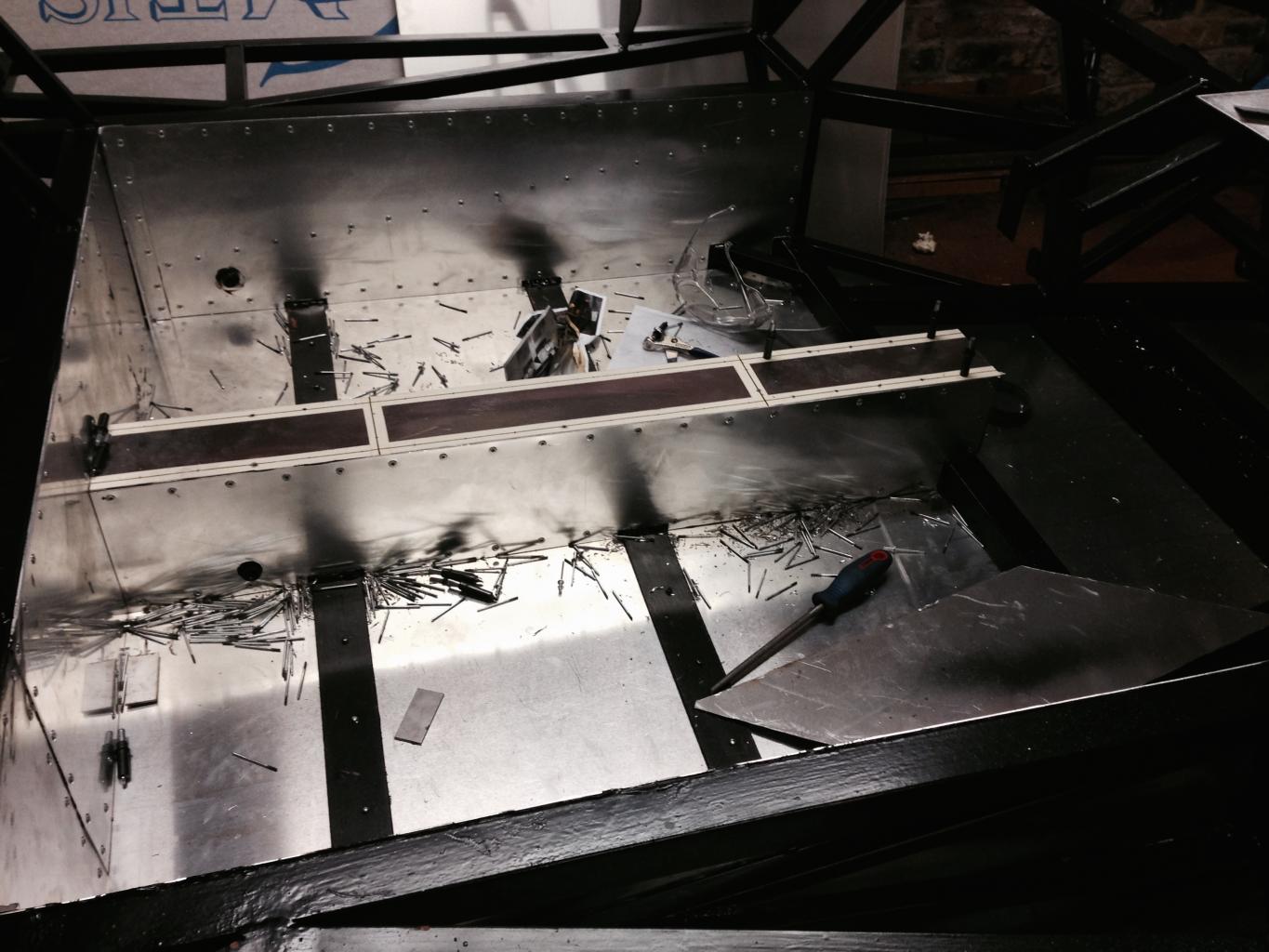

Taking a short break from cutting and forming panels etc. and fancied a change of tack. Got hold of some Silent Coat sound/vibration reduction material so am getting the floor pan fitted with that to start with. Will do most areas inside the cabin as the panels go in.
Looks and feels good and sticks down a treat. Easy to cut and form also.
It'll be back to the heavier work at the weekend but feel like I'm making suitable progress and still enjoying every bit.

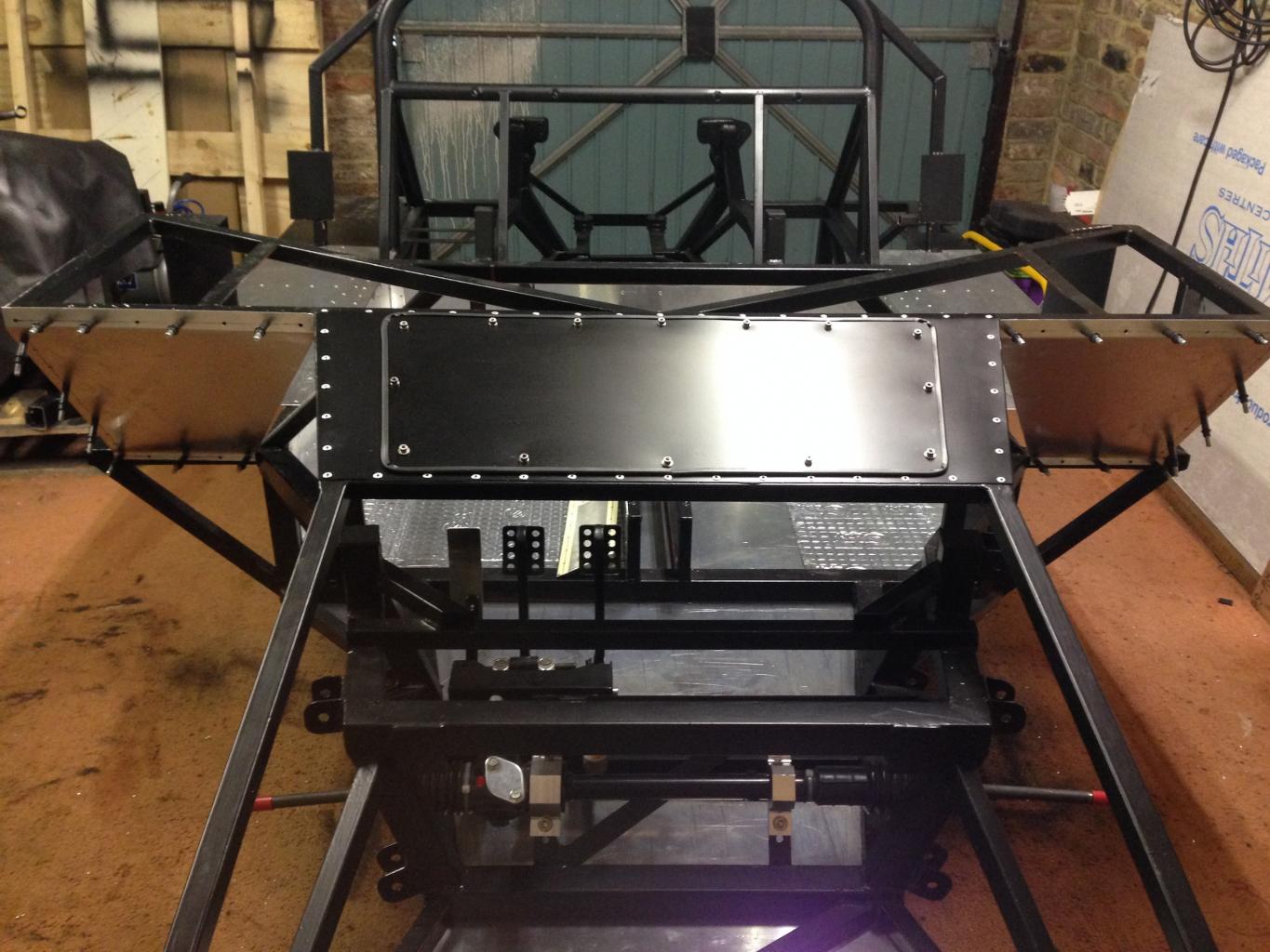

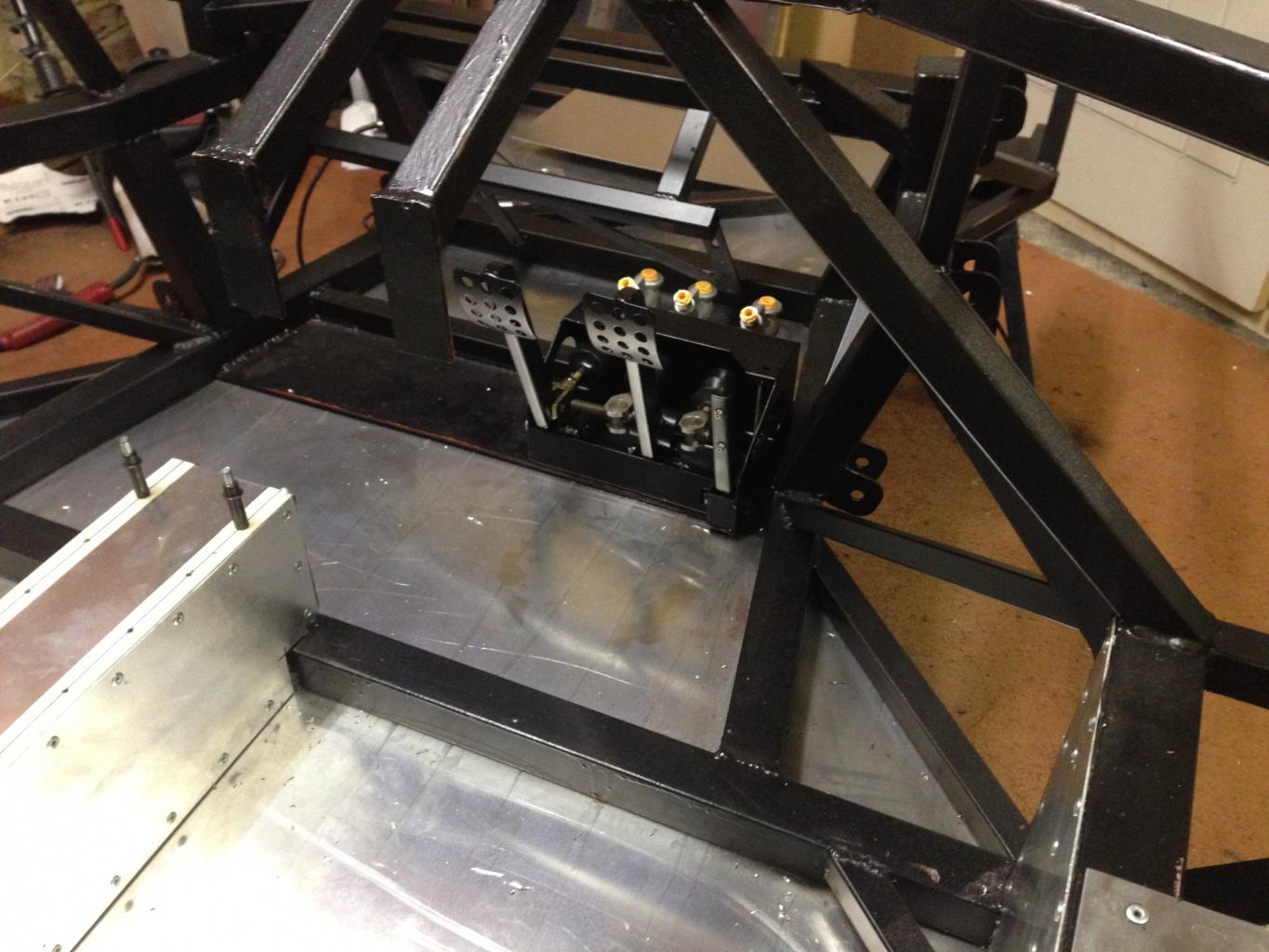

Finally made a few steps forward. Pedal Box now in place along with the Handbrake Lever and the Steering Rack. Making slow progress on the front panelling - the one regret to date being I didn't buy this pre-cut to make life so much easier.
Petrol tanks currently being fabricated and should be available in a week so plenty of work to keep the evenings and weekend busy for a while yet.

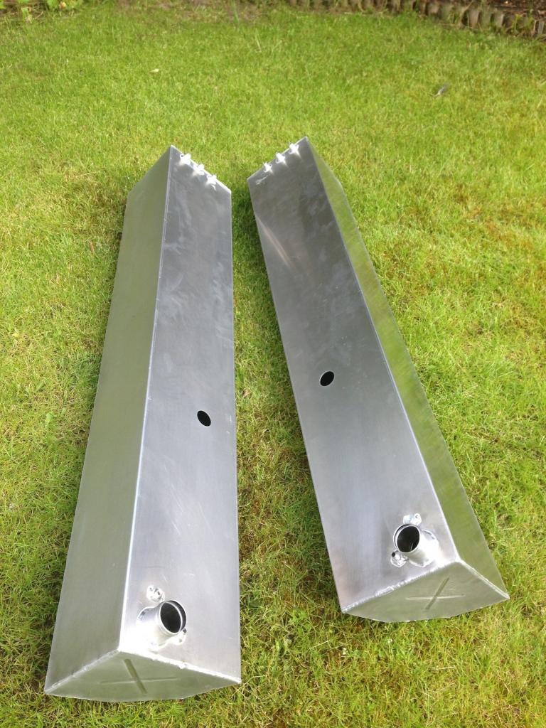

Friday afternoons don't get much better than this. Arrived home to see the twin tanks custom made for a small group of us have arrived from the fabricator and look absolutely super.
That will be another milestone to tick off.
What with the rear uprights to weld up and some more front end panelling, thats the next fortnights spare time allocated.

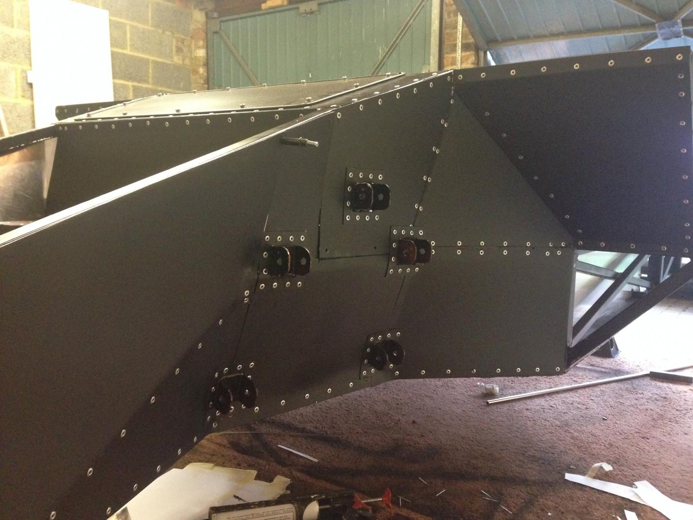

Just another 1 hours work and I will have the near side front wheel arch fully panelled and sealed. Offside scheduled for Saturday. The one regret I have to date being I didn't go for the Panel Set - decided to do it all myself.
I think in all I have probably spent more on Material this way than buying the bulk of it pre cut. Its satisfying this way but so time consuming.
I decided to spray all the outward surfaces with a stone chip resistant finish once I had the fit I wanted - seems a nice contrast with the rivets.
NickD
Nice work Nick. Where's the hole for the steering rack arm to come through ??
Andy
I have the Steering Rack mounts inside so have used them to align and mark the inside of the panels. My cutter will be doing its job at the weekend. As I have made all the panels myself and I wasn't 100% on the positioning, I've put the panels in place so they are firmly held when I cut the metal. Same goes for the front ARB.
