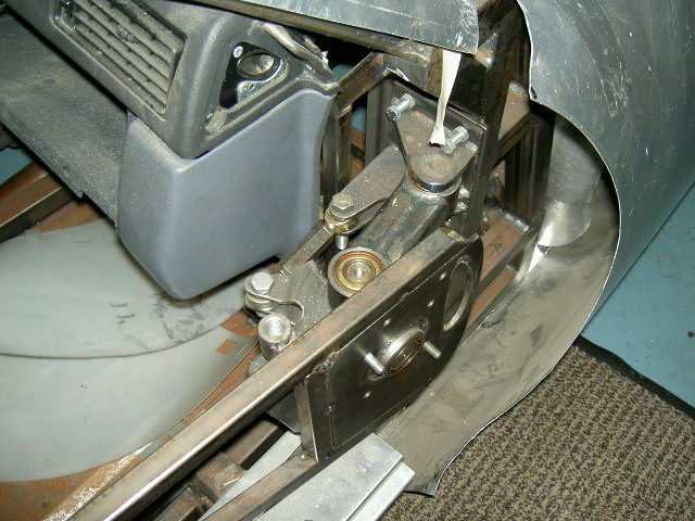

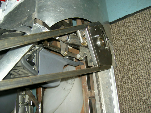

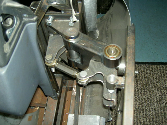

Hope you enjoyed some techical ideas from the world of engineering! The Koenigsegg dorrhinge has possibilitys to adjust the gears as an ring and pinjon to eliminate backlash or perhaps some other word. You have to excuse bad english but it is better than swedish.
Best reg!
Goran
Goran

Hersh! The Solon dorr hinge would fit a 40 and I have all drawings and fixtures to build them so if you are interested that can be arrenged laiter on. The koenigsegg is much more complexed because the door starts moving upward soon as the door opens and it is extreamly important that the "ring and pinjon" is set with minimum backslash so the door closes in the latch when someone fast close the door. I must say that the doorhinge really works well and if you look at a Koenigsegg´s dorr and body when it is opening and closes the shape is corvatured to allow this. I also have the drawings and tooling to build them and if there is intrest we can produce some but it is a lot of work building them correct so they will be expensive.

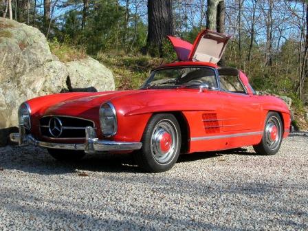

Here is yet another idea. The photo is of a Mercedes 300SL roadster with a custom "gull wing" hardtop. Instead of the doors opening gull-wing fashion as in the coupe, the hardtop has been fiddled to flip open to afford easier access to the cockpit.

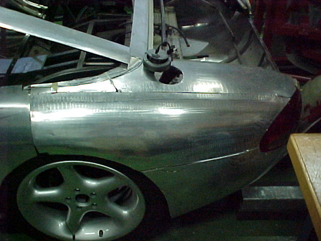

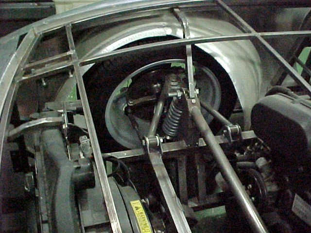

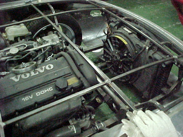

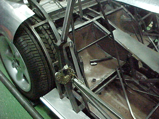

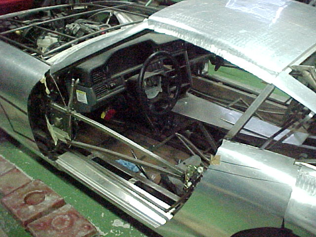

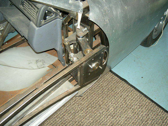

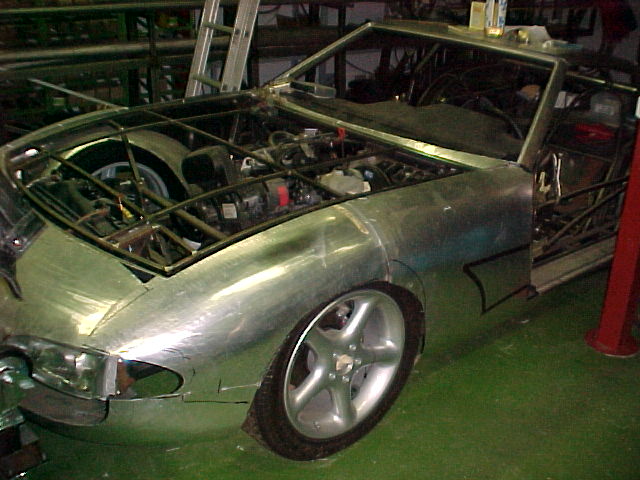

Rich and all others! The carproject is an owndesign that I will finish after the monocoque project is finished. The project has a 2 liter ital-turbo B204 GT/ FT that is boosted up 4 cylinder multilink rear axel and a M46 turbo gearbox with overdrive from Volvo except my own front spindels and A arms. The idea with this projects where to build a concept from scratch and it is rolling chassie. I post some pic of the project and I´m sorry to put it here since it has nothing to do with GT 40 but it is an interesting line. The body is just rough shaped and not finished at all. I have made the body with my Eckold and the english wheel and other machines. I have also built other aluminium bodies before ( Countach) but that we have to take someother time.
Best reg!
Goran
