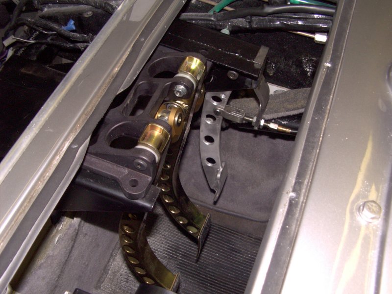

I have just got home after a day at Wealden Engineering spent getting the clutch pedal of a set of top-hung Tiltons in my GTD right for me.
Here is a pic of the installation immediately before we set-to with the hacksaw and welding torch. The final result doesn't look much like this, but fits me very well!

Tony,
Could you send me more pics of your setup as this is exactly what I plan to install as soon as the car returns from the painters. I realize your under dash is different, but it will give me the general layout. Any dimensions would be appreciated. Thanks
