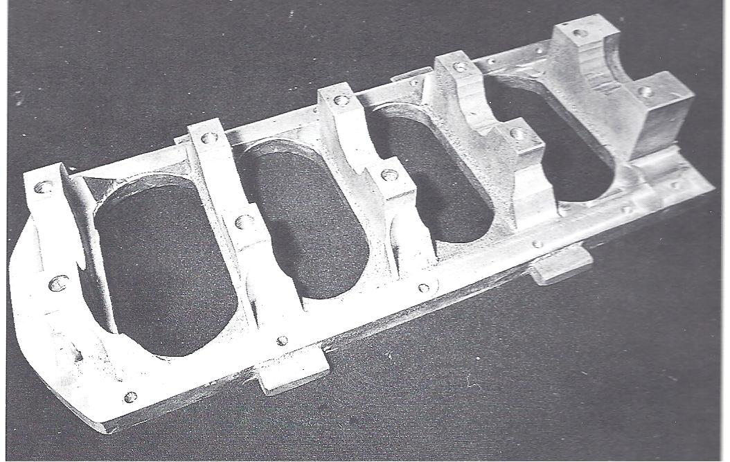

The problem is the blocks and the bottom end. The two bolt blocks suffer from cap walk even with ARP studs. The four bolt blocks are prone to pulling the rear main out of the block even at standard power levels! As for the rotating assy....?
Have a look at what Repco had to do to the blocks and they still wouldn’t hang together over 400hp.
“For the 1968 season, the Repco engine was fitted with new four-valve, dual overhead camshaft heads. This made the engine roughly as powerful as the Cosworth DFV, but proved to be too much for the stock block, which broke on many occasions.” Quoted from Rover V8 - The Wedge Shop
In 1968 the DFV was producing 410hp…..
In 66 and 67 with 380 hp they were reliable and won both the drivers and manufacturers F1 championships both years. An extra 30 hp obviously broke the camels back....
Some experts will say there is very little to choose in block strength from the 215 Buick through to the latest 4.6s but tend to plump for the SD1 block as being marginally the best.
Maybe thats why Wildcats make blocks as well .....
Back in the early 80's Janspeed (remember them?) built up a twin turbo TR8 for LeMans. It produced something like 500bhp but the only way to improve reliability and prevent block flexing was to introduce a crankshaft cradle (or block girdle as it was called). After considerable development work, they finally got some level of reliability and actually managed over 200 mph down Mulsanne straight but still failed to qualify due to long list of non-engine related problems. JE Engineering version of cradle shown
