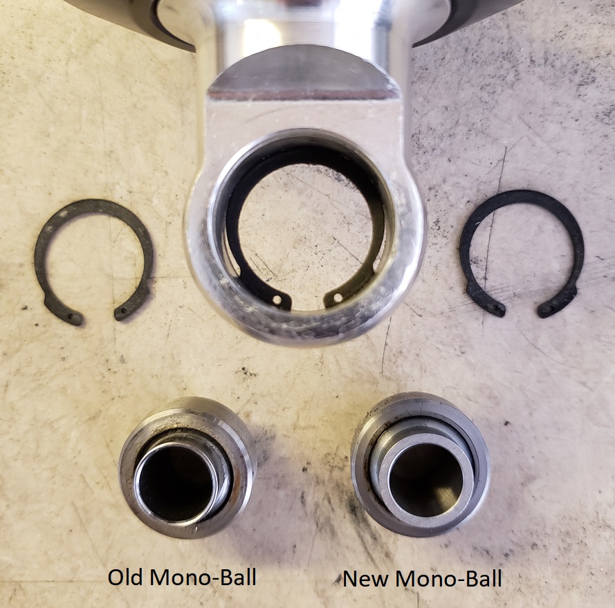

I had one pesky rattle in the right rear suspension that I've been chasing for a year. I completely tore that suspension apart for the third time yesterday and finally found the problem. Both mono-balls in the shock were loose.
Fortunately, I live near Mooresville (Race City USA) and there are numerious shops within 10 miles of me who specialize in racing shocks. I went to RE Suspensions and they had the replacement mono-ball units for $30 each. The Mono-balls are held in the shock with a ring clip, so they pop out easily.
If you need one of these shock mono-balls, Go to RESuspension.com and order part # RE-MO-8T-45. Tell them Bill Phillips sent you :laugh:
In the photo below, you can see the new replacement mono-ball is much more beefy.

FYI - summit carries the mono-ball replacement manufactured by QA1; PN COM8T-102PK. They're currently $25/pair (1 pair per shock required).
QA1 Shock Bearing Kits COM8T-102PK - Free Shipping on Orders Over $99 at Summit Racing
Bill - I think yours is the first confirmed case of a steel bearing to have gone south in these shocks, maybe others have been replacing these preventatively. My front shocks were delivered with teflon bearings and my rears were already upgraded to the steel.
In the pic below the mono-ball on the left is steel and the one on the right is teflon.
There's a short discussion of this subject on my blog at this link, scroll all the way to the bottom:
11. Suspended suspension – Cam's Superlite SLC
