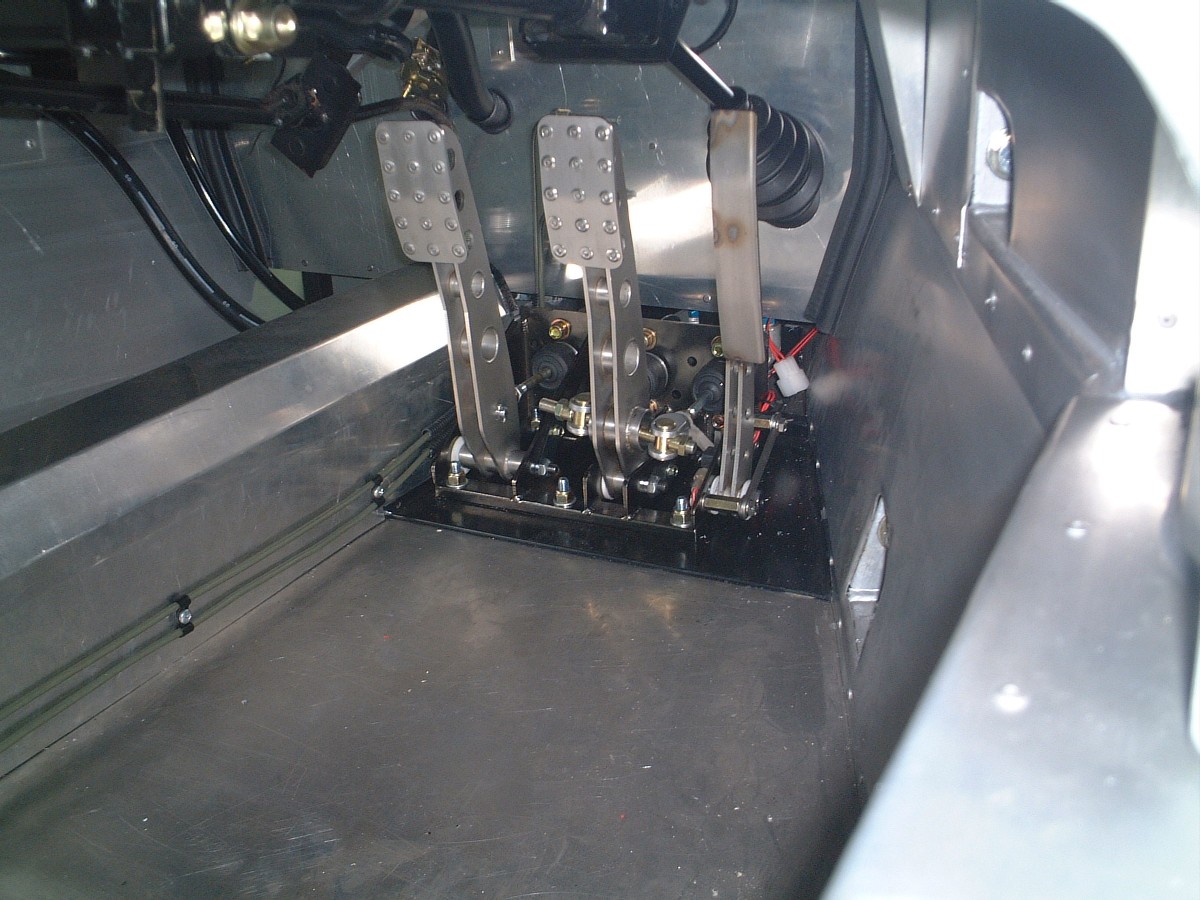

Jim, 5:1 seems pretty small ratio for manual brakes. How bad is the pedal throw like that?

If anything they are a tad long I found getting anf more than 5:1 was impractical, as you are finding getting more ratio into the design and space is difficult.
The throw is good the pedal moves down about 50mm and has a nice feel.
When I had a 3/4 rear cyl it felt like I had a brick under the pedal.
I have size 11 feet to match the size of my nose and hands but when my wife drives it I have a false floor that sits in front of the pedals to bring her feet up to the pads.
At the track not many can outbrake me, to be honest I stay off the back of other cars as I have got into trouble by getting under the rear bars.
I have made a few sets with about 4:1 and 2 sets at 3.8:1 due to space, I never got feed back but I think they would need to run small cyl bores to overcome large pedal pressure.
I have had a few race cars over the years and the worst thing is high pedal pressure required to slow the car, over time it just wears you down and It gives a lack of confidence.+
As we all know caliper piston size plays into this I have twin 41 mm pistons on each front caliper and twin 38 on each rear caliper if people like running numbers, I just changed cylinders till I got what felt right as I have a few in stock.
Always use tilton short bore masters because if one fails it will bottom out earlier and allow the other curcuit to work before you run out of pedal travel.
I appoligize if this is getting off the subject or hijacking
Attached a pic
Jim
