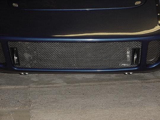

What started out as an induction air filter project has now
become a complete aperture screening project. Once I
got started, I couldn't stop!
Total cost: $50
1. 2'x3' 1/4" mesh stainless screen-$40
(exact amount to do a GT40, with no room for error)
2. 16' of 1/8" vacuum hose-free(already had it in garage)
3. 1 tube of black weatherstrip adhesive-$5
4. 1 pack of Dremel cut off wheels-$5
5. 3 pieces of stiff aluminum welding rod-free (screen stiffener)
Total cost-$50
I half-split the vacuum hose in a razor blade jig, and used
it as a gasket for the screens. I wired the welding rods to
the radiator screen to stiffen it up. The tow hook holes
will be trimmed with the same rubber hose. The photos show
everything dry fit. Gluing will take place tonight or tomorrow.

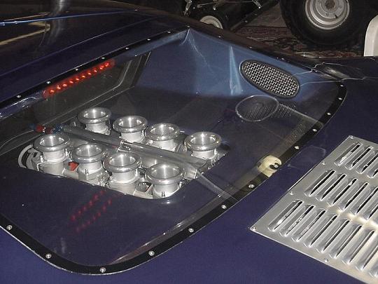

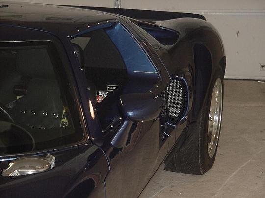

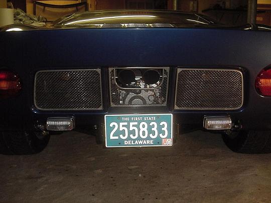

Bill, VERY NICE. The ones on the top of the rear bonet are going to be copied ASAP!!! Thanks for sharing the detail. /ubbthreads/images/graemlins/wink.gif
Freddy F,
No problemo! I found a LARGE grain of sand on my manifold, at which point I made the decision to add induction hole filters and a turkey pan. /ubbthreads/images/graemlins/shocked.gif
The stainless mesh came from Racer Parts Wholesale. Make sure that they check it before shipping, as my first piece looked like it had been immersed in salt water!
I cut my filters from 3 layers of 3/4" thick A/C filter
media(dyed black)that I bought at Carquest.($12 for 2'x3')
Oops! Forgot about the filters. That makes the total $62

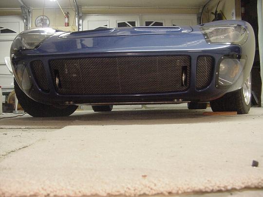

#5 shows the tow hook holes trimmed in rubber.
