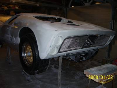

The car will be off to the propper painters next week, so I have made the rear grille surround. The rest of the car is stripped back ready for final prep priming etc
There is a mount for the rear fog light for SVA in the center, it may need the pipes lifting to get the correct viewing angles. The surround still needs final polish but will look OK against the grille that will be black powder coated.

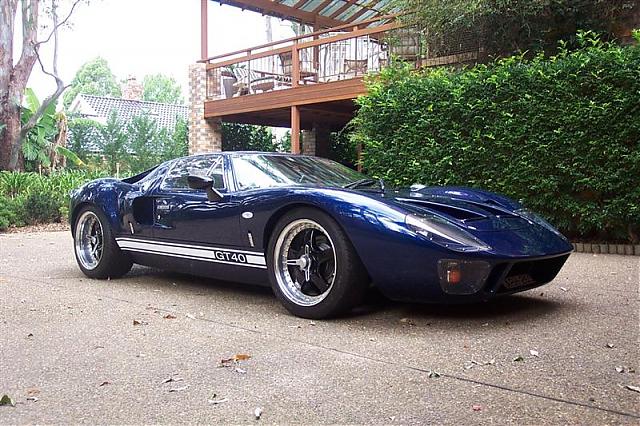

Re the blue colour - you might like to check out Honda's "Marine Blue" from the late 90's Preludes.
I looked for the "right" blue for over 6 months, & eventually had it presented to me by way of a mate turning up unexpectedly in his Honda Prelude - as soon as I saw it, I knew it was the one ! I grabbed his log-book & got the paint code (then said hello) !!
I had been looking for something like the "Royal Blue" that you could get in writing inks years ago (yes, when I started school, we used nibs & inkwells, then graduated to fountain pens - yikes) !!
The Honda Marine Blue seemed to have just the right ingredients for me - not too dark, no grey or purple in it, & had a very fine metal flake effect - just enough for some subtle "bling" in the sunshine, but not an over-metallic finish like you see on some hot-rods.
Hope this helps.

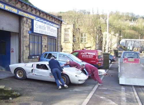

No turning back now. It's blue with white stripes. I will be V pleased to see the difference when it next passes this doorway, then put it all back together again.
Steve

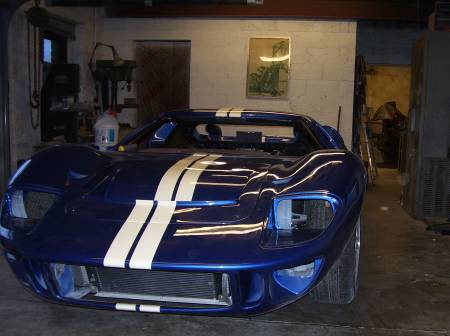

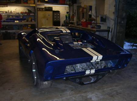

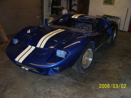

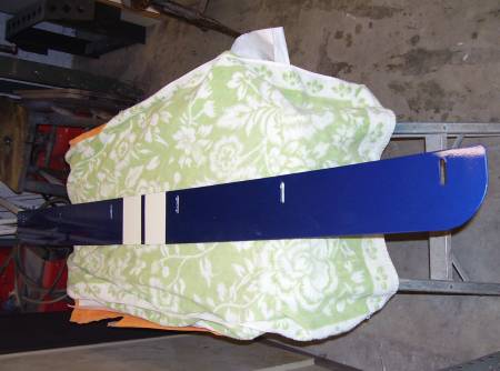

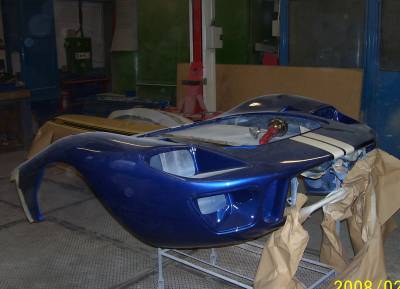

More progress, the paint is almost finished apart from some minor corrections and final buffing. I am well pleased with the colour chioce now I've seen it on the car.
I look forward to the final assembly work now.
Steve

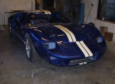

Despite a fall of snow this morning I was able to collect the car from the paintshop. Here are a few pictures back in the garage.
Can't get the grin off my face!
Steve

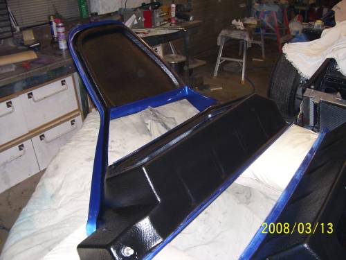

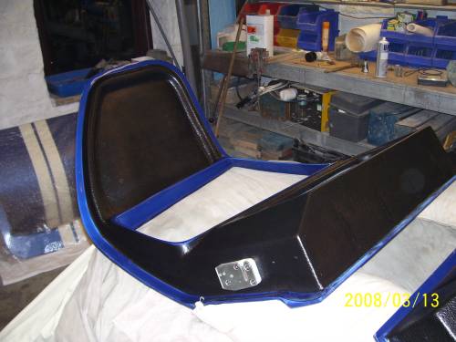

Its a real boost to have the car together, however it was soon in lots of bits to start refitting the parts striped of for the paint job.
I made a mistake by painting the doors to the body colour inside.
The 'textured interior is now sprayed with U-pol satin black... much better.
Steve

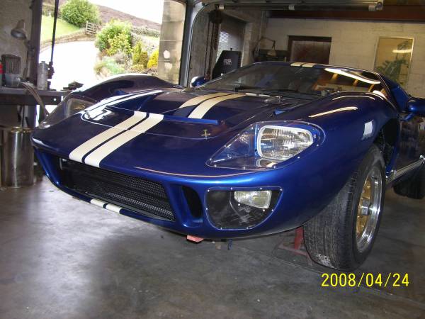

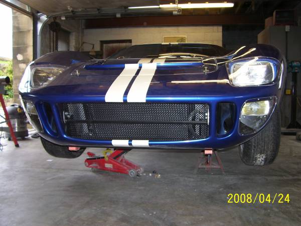

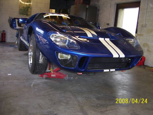

The build up continues after painting. I need to sort out suitable indicator lights for the SVA next, the jacking brackets wil also go on after the test. The mirrors look OK and have electric adjustment and demister
Here are a few sots of recent progress that show the humped front arches and the grille mesh.
Steve
