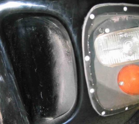

I intend to blank out the lower light cover leaving the Marchal under it and fit the indicator lamp onto the blanking plate as high as it will go, I think that will comply with the 350mm mi height.
I have fitted the side light into the headlight units, strangely there appears to be no minimum height for front side/position lights only a max of 1500mm so we need not worry about that one. However you need to see 50% of the apparent lamp surface from an inward angle of 45 degrees ; in the lower pocket this may be an issue.

Thanks, for SVA I have a set of lights from Vehicle Wiring Products that will provide front indicator and sidelights which can be mounted in front of headlight. After that 65 Mustang indicator will be fitted below the Marchal driving light.
VWP also came up with a set of rear lights that can be used instead of the 61 Corvair rear lights and fit well in the same recess diameter. I intend to have fitted so that they can be easily changed if required for any reason in the future.

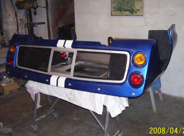

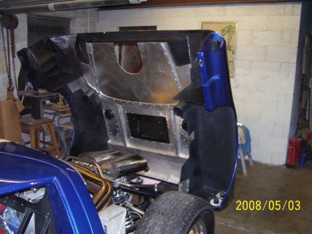

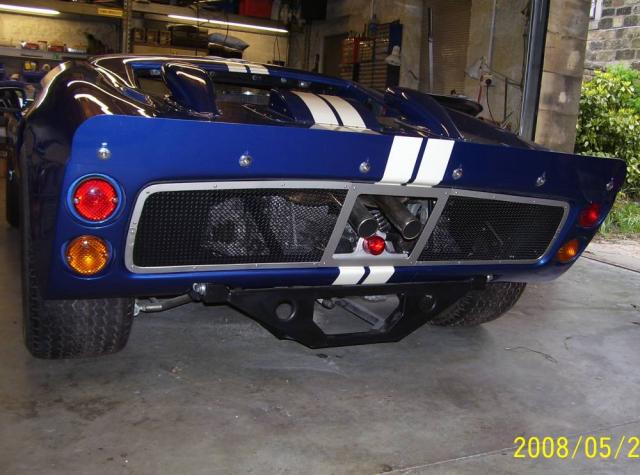

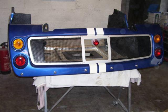

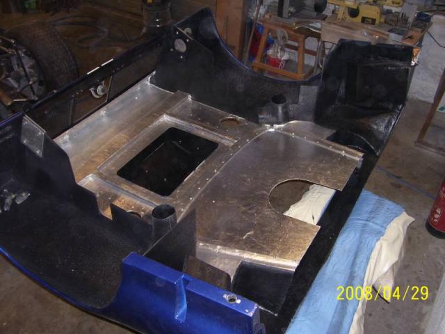

There has been progress on fitting out the rear clip with the temporary SVA rear lights, the heat protection for the underside and the final position for the snorkel ducting that will be linked with flex duct.
Here are a few shots. Wire them up next
Steve
That is looking REALLY good!! I love the MkII rear lights and grilles.
What thermal protection are you using on the inside of the rear clip? And what adhesive are you using to install it?
Thanks, and keep the pics coming.
Thanks for the feedback.
The stuff I used under the clip is a glassfibre woven fabric with a bonded aluminised facing. It is supplied by an industrial consumables supplier, the catalogue page is attached. It is available in two weights. I thought it was inexpensive compared to motorsport branded offers
The glue is a 3M product 'Scotch-grip' 1300L, I've used it before on a TVR Griffith that had an insulation panel that detached when things got hot. It stayed in place afer using this stuff . Like most 3M it is expensive but it works!
If you would like an off-cut sample email me your address
Steve

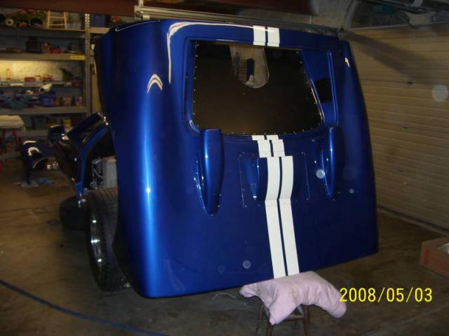

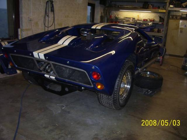

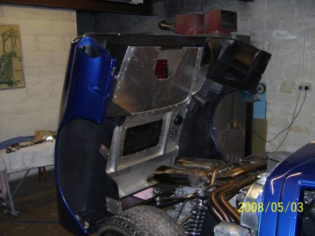

The rear clip gets heavier as it is built up, and now its painted I can't single handed lift it into place.
Fortunately I had a little help from friends. Martin Mike and Alan came over from Lancashire for a visit, they assisted, thanks guys!
Here are a few shots of it in place
Steve

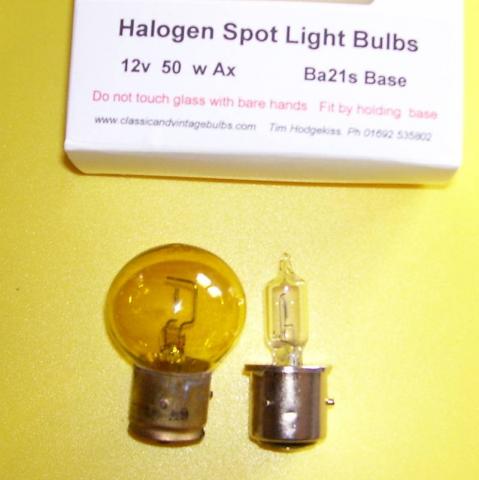

I have been looking for an upgrade in the performance of the Marchal driving lamps. I had yellow bulbs, clear would be better. however I have found some 50w Halogen bulbs with the three pin base suitable for these lamps.
They are available from Page Title UK phone 01692 535802.
Steve

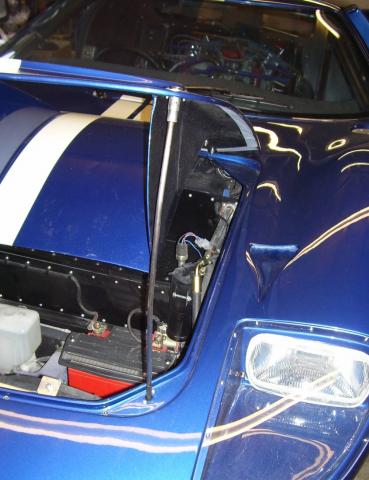

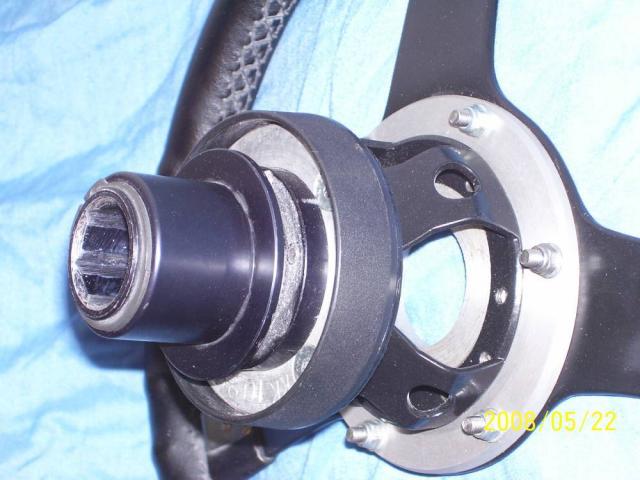

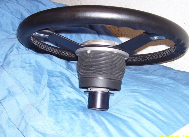

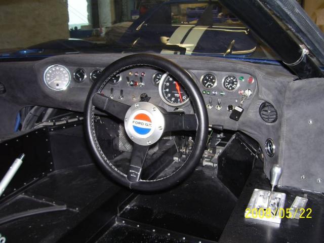

It's time to sort out some SVA issues. I have fitted a removeable steering wheel, I believe this will need to be locked in place and require tools to remove it also a collapsable boss. I will also add the Mountney pad for the center of the steering wheel.
Here are some pics of the collapable hub I have grafted onto the removable boss, you can just see the locking bolt that locks down the relaese ring.
There is also a shot of the almost complete dash, I think everything that has flick switches are in the 'exemp' area.
I have made a front vent support for the hinged panel. I made up a plastic clip to snap onto the Dzus fitting at the botton and a socket at the top that the top Dzus locks into, it will stow in a couple of terryclips.

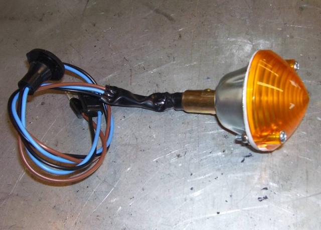

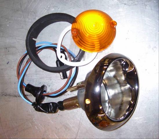

Anyway I have the front indicator lights from a 65 Mustang and have stripped off the chrome surround before and after photos attached.... anyone want the chrome bits?

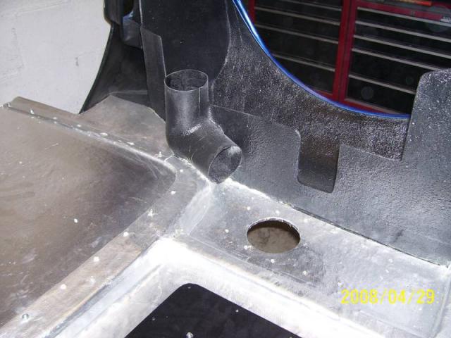

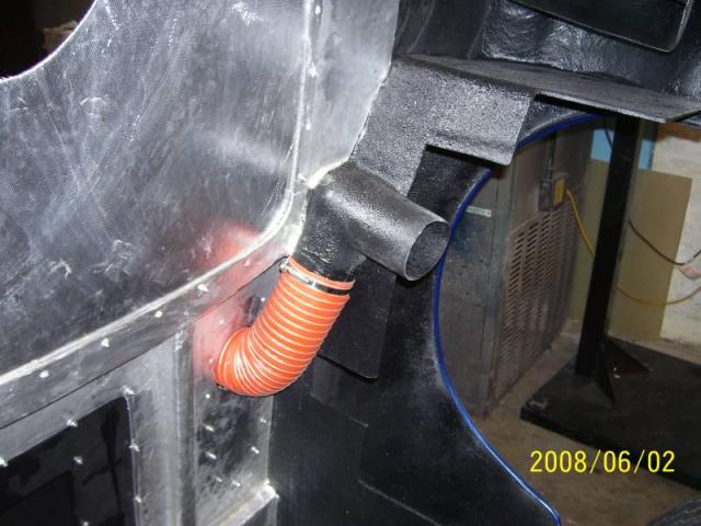

The rear brake ducts have the connecting high temp hose fitted
Steve
