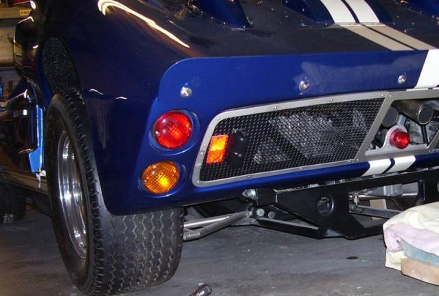

Thanks for the confirmation, it looks like a square rear plate can be mounted to the side in the rear grille. I am not certain the lights will pass as reflectors so I have fitted some 'e' marked items just in case.

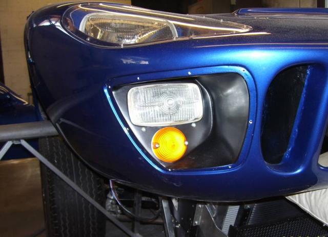

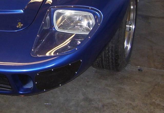

The Mustang indicators are in place temporary but will have to come off for the SVA probably also the driving lights. I have made up some blackout panels for the lower recesses. A small 'e' marked indicator can be fixed at the very top edge to gain the minimum height required

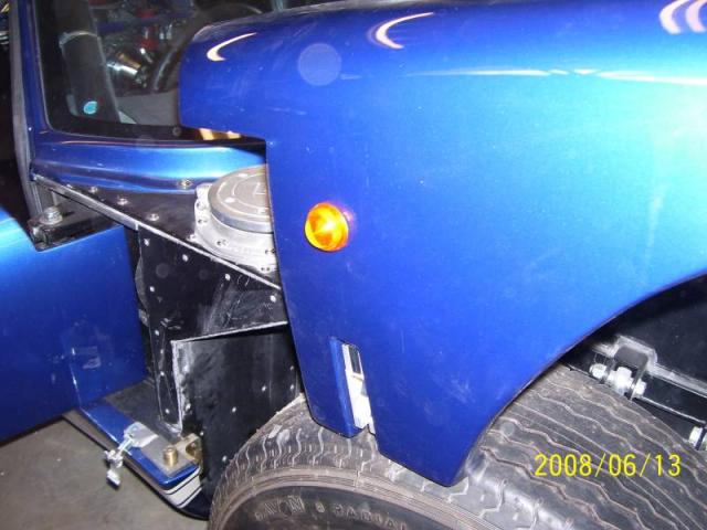

The side indicator repeater lights are now fitted after lots of thoughts on how not to have them, I gave up on fitting them in the outer edge of the door mirrors ( too modern) and drilled the nice paint!
Steve

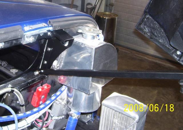

The rear clip spport is now in place with a couple of mounts for the security pins that I will fit after SVA. I have seen the pins as a central single one and also as a twin layout and opted for that.
For the SVA the rear clip needs to fix in the open position in a way that allows the rear lights/hazards to be visible from the rear (according to the manual).
The small final jobs seem endless!

Dave Collins
Dave
The way the clip is locked in the open position avoids the need for the warning sign and also the warning triangle or simmilar that would I believe have to be available / present in the car when tested.

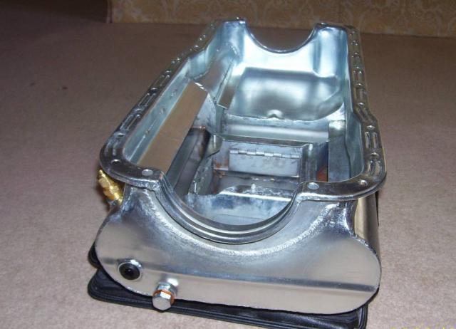

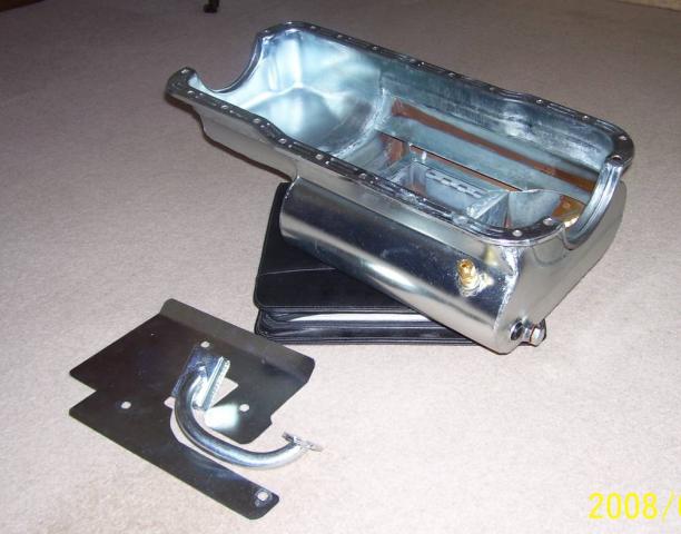

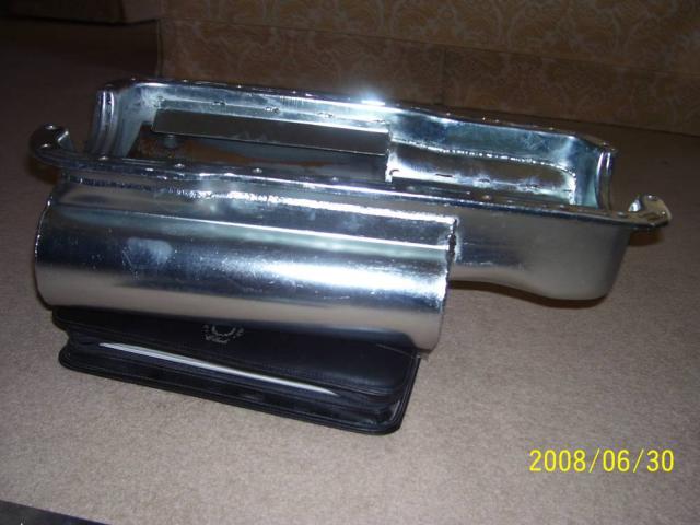

I now have the answer to the ground clearance under the engine. The engine is set very low due to the under diff engine centerline. This had resulted in the Canton sump protruding 35mm below the chassis.
The new low profile Armando oil pan arrived today, problem solved. The dipstick and the oil temp probe wil have to be moved but it looks an easy fitting job.
Steve

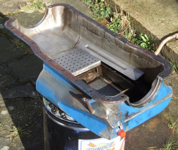

Mike Pass
That should do the trick. It also looks very similar to the original GT40 sump but a bit less battered! Pic attached.

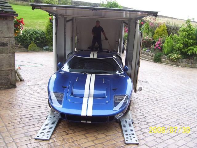

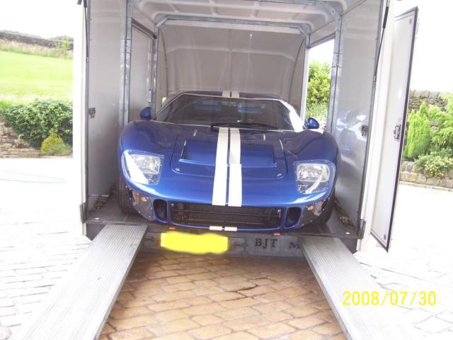

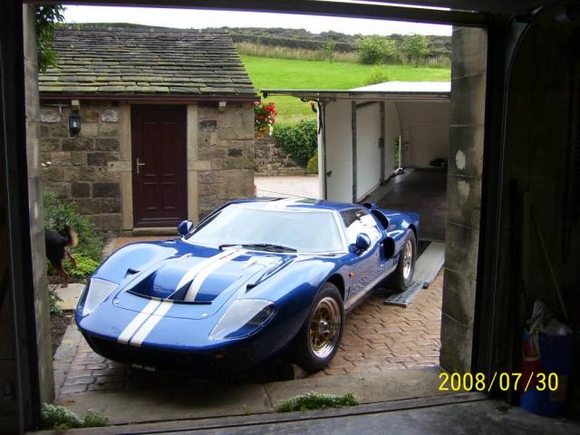

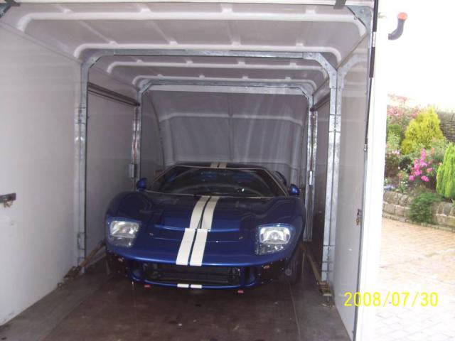

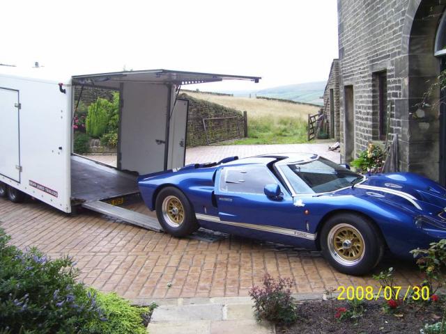

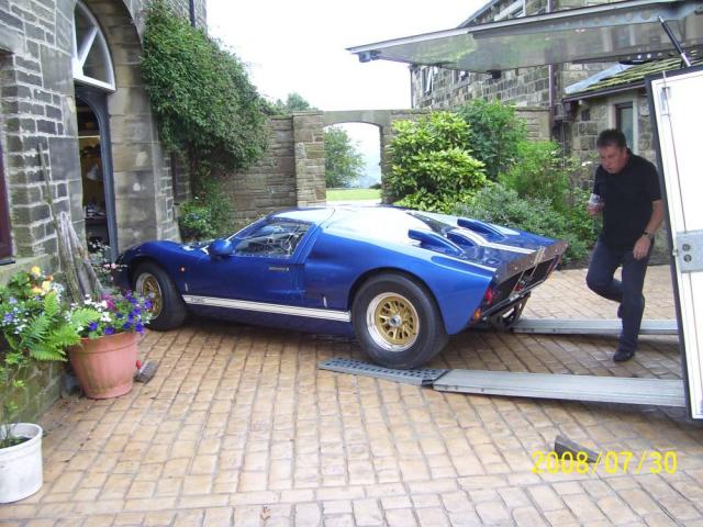

Here are some photos of the car loading into the trailer this morning.
The garage looks very empty!!
Steve

Sweet!!!
Looks like a rather tight fit in the trailer.. And that is a rather unique trailer as well... I've never seen a tilt bed enclosed trailer like that!
Thanks for the compliments.
The car went in nice and easy, the trailer has a very shallow angle, we just had to get the car lined up first, but with the side doors you can get out when the car is in place. The big lift up door provided protection from rain that came as we loaded. Nice bit of kit
I have attached some details of the trailer, it is about a large as you can go with our narrow local roads.
Steve

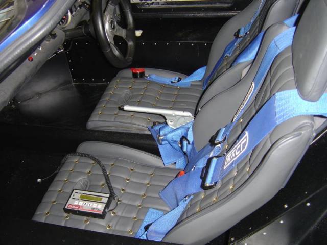

The seat bases have now been upholstered and installed, here is a picture of the seats installed.
Steve
