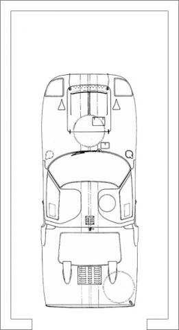

Also just to note that space isn't something my garage will have a lot once the chassis is in there and the dimensions are as follows:
Door width – 205cm
Garage Internal width – 281cm
Garage Length – 550cm
Do you think Ill be ok for space in there or should I be looking to rent a bigger garage/workshop?
I've also attached a scale image of my garage with a gt40 in.
Trev

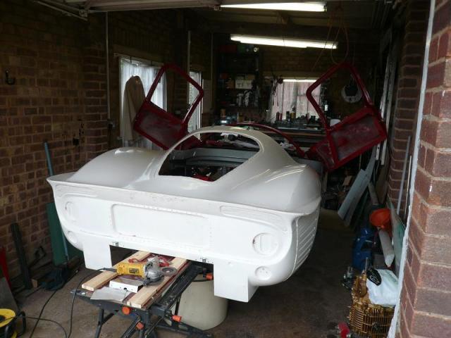

That's all that springs to mind initially. Here's a pic of my garage, similar in size to yours. At times it's seriously tight for space but workable.
