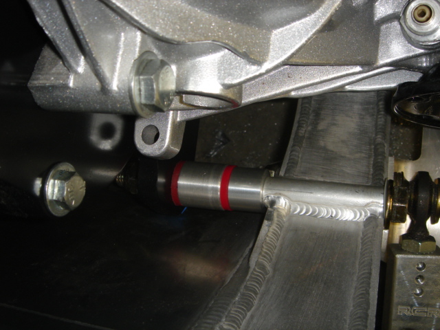

Tom,
I don't have a real good photo of the way I did mine, however, I made a bushing out of two urethane "control arm bushings' that I got at a local parts store. The body of the bushing was approximately one inch diameter and the flange was about 1/4 inch. I machined an aluminum tube to accept the two of the bushings making it intentionally short so they would be in compression when tightened. I machined another aluminum bushing to make the assembly the correct lenght to get the axle flanges in the correct position.
I used the urethane bushings to hopefully absorb some of the vibration in the x-axis.
As I have not been on the road yet I am not too sure how well it will work.
Keith

Hi Keith
This is a quick sketch of how i did mine.
THe main bushing is about 30mm in diameter( i opened up the hole in the plate to this dimension) and has a flange diameter of app 50 mm. it goes through the plate all the way and has an overdimension on the other side slightly shorte than the bushing ring to assure the compression. Both parts are made of delrin ( pretty hard material, if it is to hars h i will use PU) and are compressed by the support of two app 10 mm thick alu washers.
Keith
Tom,
That is a really good idea. you will get vibration dampening in all axis. If I ever pull my engine I will probably go back in with something like that.
