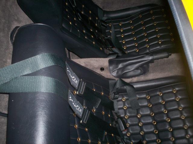

Installed my new reverse lock out today.
It works like a dream, 1 - 2 upshifts and agrresive 3 - 2 downshifts can be accomplished without fear :thumbsup:
The lock out release button is shown installed aft of the parking brake handle.
Cheers,
S

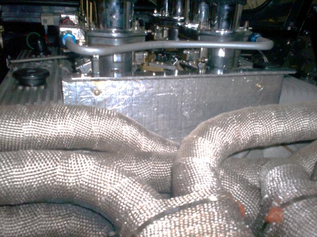

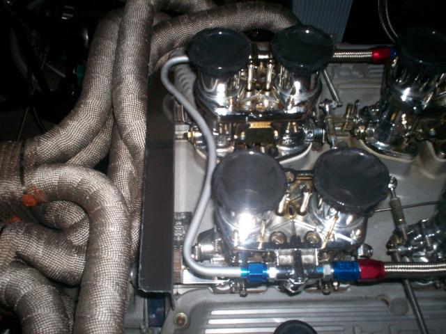

Fabbed a nice Weber heat shield today from some alloy and rear clip heat shield mat, leftover from the build. I also separated the shield from its mounting tabs with two small pieces of high temp phenolic, to minimize conductive heat transfer to the carb mounting flanges
Now out for a scream around Lost Acres road to see if it is effective!
S
Neal
Looking good Scott. Do you have phenolic spacers for each carb? I made a similar shield and it took care of percolation on hot days.
Hi Neal,
Thanks!
No, for carb gaskets I have the ceramic material ones.
The phenolic spacers I was speaking of are what the heat shield is mounted to. If you look closely at the pictures you can see two brown colored blocks just forward of the shield.
Phenolic spacers for the carbs would work well though, but I have not been able to locate any for the 44IDF.
I could fabricate some though!
Cheers,
S

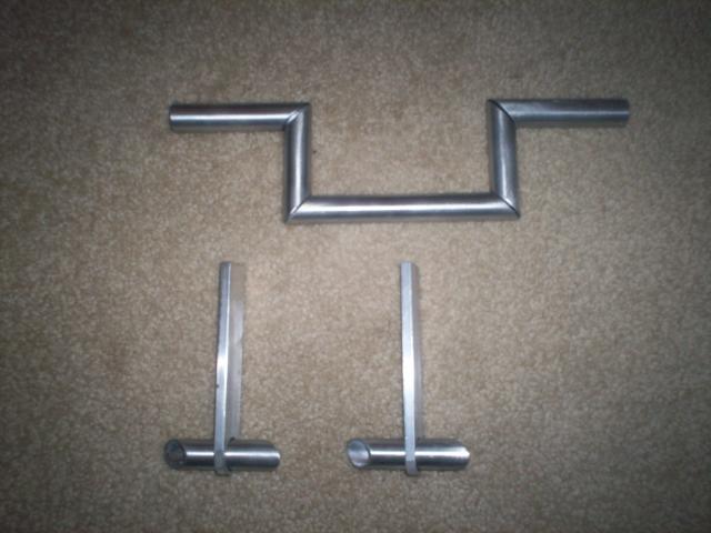

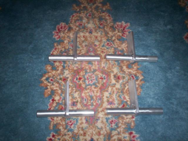

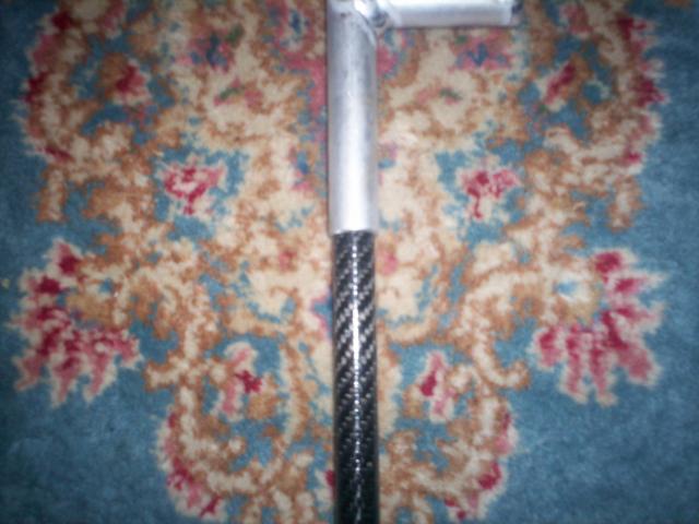

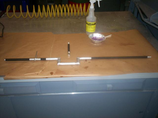

I finally got started on my long awaited C/F composite, rod type gear linkage for the TS40.
Preliminary data shows at least a 10 lb. weight savings.
The next step will be to TIG weld this assembly together, then use aircraft epoxy for bonding (EA9309) to the C/F fabric pipe.
Made a set for the boss today;)
CF pipe has arrived, waiting for the 9309 via UPS.
Should start the TIG work & bonding next week.
Anxious to actually get some finished weights, but as of now with the C/F tube weighing in @ .074 lbs per foot and the hardware aft of the u-joint @ 6 oz, it looks like the entire aft linkage rod assy. should easily come in under 1lb!

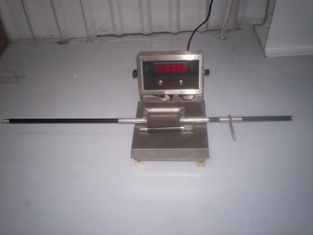

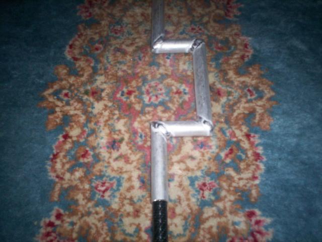

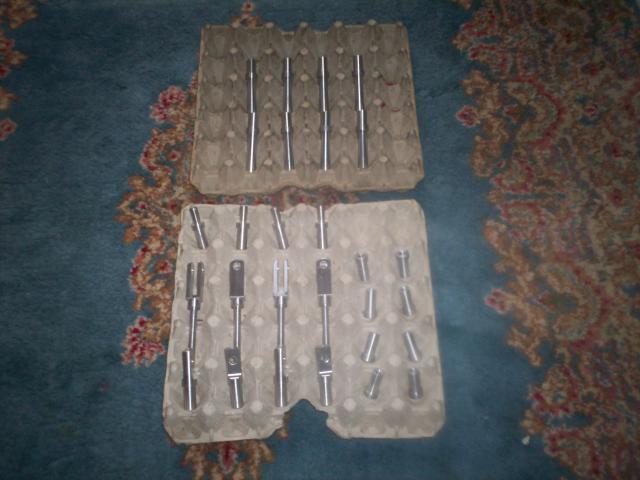

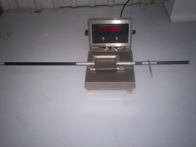

Rear half and shift lever completed.
Weights are shown in ounces and Kg.
Standard linkage weighs close to 15 lbs.
Will be available for Tornado customers soon.
Email for details.
S

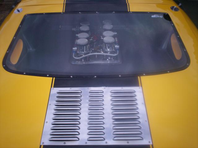

875 comes home after a long winter nap at the aircraft hangar.
Shown sporting her new Weber screens, thanks Eric, I owe you a weekend pass to an event at LRP of your choice.
She was topped with 18 gallons of 100 Av Gas in October and started the instant the starter pinion engaged the flywheel, 100 LL ROCKS!
Many New England twistys to enjoy soon.....
S
