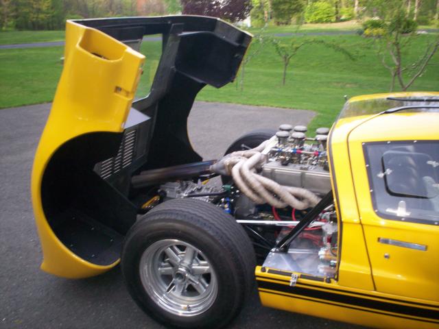

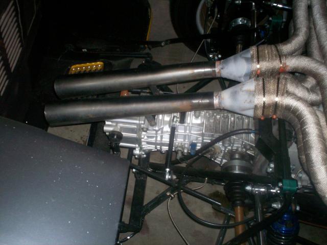

nicely done wraping of the headers and collectors. Plan to do the same on my car.
What width wrap did you use ( 1" or 2"). How many feed did you need ?
THanks
TOM
Tom,
Three 50 ft rolls of 2 inch wrap.
One 50 ft roll will do 4 (Tornado) primary pipes.
The third roll was to finish the collectors. I bought a 50 ft roll for that because that's all the speed shop had on the rack at the time. You could probably do a set with 125 feet.
Get it wet first and be prepared for lots of ceramic dust until they heat cycle several times.
I used Thermo Tec brand wrap and it definately lowers temps under the rear clip.

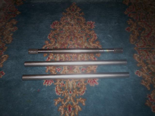

My 6AL4V Ti drive shaft blanks showed up today.
Off to the hob cutter tomorrow.

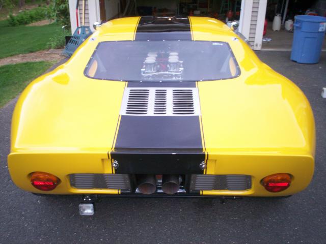

Went out today and went for a 45 minute ride in the twisties with the megaphones wide open...what a sound :shocked:.
Interestingly enough they are not that loud unless you put your foot deep into it.
My friends 498 ci BBC with 50 series Flowmasters and 2.5 inch pipes is actually louder around town.
When I pulled into the driveway and took these pics I noticed something strange.
I cant believe I forgot to put it back on, I must have a Guardian Angel looking out for me....

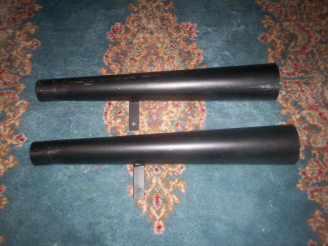

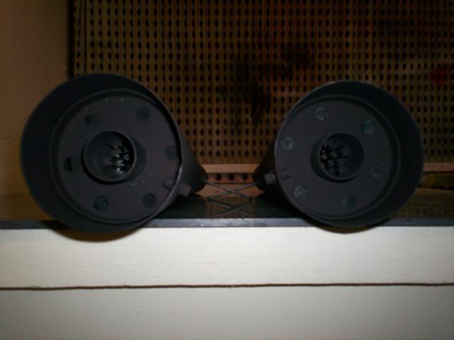

The slip in megaphone inserts will be done and available in a week or so.

Don't wory Scott, it's only the rear one. By the sound of it, I don't believe anyone would have come up behind you to read it. ;) :pepper:
Scott, Forgive my laziness but did you state where you purchased the megaphone inserts from and their cost? I too am thinking of going the same route with mine. BTW you and I must be having the same dream. My car is painted identical to yours even down to the the black stripes. Mine is a CAV car with a 347 and 44IDF's. It goes without saying I love your car.

Thanks Scott. There's some very nice gear on that list. Many things took my fancy. Didn't see the inserts for the pipes. I'm very interested in the mega pipes and inserts. What will I be looking at?

Pricing for the Megaphones is to be confirmed.
